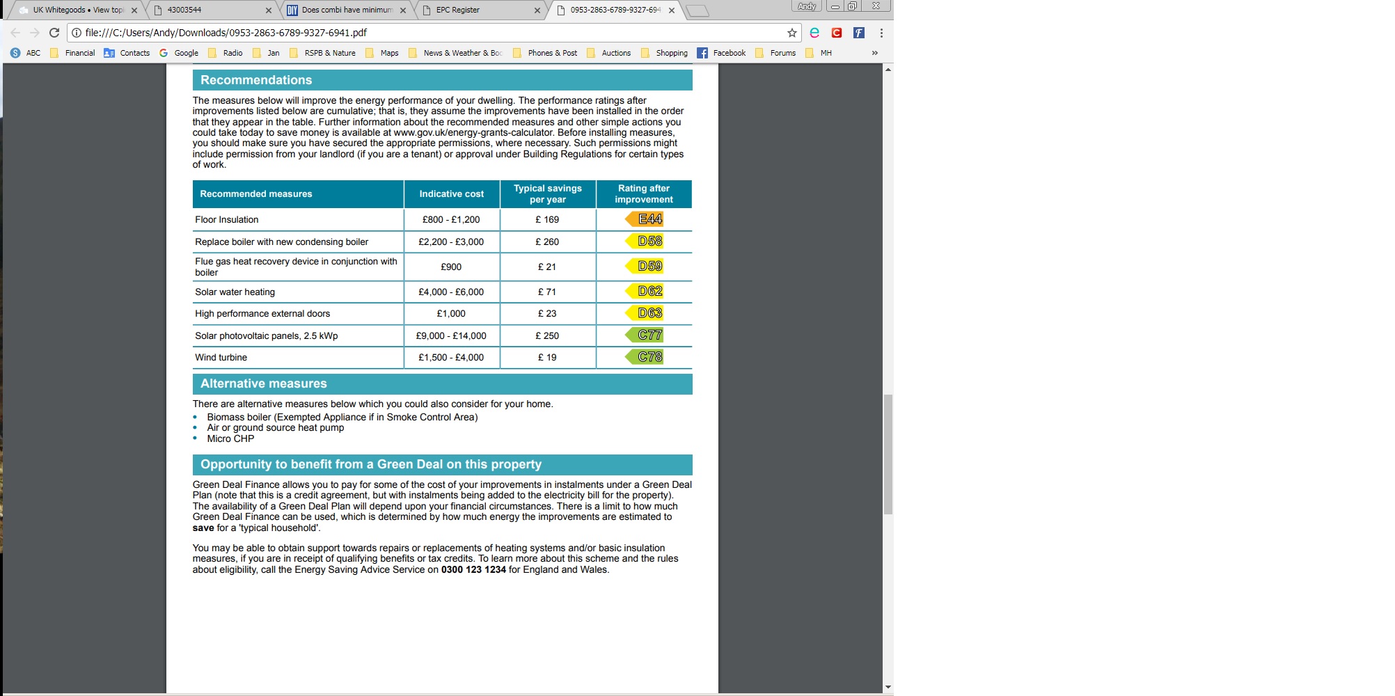

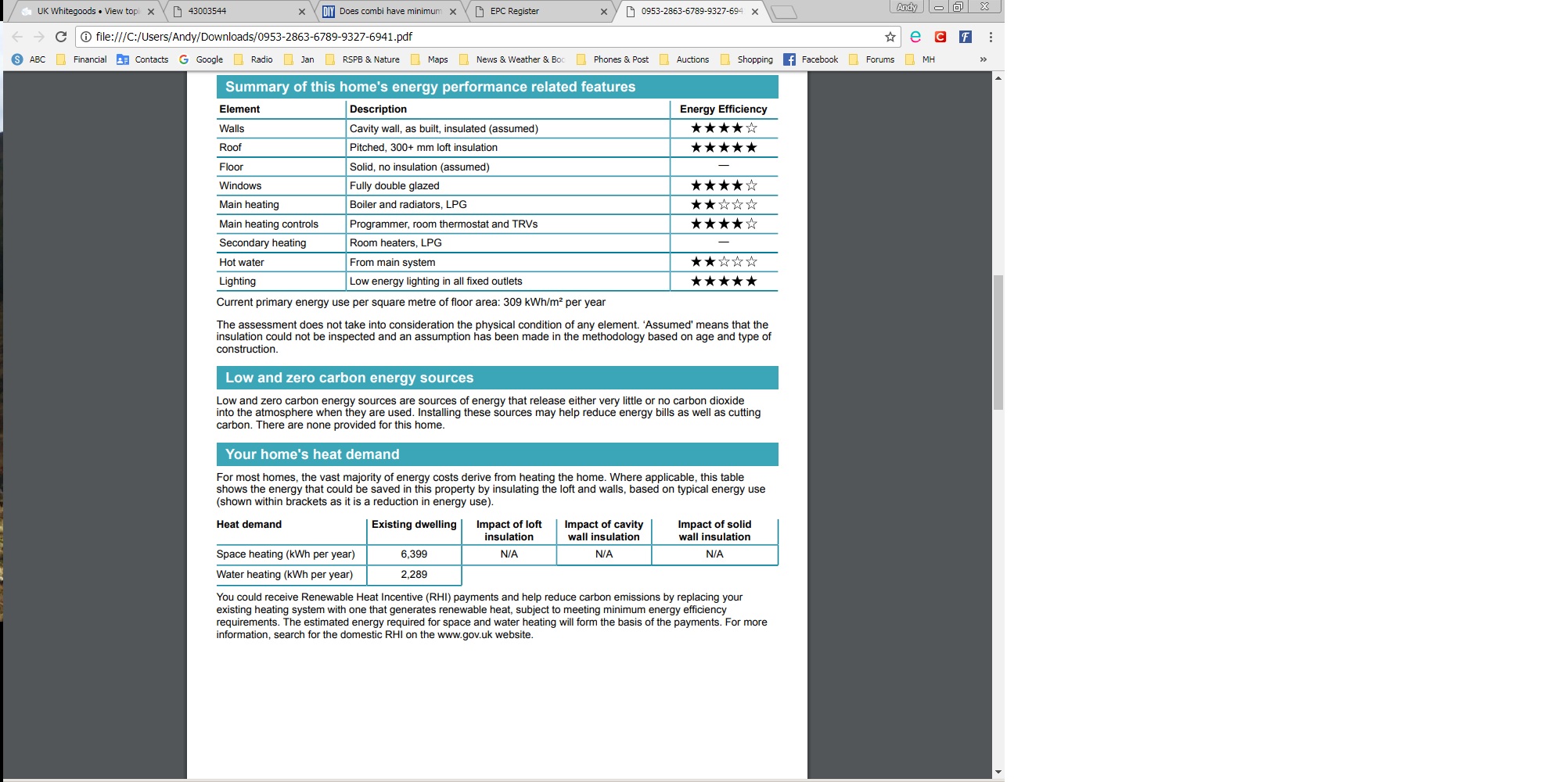

if it is a baxi bermuda back boiler the gas appliance for EPC is out of 5 and the Baxi BBU is a 4 so its not the fire and BBU that is bringing your EPC down. you may be able to keep the BBU if you upgrade controls and look at double glazing or other things
Yes it is a Baxi Bermuda but is on LPG which I think makes the difference. The property is fully insulated with UPVC double glazed windows but has solid floors.
Also has room stat and TRV's.
Here are a couple of screenshots of the EPC from 2013 and the recommendations.
The EPC is being re-done next week.

OK thanks. New EPC gives the property an F28, slightly worse than before. Replacing Baxi BBU and fire with condensing LPG combi and electric fire would take EPC to E42. Couple of points to be gained with attention to some insulation in ceiling void over lounge (single storey property), next step would have to be to rip up solid floors and re-lay with insulation. At least 'E' would allow it to be rented.
Don't know result with non-combi i.e system boiler option.
