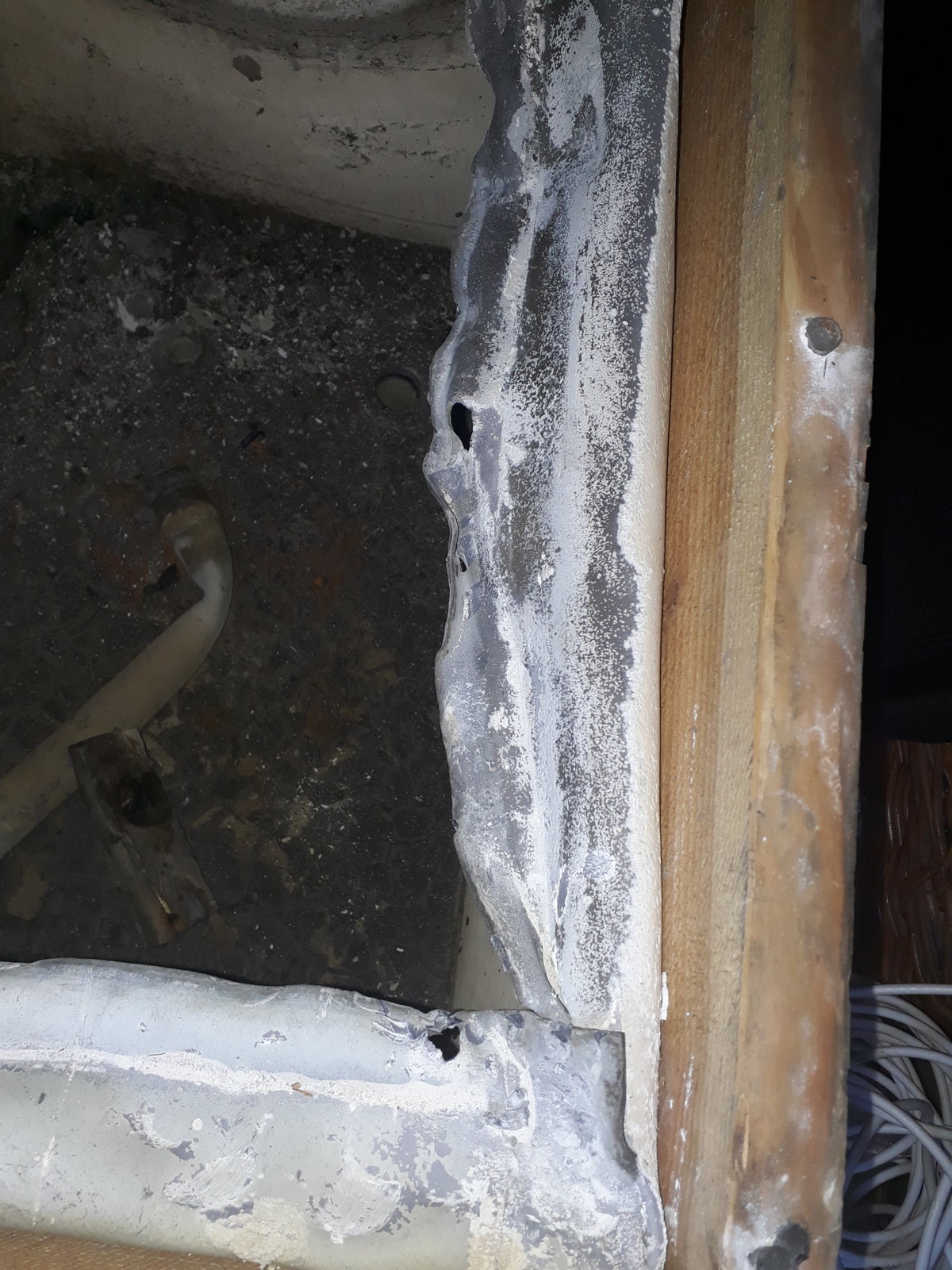

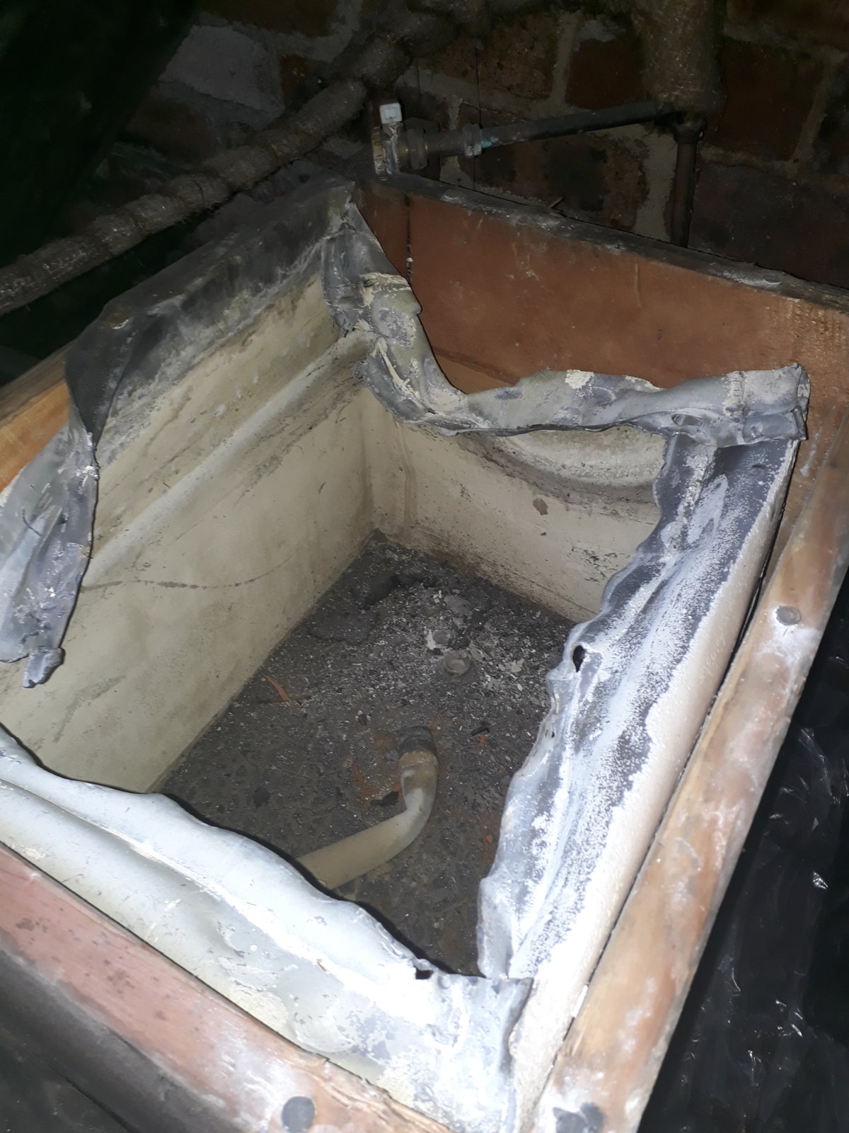

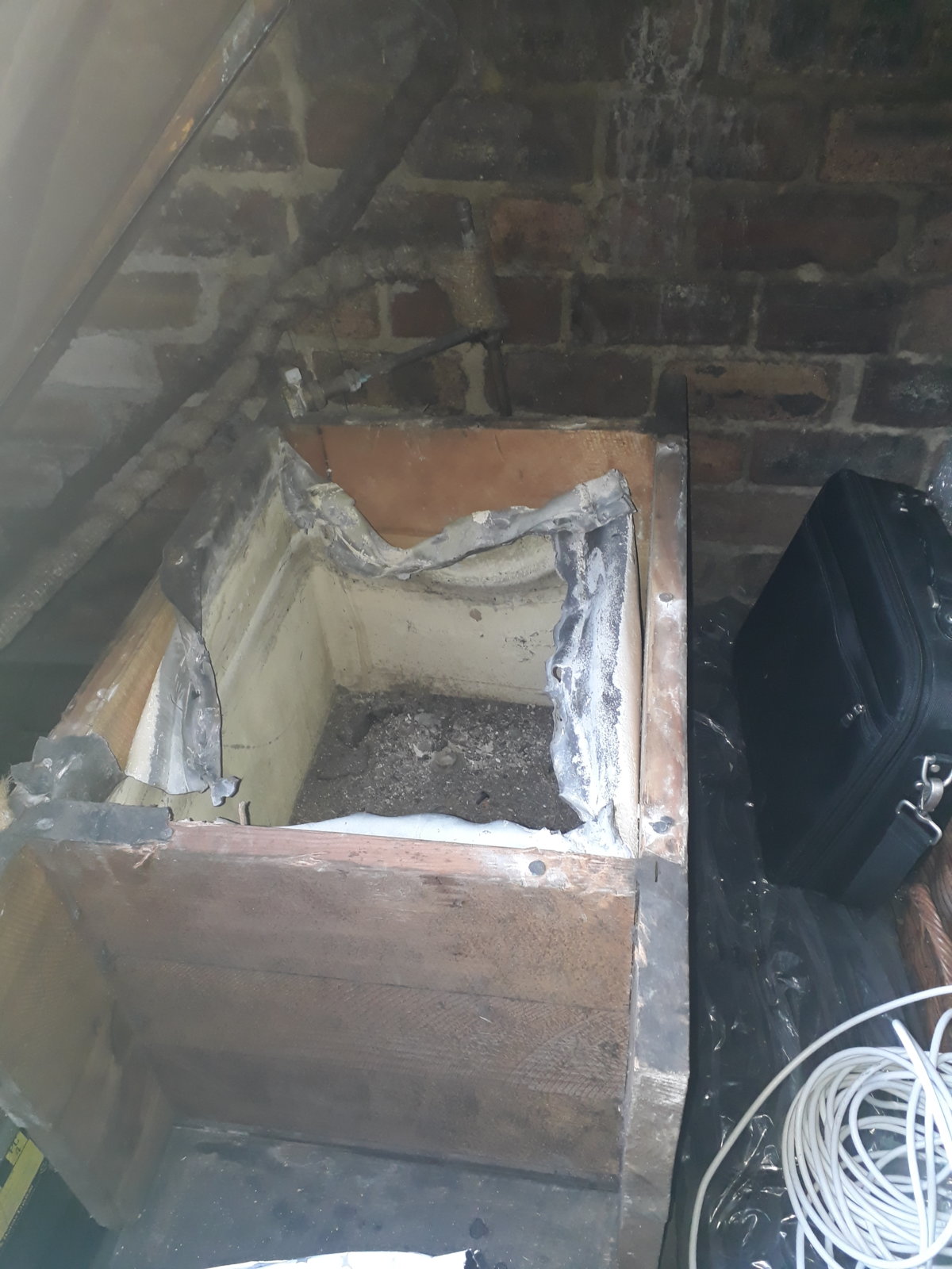

Hi
Looking for advice please.
My dad decided he was going to remove the water tank from my loft today and got straight to work before i had a chance to see. Im really nervous now ive looked that its asbestos. He says its lead and no health concern. I have a son with developmental delays so i am super cautious. I know my dads just trying to help but im worried.
Its a wooden box with lining of some kind then it has white stuff flaking off from where it looks attached to the wooden box.
Could someone have a look at these pics & advise? If it is lead what's best way to remove safely. It looks like he was just trying to bend it off from the wooden box...
Thankyou for your help!

It's definitely lead sheet Goodness knows why he wants to remove it :unsure: Best thing would be to cut a board to cover it and screw it on - then forget it.

Shift it or leave it, its harmless.....the white stuff is mineral deposits from days of yore.
John :)
As all above, lead lined tank, dating possibly from before WW2 ?
Biggest risk from that tank would have been if it were still in use, because water running or stored in lead tanks or pipes will allow the lead to leach out into the water supply, Lead based Solder is banned from drinking water systems.
Only "basic" safety procedure is to wash the hands after handling lead.

Overall a very low risk.
Coming to think on it there is a higher health and Safety risk lifting and moving lumps of Lead down from the loft and into the car for disposal at the scrap merchants yard?

If anything all he may need is a pair of gloves and a mask for any dust that may come off, as with anything like that. He'll want to cut that lead up to make it easy to transport.

Removed lots of lead from soil stacks - probably more dangerous doing that off a ladder working at height. As for anything else in your loft feel free to do as you’ve done and post pics if uncertain of anything. As with anything that could be dusty use gloves and mask as a minimum.
