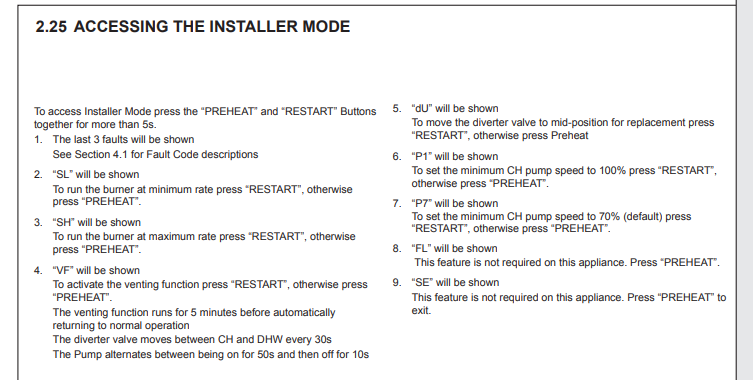

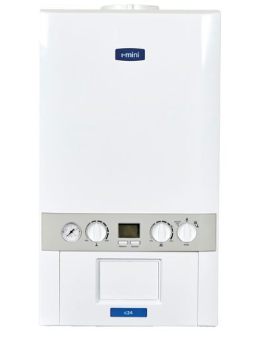

This boiler?
There seems to be just a couple of basic things you can do shown below
Thanks but no. That's the i-mini, I'm talking about the C24 mini which is a much older combi. Thanks anyway.

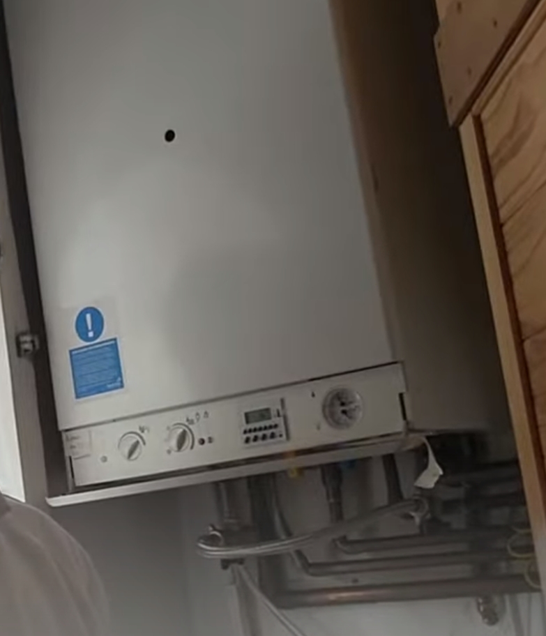

like this:
