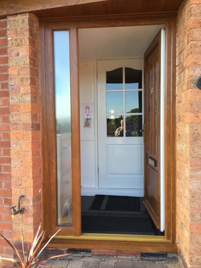

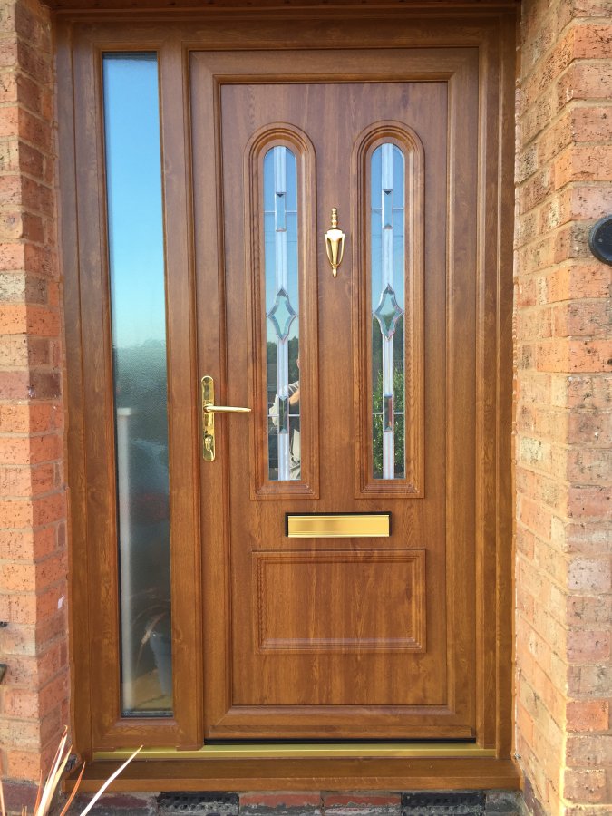

Hi all,
Just had a new front door and side panel fitted today. Not happy about the fitting, especially the two brown spacers below the side panel. Installer reckons it is correct but it looks like a bodge to me.
Ive searched the web for pictures, including very similar installations on the installer's own website, and I can't find anything that looks remotely like this.

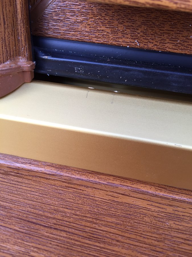

Also, there is a black sealing strip along the bottom outer edge of the door which doesn't actually compress against anything when the door is closed. In fact, from outside you can see the screws holding down the threshold when the door is shut.

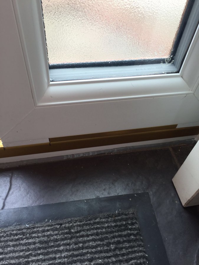

I think the side panel was made too short and they've tried to conceal the gap at the bottom with the two brown spacers/end caps. From the inside it looks just as bad where they've tried to fill the gap with a piece of gold strip.
What do you guys think? Bodge or normal?
Thanks in advance for your thoughts.
Never seen anything like that before .... can see no reason , other than the frame being to short for those pacers
Looks to me like they made the fixed units 10mm smaller than door frame, and are using packers to even things up.
Have you got a shot of the whole door? Looking at the pics again , looks like the door and sidepanel are one frame and that the whole door is too short , hence screws being seen through that black rubber strip too........
Never seen anything like this but I suspect it's how this company make it, the gap under the side panel will be for drainage, those little packers seem to have sculptured ends to match the profile so it would appear they're meant to be there, it's all very odd looking though

Hi ronniecabers, here are two more pics with door open and closed. Cheers

Where does the door not touch the seal, can you take a photo, this may be an oversight and just requires an adjustment?
This picture shows the bottom LH corner of the door, adjacent to the side panel. The seal looks way too high; about the same amount as the thickness of the two brown spacers below the side panel.
OK so if the seal isn't dragging along the gold threshold then the door sash has been packed (toe and heeled) too high, FYI this will only affect the lock side, the hinge side should be rubbing, from the last photo it does look high on the lock side, the black strip gets thinner towards the hinge side if you look
Seeing the whole door , you can see there is also a packer under the frame on the hinge side of the door. I suspect Crank is right here. Never seen a door like this before , looks like the low aluminium gold threshold continues under the side frame, hence the need for the packers for concealed drainage to work ( normally on concealed drainage the bottom of the frame overlaps the slope on the cill to allow the water out).
All looks very odd , do you know the name of the profile the fitters used?
I think the problem is the low threshold should only be the width of the door and should stop where it meets the side panel. Probably should have been made as 2 separate frames.
I agree, it's a right weird way of doing it, WHY would you!
