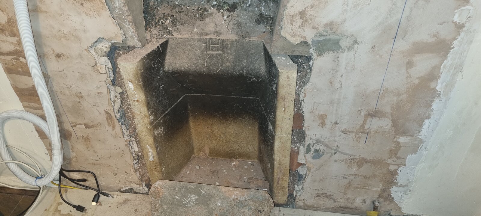

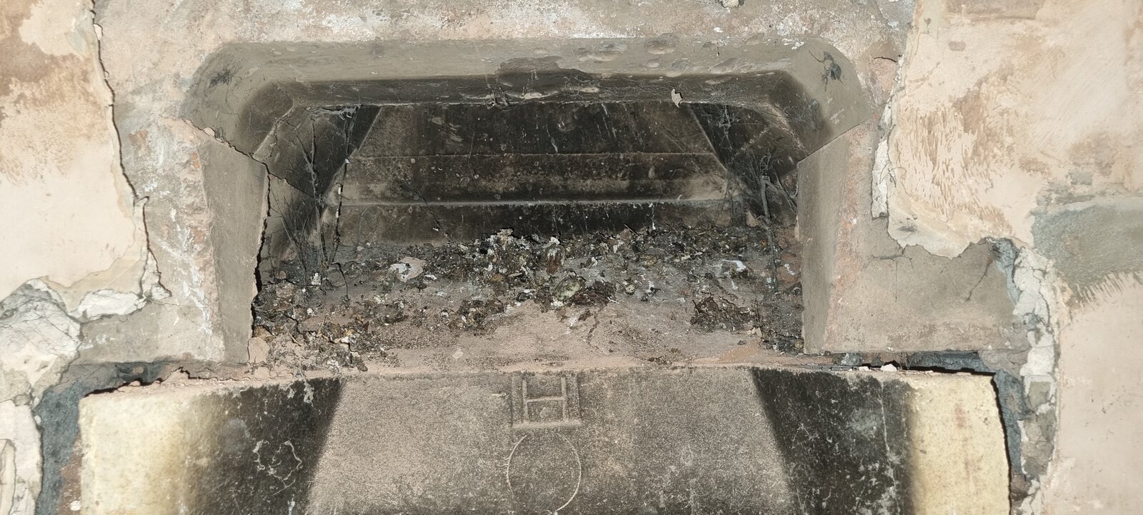

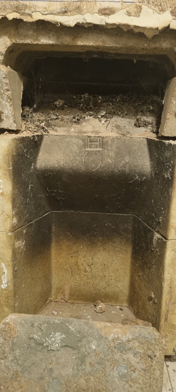

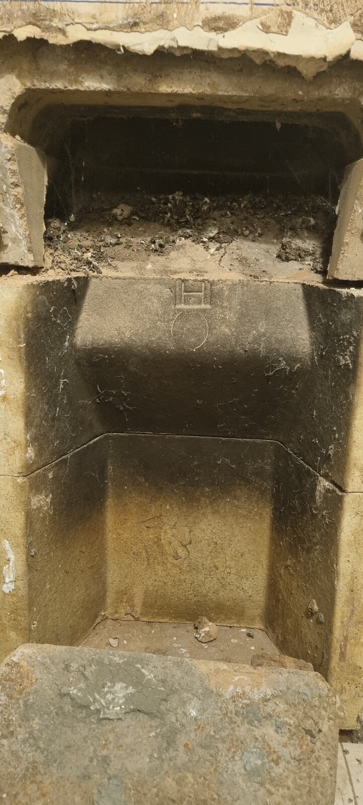

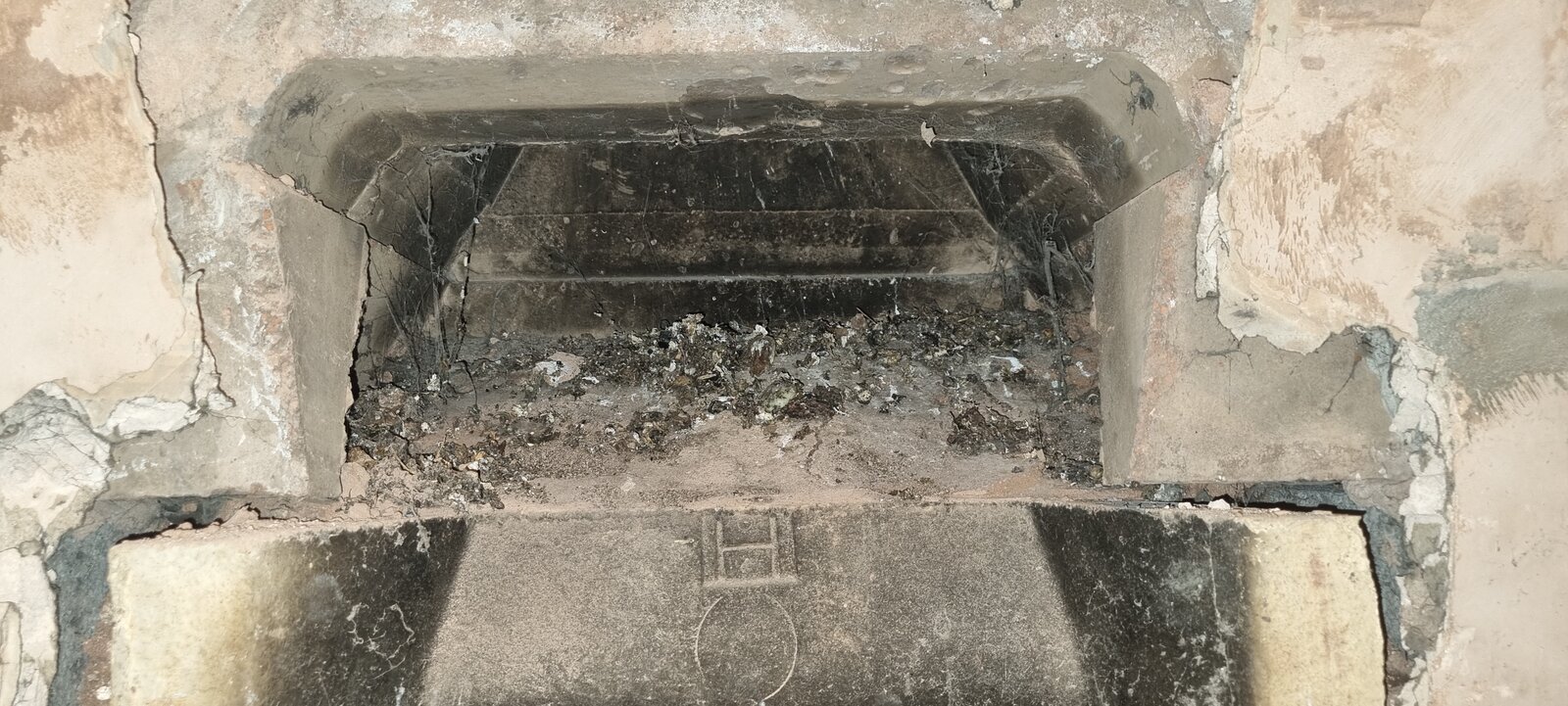

I can't really see a lintel at the top of this fireback. The chimney breast is also on the outside of the house. See images.
Apart from pigeon **** and rubble - no.I can't really see a lintel at the top of this fireback. The chimney breast is also on the outside of the house. See images.
View attachment 392330View attachment 392331View attachment 392332
It is relatively new build - circa1980How old is the property?
Yes, it looks like the breast has a liner of some sort when I looked up it from below with my phone camera.OP,
Whats your purpose for doing this work?
1980's chimney flues were often built with chimney flue block liners.
Why not get your flue or flues swept and then have a camera dropped down before removing the fire back (if thats your intention)?
FWIW: Removing the fire back shouldn't disturb anything else.
