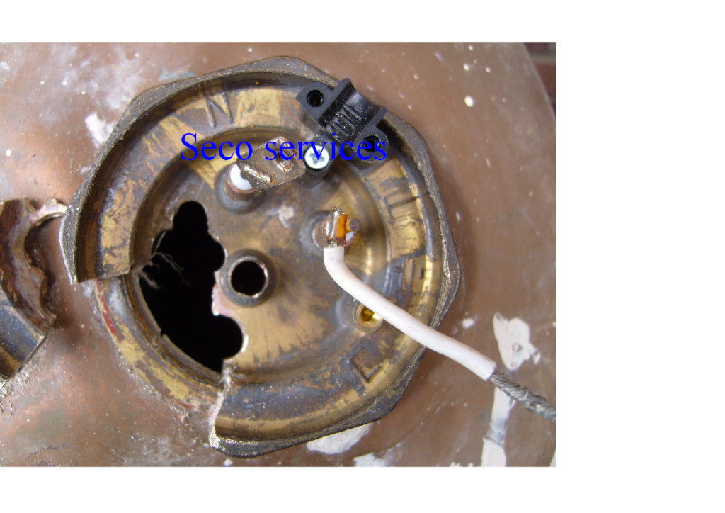

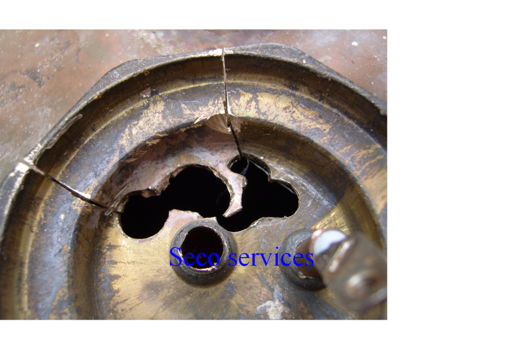

I had one last week where I have to drill out the centre, then use a hack saw blade to cut through to the side of the element. Then push in the side to remove the element. It took time but it came out in the end.

What size hole did you drill, Andy? Did the blade cut into the threaded flange on cyl a bit?

I used a 6mm drill bit and a junior hack saw blade, I cut from the hole to the edge of the element. I kept checking that I was not cutting into the thread and then from the hole to the other side. Then kept tapping the thread with a hammer and screw driver until I could get it out.

couple of old photos from Seco of an immersion heater being cut
