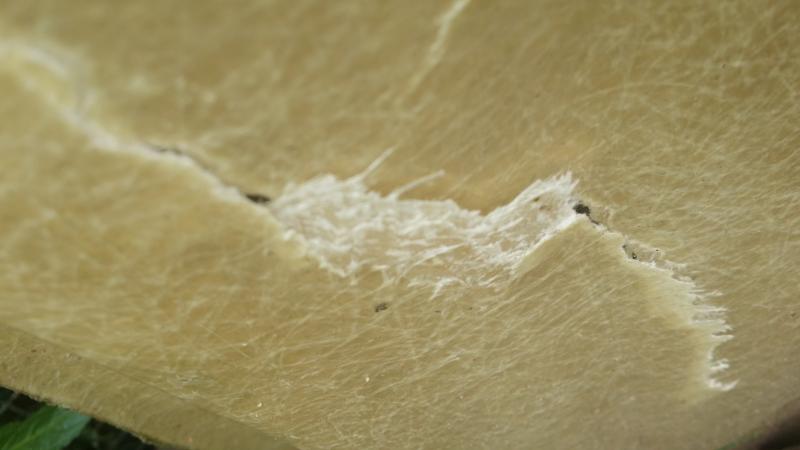

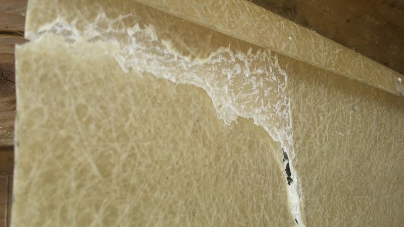

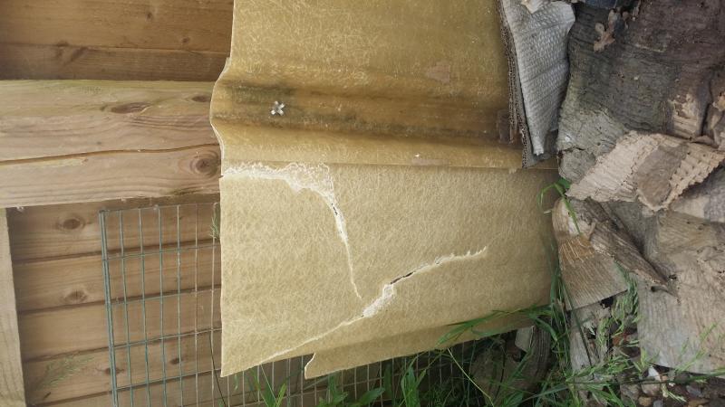

Does this look like asbestos?
16 Oct 2012
3
West Midlands
Long time reader. First time poster :D
Took this from my nans house, no knowledge of the history buy It just looked like old plastic sheeting. Cracked it the other day and within seconds I saw the white fibreous lining, dust in the air and quickly got away.
Done a lot of Googling and not been able to find any examples or evidence of a plastic asbestos type sheet. Just wondering if anyone has come across it before or has any ideas?
Cheers. Will.
Corrugated fibreglass roofing - frequently used in conjunction with asbestos sheets, to let the light in.
John :)
