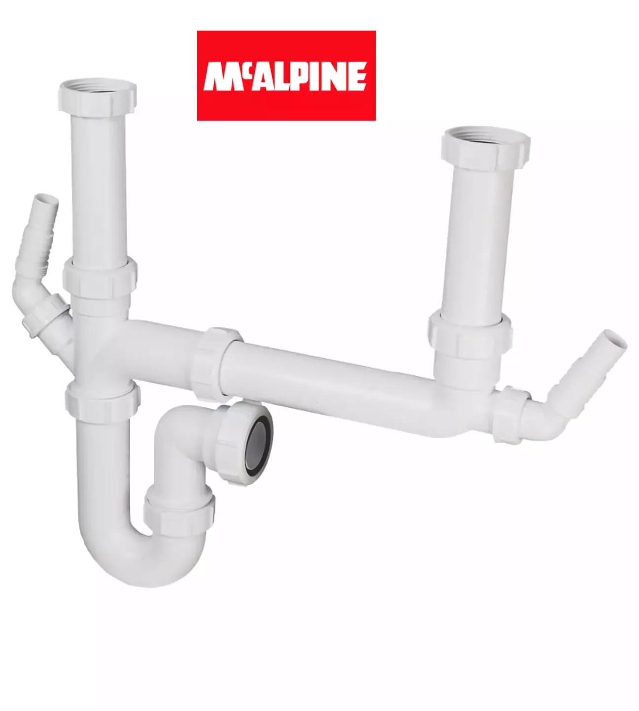

Does this pipework look okay?
Sink waste is slightly more straightforward, needs a new hole knocking or coring through the wall, and a new waste pipe putting through at the correct height.
It’s hard to tell as we can’t see the bottom of the sink, but I wonder if the existing hole was at the right height until that tee piece was inserted for (presumably) a second sink to the right. With luck, maybe it could be re-done without needing to drill the wall.
Definitely easier than fixing the incoming supply!

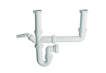

I'd say it's drop is more to do with the appliance spigot adapter that's been added between the tee and the sink waste. The tee on the 11/2 sink kit is a standard part of that waste kit and hasn't been added
Take the garbage quality spigot adapter away and it's maybe got a chance to be @ the right height. If 2 appliance spigots are needed then it can be changed for an alternative kit
but have to agree there may be a chance to avoid having to cut another hole.
It's all been done by someone that's only playing at being a plumber and obviously has no real concept, experience or training as to how to implement any of it properly.
Thanks again to everyone for your thoughts and advice on the mains water and sink waste. Thankfully dilalio came over today and has everything sorted!
The drain did need a new hole drilling. I think the previous owner had put in a deeper sink than would originally have been there, and without enough room underneath to the old exit point, even with that McAlpine set up.
