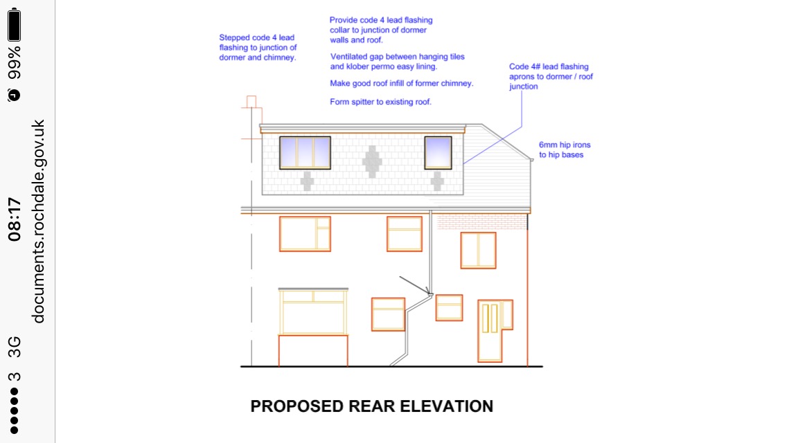

I wonder if it would be worth submitting a revised drawing to the application with the dormer included to try and get the planners to admit the dormer is permitted development without actually having to pay for the LDC application.
I've asked the council if they would waive the fee due to them not uploading the right plans. I'm 100% sure that 5B was not on there previously, I think they uploaded the e-mail chain in place of 5B here:

The first one submitted was refused because it was too big, it was wider than the original house and didn't meet the councils SPD document.

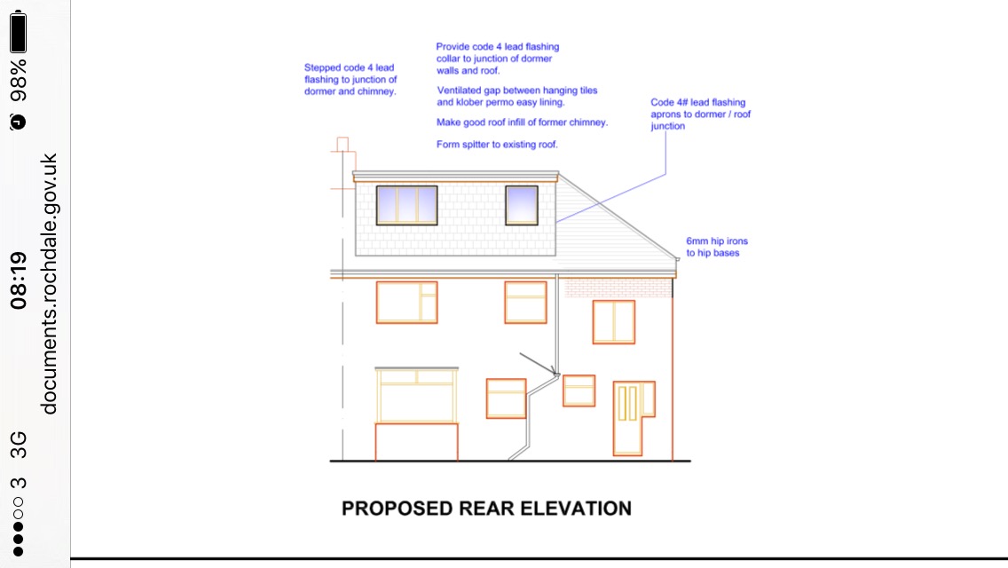

When he said he would remove and replace it he sent a picture of a smaller dormer which was (roughly) 600mm narrower then the original house. And then submitted a drawing with no dormer.
I've spoken to the couuncil Building Control Officer and he says the smaller one (top picture), still wouldn't meet the SPD.

If it isn't higher than the ridge, isn't wider than the original roof , is stepped back in 200mm and doesn't increase the volume of the roof space by over 40/50 cum. then it is PD end of.
Good to know, thanks. We can easily meet all those, it's 2.7mtrs tall inside the loft so maybe 2.9mtrs to the ridge.
Do you know if there a 200mm limit for the ridge as well? On the SPD document it didn't quote a figure.
no just shouldn't be higher than the existing ridge. You should be fine should be able to get a head height of over 2.3m out of that

The plan drawer and council told us that the dormer needs the certificate of lawfulness.
That cost £86 and was paid in February. Got an e-mail from the plan drawers secretary today:
Can you arrange to call into the office, the certificate of lawfulness had been knocked back by Rochdale Council...
.... because he has designed it to big, its 55cu/mtrs.
