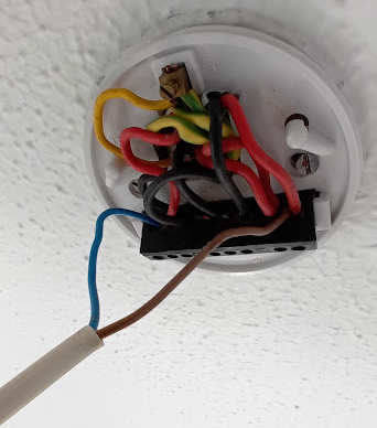

A simple "Are you busy? Upstairs lights have stopped working".
Customer insists nothing has been done, judging by the amount of dust in the lampshade and dead bugs in the rose I feel it is genuine:

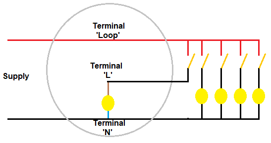

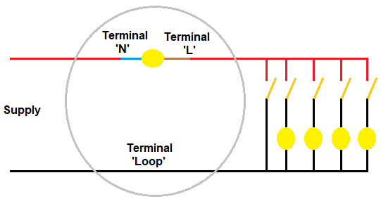

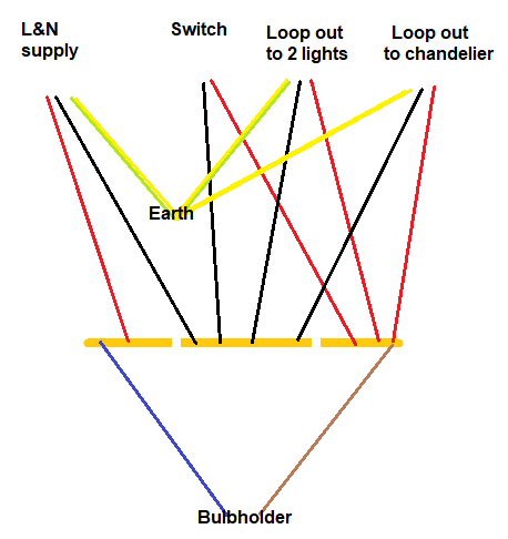

For clarity that's one red in 'N', 4 blacks in 'LOOP' and 3 reds in 'L'. My instant guess being this is a total L & N reversal. I unhooked the flex and started loosening the rest before I took the pic.
All testing done with a LED screwdriver found 'N' is the only 'live' terminal.

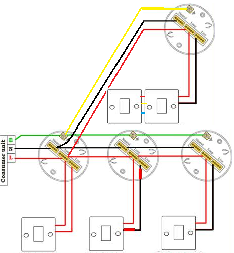

2 (CFL and LED) of the other 4 lights are wired as very standard 'Loop at rose', the other 2 are a bathroom LED fitting and a brass chandelier style (yellow single wire, tested continuity to brass fitting) with 3 small looking CFL which I didn't open as they are without roses.

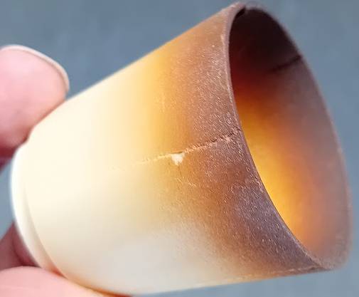

And the HO skirt
contained a blown 75W bulb.
I rewired it as standard Loop, repowered and when I switched the light on the RCBO tripped due to a damaged switch drop in the loft and I suspect this was the reason neutral switching had been attempted.
I did need to read a few times, it seems the switch drop in the loft has enough line to earth current to trip the RCBO but not enough neutral to earth current to trip it?

Don't apologise, perhaps this makes it easier to see how it was working:
And now

ok,
but
image below - should never have worked
UNLESS the switch was NEVER Switched ON

ok,
but
The whole point is it did, the switch would turn the 75W buld on/off and when off the other low power lights would work.
The light in question is the spare bedroom and I suspect rarely used.
The fact that none of the lights lit meant I was not looking at blown bulbs initially.
I hadn't mentioned the CU was replaced in 2022 with full documentation.
ok, ignore me, i missread the diagram as a light is there - hopefully other members may help as to why NOW
