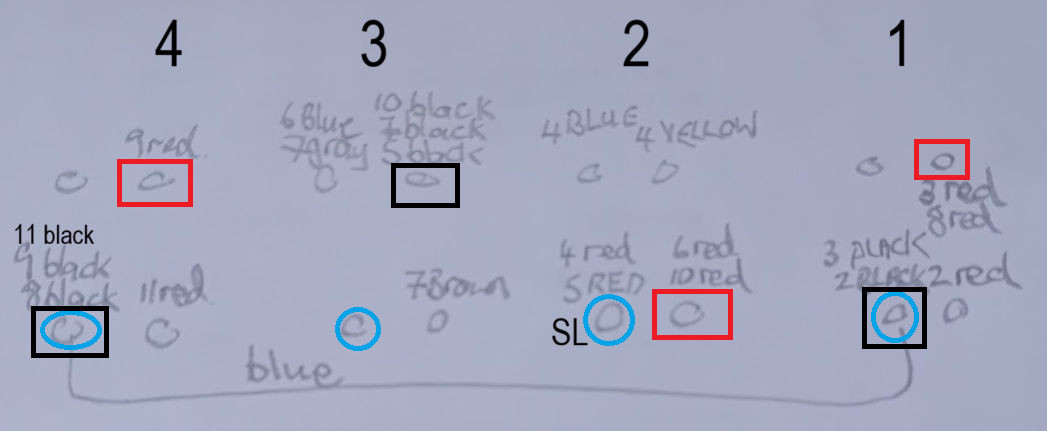

I was out on a light switch replacement this afternoon.
One which was replaced yesterday (Sunday) by an insurance service. We were sent in today by the insurance company to sort it out as it was reported as 'keeps tripping the fuse'.
The broken switch was in the rubbish bin, 4 gang 2 way with 'Loop terminals - very handy to have the instant comparison/explanation with the replacement! the faceplate is basically broken in 2 with a chunk of it between 2 switches missing and bits of exposed brass.
Replacement switch 4 gang modular (I assume from SF as very close by) fitted with intermediates
Also in the bin was last years TV license with this on the back... even handier!!
I assume it shows the 'before connexions' and the replacement had been wired exactly the same although the ladies told me he spent ages trying different combinations.
I've marked the terminals with a blue circle which had been 'LOOP' terminals but now the intermediate switch L1' lines
I've marked the terminals with a black square which were permanent neutral
I've marked the terminals with a red square which are permanent line
Switches 4 & 1 running on one lighting circuit but short L to N when switched off there seems to be 2 'loop ins' and 1 'loop out' the neutrals are linked (and have to be for the remainder of the circuit) but the lines are not linked
Switches 3 & 2 are on second lighting circuit
Switch 3 is switching neutral (cable #10 is feed to SW3 L2 and SW2 L2' [used as COM]) - Cable #6 T&E to the light has red, blue and green/yellow insulated cores and yes it really does appear to have those colours.
Switch 2 the SL (returned from distant switch via strapper) is in the switch's 4th terminal but doesn't affect operation
It didn't take long to diagnose why SW 1&4 tripped the RCBO and that was even without tripping it myself, it might have even taken longer to drink the COT than fix the errors. Apparently the insurance guy was there for several hours.

They were originally terminated in 'LOOP' terminals on 2 way switches then on line terminals of new intermediates.
Switching either of the two outer switches off shorted L to N - not sure what's going on with the loop in and outs as 2 of 3 lines are live but 1 of 3 neutrals are live
And were the neutrals from different circuits?
There are 2 different circuits there but no they aren't mixed

I guess they went to buy switches with 4 holes like the previous ones, but got intermediates instead of a loop terminal.
You still need the patience of a saint and the deductive reasoning of Sherlock and Poroit combined to work that lot out!
Simply knowing it was a new switch and not working properly was good to know I wasn't on a wild goose chase.
Luckily all the cables are numbered with sharpie on the sheaths and the deep box is set quite deep in the wall so loads of space to work in but - yes - the tangle of 11 cables would have made it horrendous if it was a 'start from scratch'
Mind you, as you say, it's better than sifting through a box-full of misplaced conductors without any clues whatsoever!
Seeing all those blacks connected together was an instant clue, then being told the old switch was in the bin and finding they were previously in 'LOOP' terminals I didn't look any further... It was actually a really easy fix getting everything working without tripping.
The thing that took longer was #3 & #2 simply didn't look right with reds in 'LOOP' and 3 blacks in an 'L2' terminal which didn't light my LED screwdriver, hence establishing #3 was switching the neutral, then checking its partner switch and ceiling rose before converting it to switching the line.
That's exactly my thought... "Here chum I need one of these." "There you go a plate and four 4 hole switches is the best I can do on a Sunday."
But do bear in mind this was an emergency call out insurance service. and they called on a local electrical contractor to get is working properly the following day.
