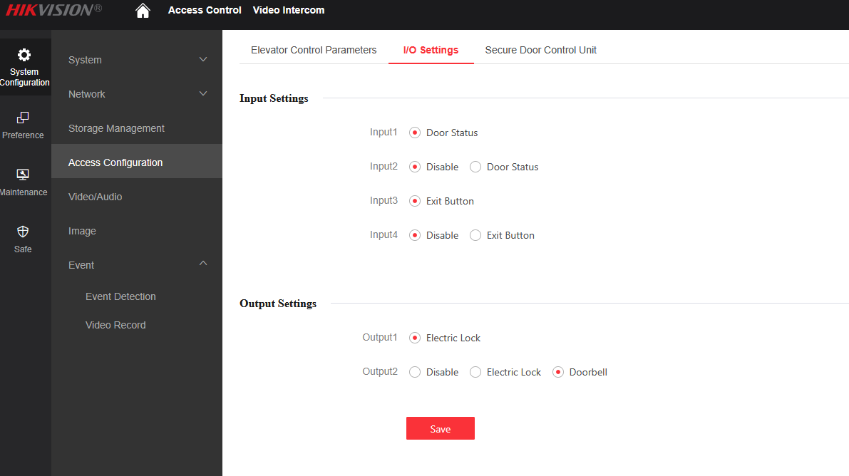

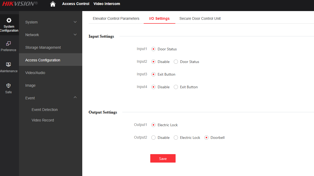

In the output settings I can set Output 2 to a 'doorbell' option. Hopefully this can be used to wire to a manual chime for non Hik-Connect notification.

Mine is connected via a PoE switch and it just worked, the bell push notified the app and i set up a detection zone on iVMS / SADP which alerts when someone is approaching the door.
Changed the output settings to “doorbell” and connected to a Byron 776 chime and everything works as it should.

So i have changed my output setting to 'Doorbell' but dont have a chime connected to it. Are you saying that you need to have an external chime fitted for it to trigger events (doorbell presses) to Hik-Connect?
No, only if you want a chime as well, it should notify the Hik-connect app with or without changing the output.

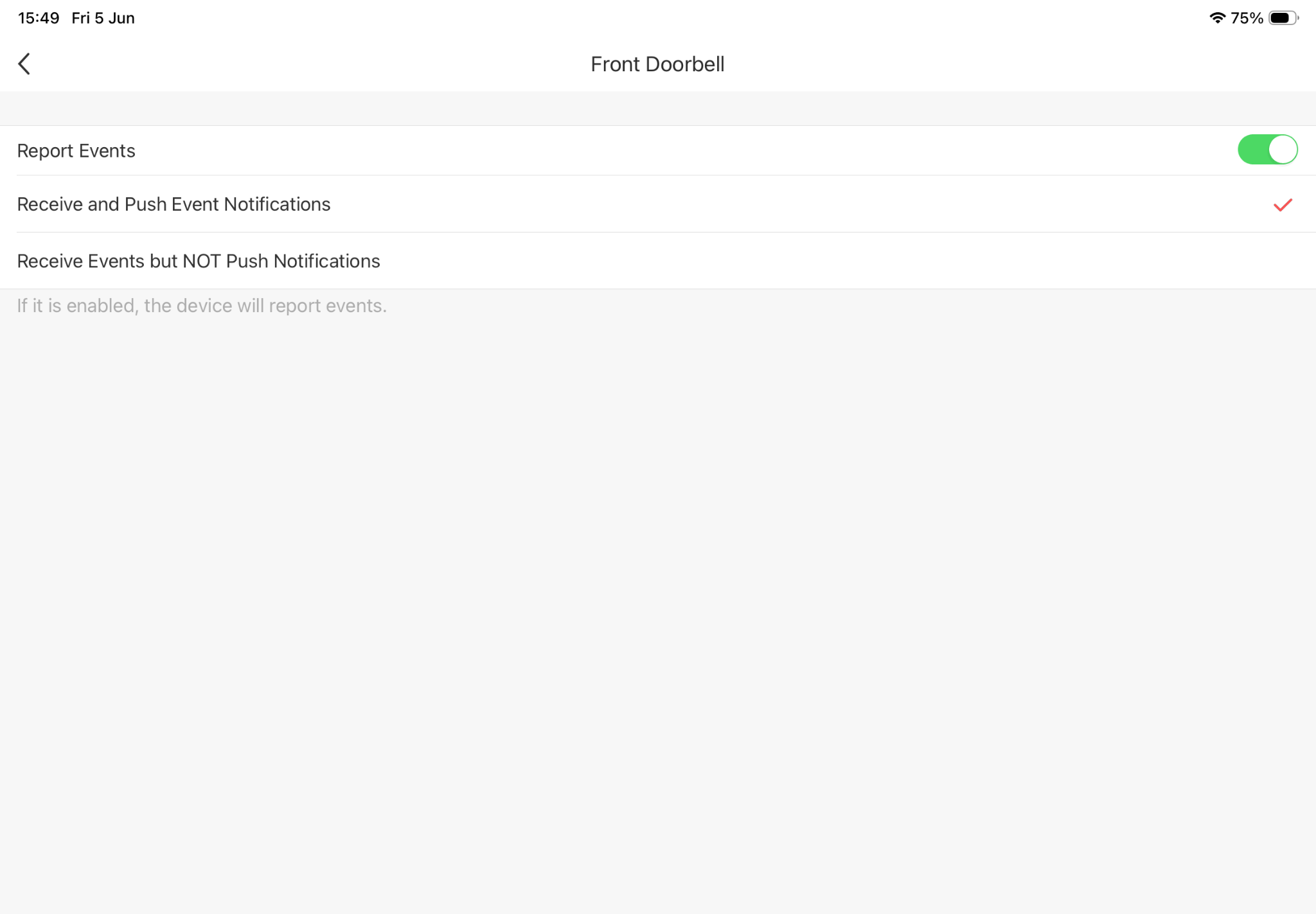

I’m not at home atm but just checked on my Hik-connect app, have you got Report Events enabled ?
I was originally connecting the doorbell direct to the NVR (which worked ok), but i have realised that in order to send alerts using the Hik-Connect service you need the doorbell connected to an internet connection as well.
So now i have changed it so that both my internet and a channel from the NVR connect into a PoE Switch and the doorbell connected to the same switch.
The NVR re-established comms with the doorbell and i can see/control it through the NVR again and its web-browser too.

I have the Hik-Connect app notificatins set for 'Events and Push Notifications'.
I have managed to get motion alerts working to the Hik-Connect App but still struggling with doorbell press alerts. The doorbell gives out 2 'engaged tones' and nothing comes through on the App.
