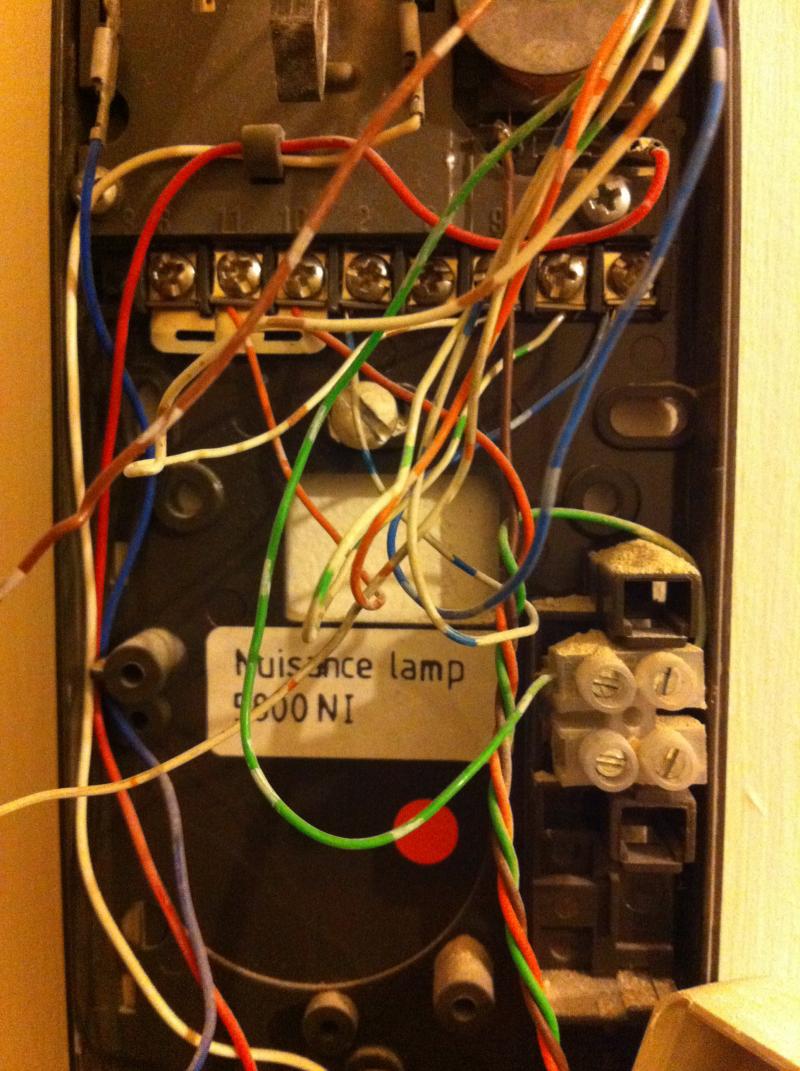

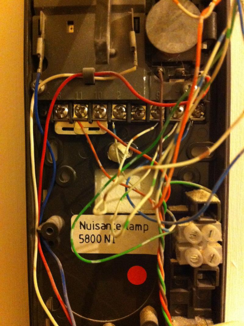

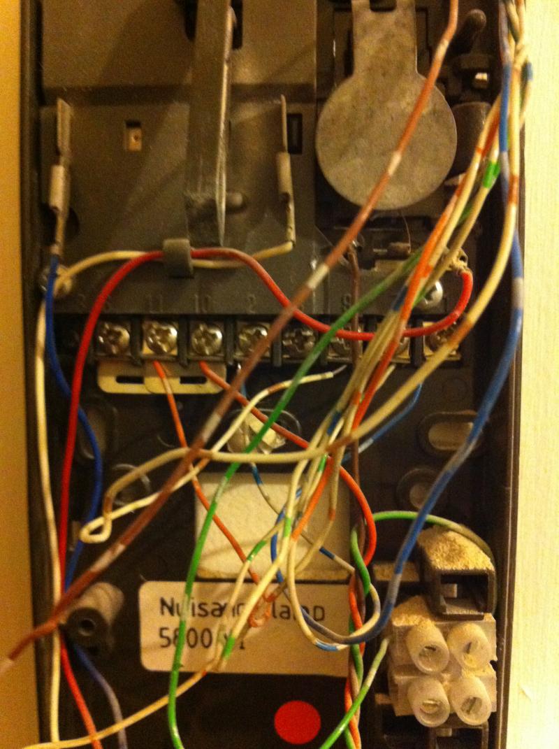

As before need a full picture of either the outside panel or other flats intercom, you can't just buy any intercom and wire it onto your existing system,some may work as the basics are the same but you may suffer from poor speech quality in and out , buzzer not working, lock release not working, so either fit the correct replacement or a universal handset proved to work on the system.
Hi There,
My neighbour gave me those pictures - thats is from a Urmet phone system.
On the wire i have i don't have plain colour (orange - white - blue) its either blue with white stripes or white stripes with blue...
Thank you !!!
Go to this site.... Intercomsrus... To to handset finder your neighbours handset is a status 5800 scroll down to urmet 1030 which is now been replaced by the 1130, you may need a status handset as these are sometimes modified to work on status systems ...

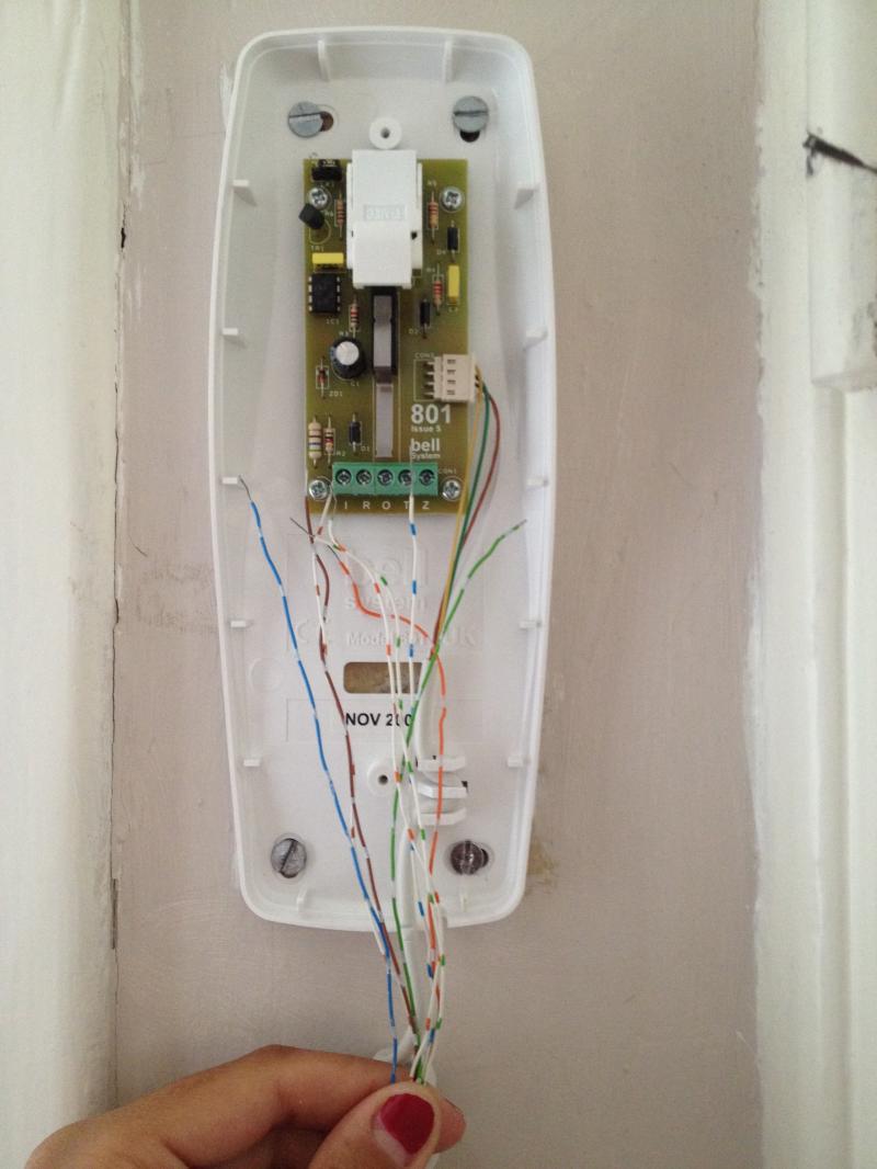

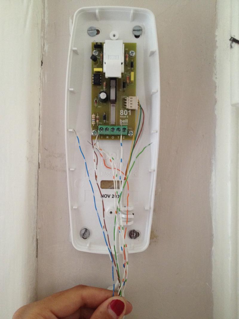

Bought a Bell 801 to replace a Bitron handset and this chart helped me loads. Just remember to take a picture of the wiring before removing the old handset.
For those looking to replace a basic handset with the Bell 801, the handset is 'very' basic. No instructions supplied with the box either. Does the job but I would have like to have seen a button that activates the microphone just like the Bitron. Once the handset is lifted from the 801 receiver, this activates the mic. No biggy especially for £15 from Amazon.
