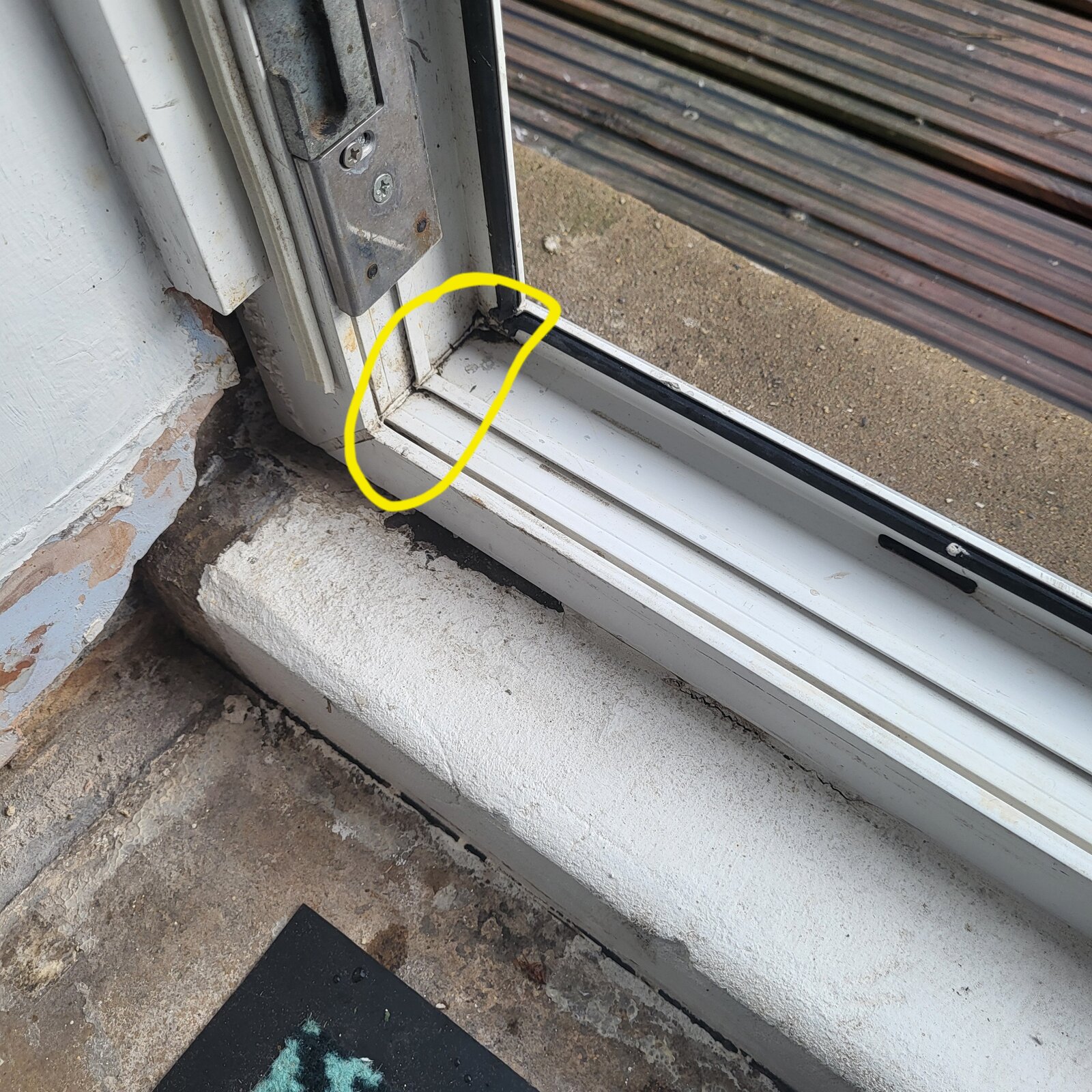

Hello. Seen a few topics like similar to this but my problem seems differ slightly
We have drainage holes in our pvc door frame, which do feed through and let water through to external exit holes.
however they also seem to let water through the door frame which collects internally in the area in the blue circle.
Is this due to damage? Or has there been a mistake during installation? And is there anything I can try short of re installing the frame?
Is the blue circle shown in the pic, internal? It's just that it looks like an external step.

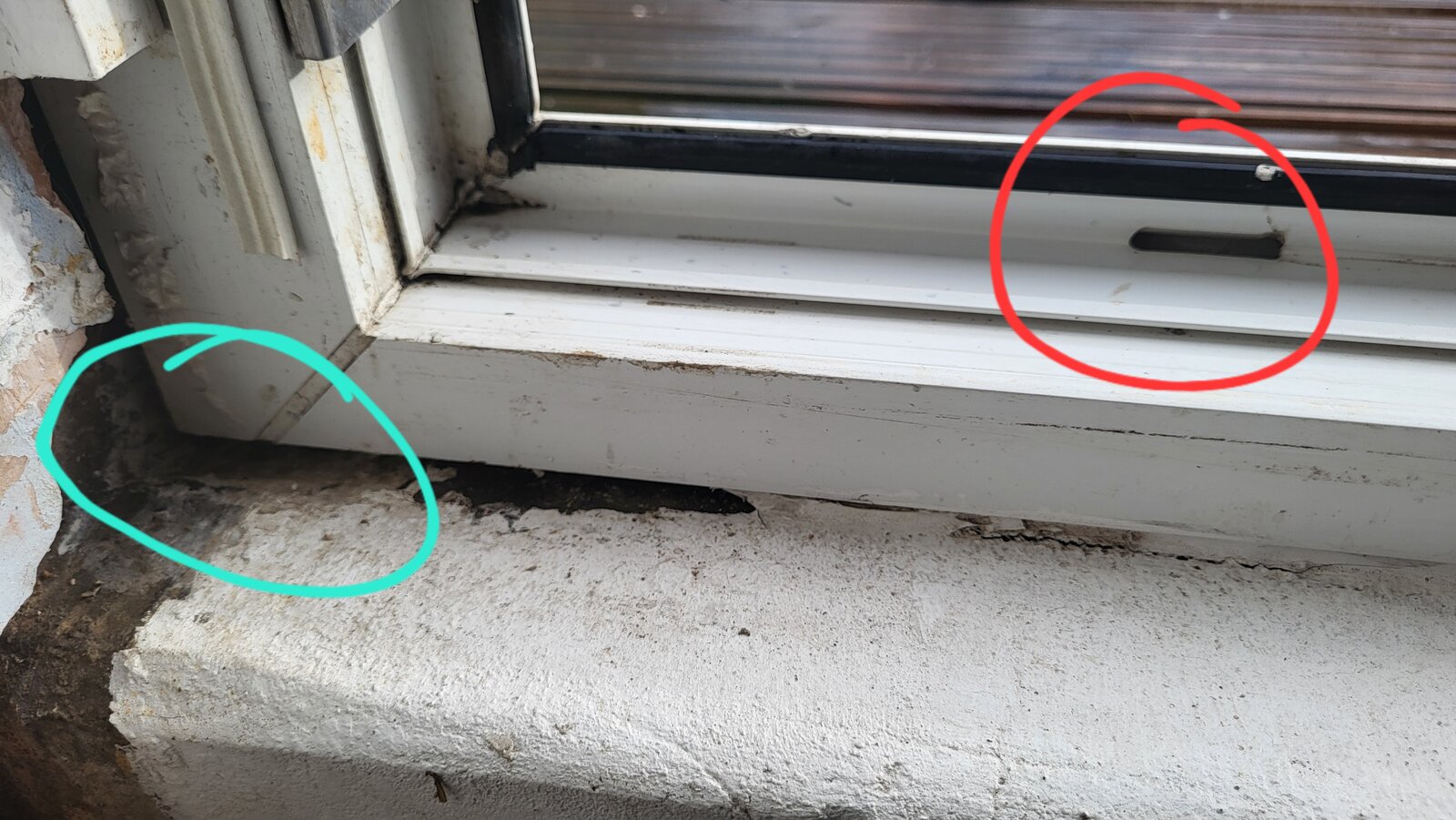

With regards water not fully exiting through the holes, you may find that they are blocked. You can try poking a wire or pipe-cleaner in from both inside and out. Be careful not to get it stuck. Or, get your head down and blow into the holes?
I had similar in one of mine. In the end I drilled additional holes to let it drain.
That distinctly looks like laminate flooring the same side as the.drainage holes? If so then first biggest issue is that the drainage is draining into the building and the door has been fitted the wrong way round. If the blue circle is on the outside , at least some of the water is leaving the building
Thanks for the replies. The photo is misleading. Its taken from the inside facing out. So drainage outlet is facing externally and appears to be clear - water flows out where it is supposed to but it ends up in the internal blue corner too.
On closer look I'm thinking the water is actually getting through the corner of the frame here.

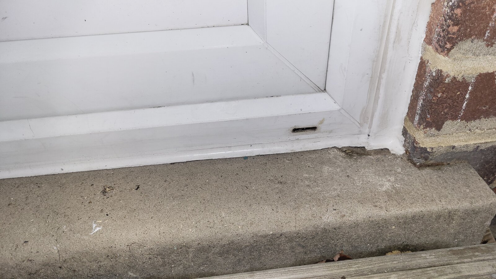

to the OP, Can you post a pic of the outside face inc cill / step.
Oh totally agree about the potential sealing of the gap between cill and bottom of door when its base drainage...see it all the time especially from Handyman/Odd job type people who think they know where the leaks coming through and its a nice quick fix lol.

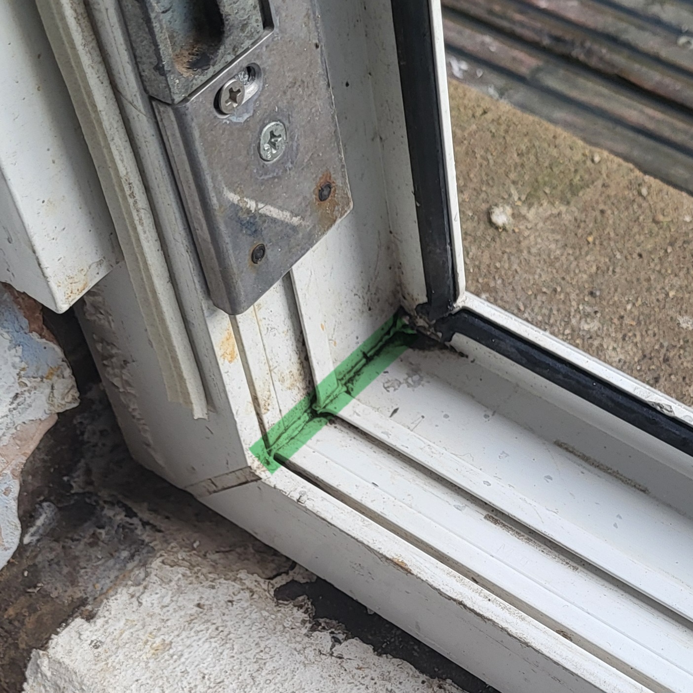

The external drainage holes are definitely working ok. Theyre not blocked externally, have been fully cleared out and water flows freely.
Ive been testing with a watering can and theres no ingress if i drench the step/frame.
Water only appears if I direct it at the door itself.
So I'm fairly sure water is getting past the gasket and down through the join highlighted.
Time for new gaskets I think.
Can the join in green be resealed too though?
It may be that join at fault although never come across that before. I see no reason why you can't run some sealant along it.
You may find it is just the sheer quantity if rainwater being too much for the drainage holes and overflowing inwards. Due to door seals, door adjustment leaking of the lower panel etc.
Does the door have a rain deflector on the bottom -- as per RrogerDs ideas.
Id say looking at those pictures no it doesn't
That joint can indeed be sealed , it would normally be welded, very unusual for it to be damaged ( if it actually is) , and the point about being overwhelmed is very very valid especially if it is leaking on very windy days , as the drainage would pressurise focing water into the property through the weakest link ...the rubber seals.
After further testing you are indeed right @RrogerD & @ronniecabers
The frame was simply being overwhelmed and tracking water down into the bottom corner. Couldn't see it with the naked eye but used some tissue paper to check for ingress that way and yep it's coming through.
@aveatry no we don't have a deflector so will get one of those installed.
Thanks for all the above pointers - much appreciated!
