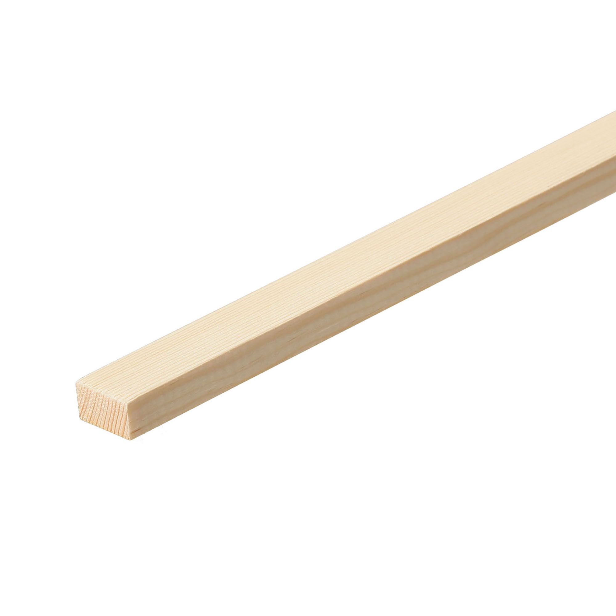

What about something like this for the wooden trim:
I was looking at these:
I think B&Q are cheaper though.
I will put my architrave on the current wall and gauge the thickness of architrave I will need.
Will 11mm be too narrow to nail? I am planning to purchase a nail gun for this task.
A strip of 4mm MDF glued to the back of the architrave would do it, then just plane it back where the plaster gets in the way.
4mm... or whatever thickness you find you need to make up.

B&Q look slightly cheaper for the 10x25mm.
You'll likely need strips slightly narrower than your doorframes.
You can cut to size yourself or buy the size you need depending on the tools and time you have available.
Would it be advisable to pin the strips to the frame first?
I would pin the strips on first.
You might also want to set the strips back slightly as movement is going to show up the join and it can be better to make a feature of it from the start.
