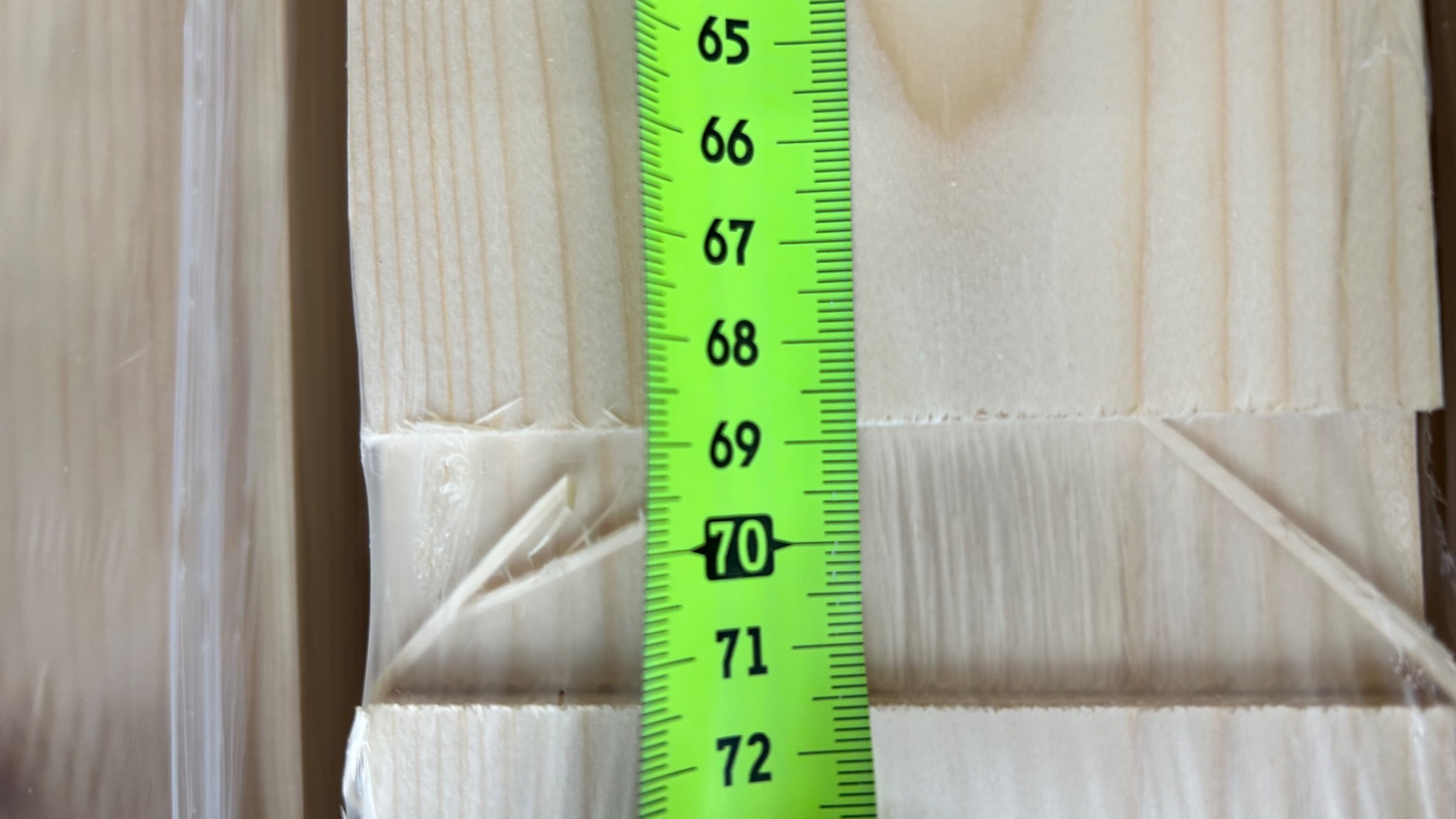

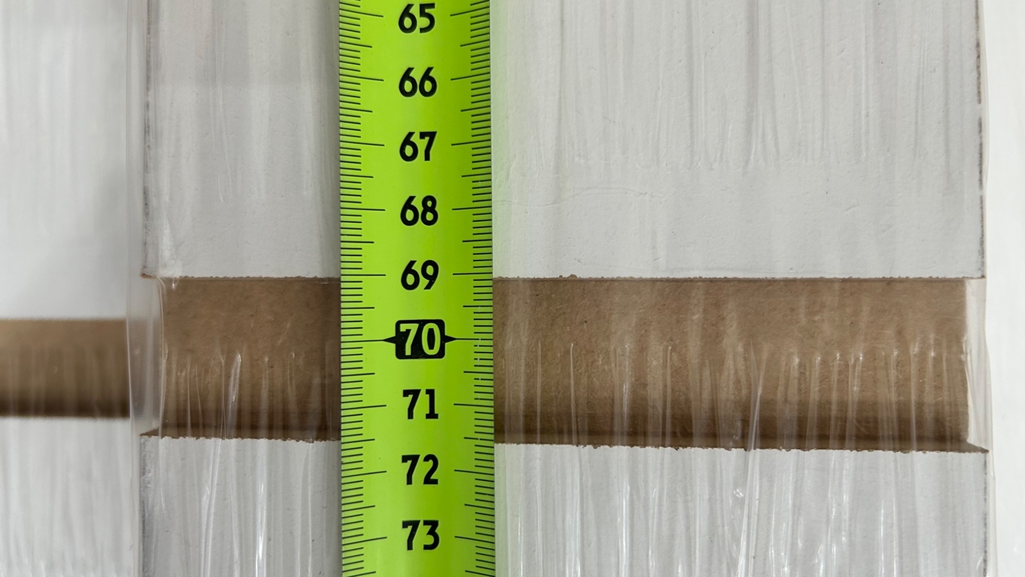

Hello, I checked out and measured door frames in Wickes and I found two different answers:
MDF door frame: 691mm for a 686 door
Softwood door frame: 688mm for a 686 door
The softwood seems tight with only 1mm clearance per side, unless they swell when painted?
