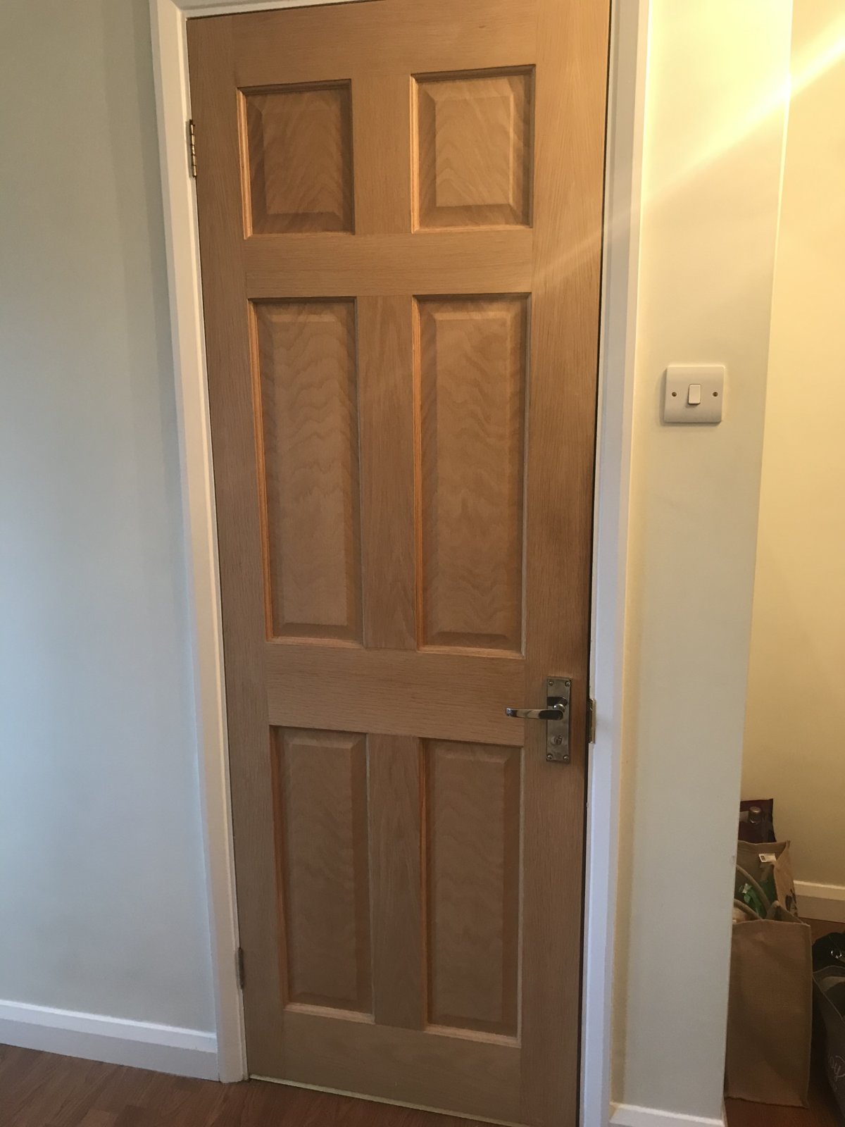

I had a similar problem when changing the door on our downstairs toilet. It needed too much taken off of each wood trimmed edge and would have gone down to chipboard on both sides. I had most of it taken off of the hinge side so you could only see it from inside if the door was open.
