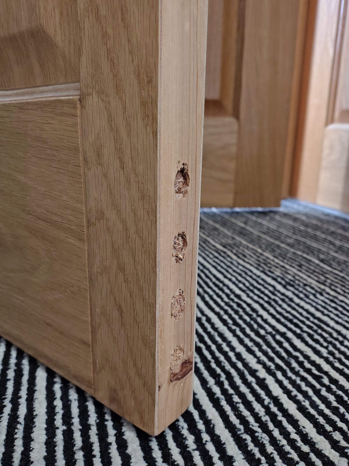

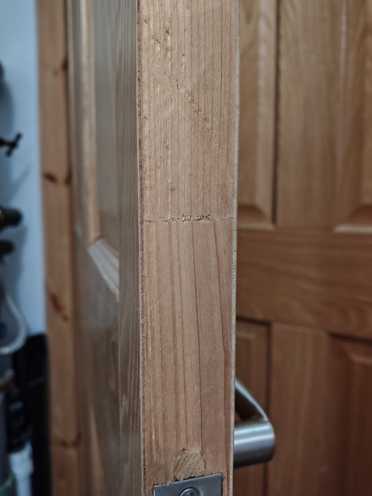

I had to cut a door down past the lip but it has not affected its performance and it has not fallen apart or anything. Its a hot water tank cupboard so didn’t matter about the look when it was opened.

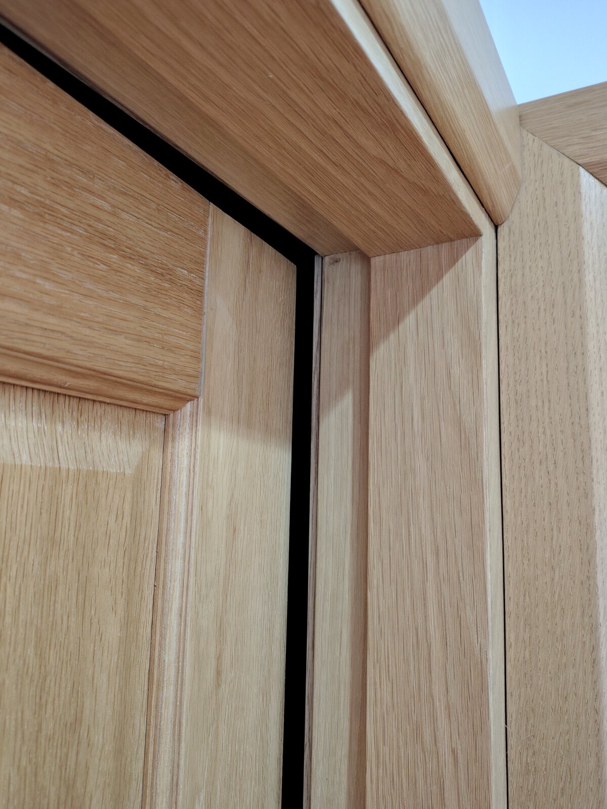

I did all the doors in my house and while I was at it I added oak veneer to all the door jambs. I used some hard floor wax oil reviver to finish the veneers

Here is the door I had to cut beyond the lip - you can see the carcass timber and also the pegs/ holes. But If I was bothered then I could add the same veneer that I used for the jambs to cover it.

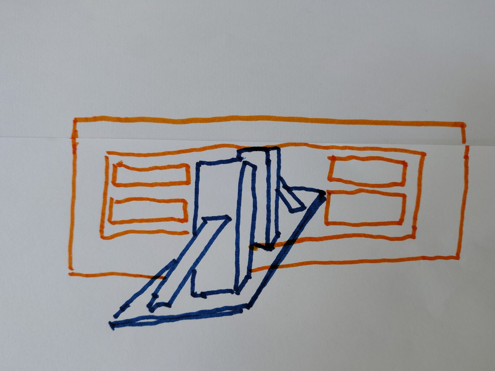

I built 2 door holders out of wood so I could slot the door in and work on it cutting in hinges and door catches or trimming.
This drawing show what I mean the blue uprights were covered with that green laminate floor underlay foam and the door slid in as a tight fit, I made 2 so there was one each end.
That's a good idea with the door holder, i might do the same as i'll have a few to do too!

You could get away with just one I suppose if you had wider upright posts or used ply so not "posts as such. But it was made out of spare bits I already had.
You need to protect the door though as it will scratch as you slide it in - maybe some carpet glued on
