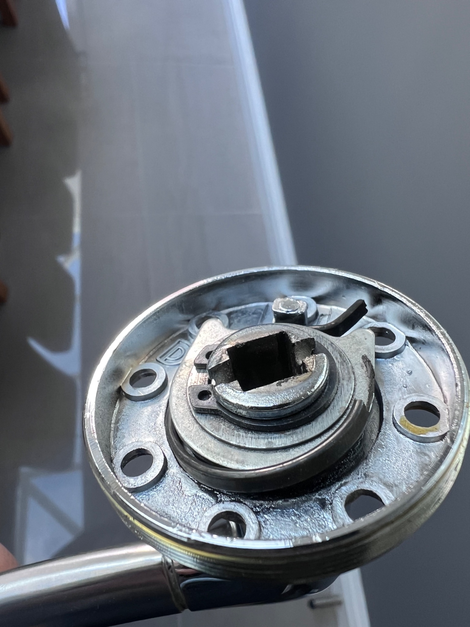

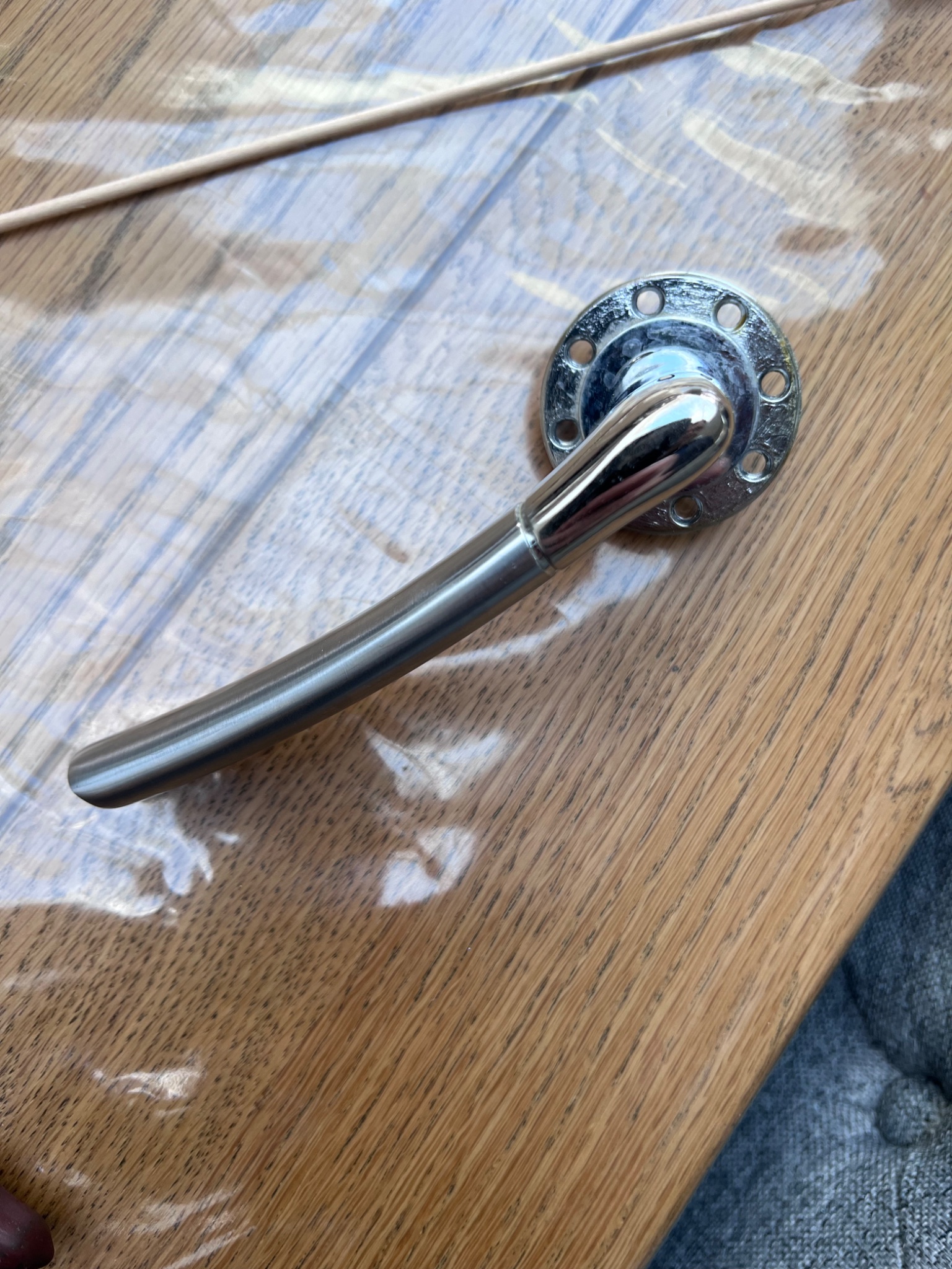

I replaced two sets of these door handles today. They were loose and just dropping down as opposed to springing back to the top position.
Upon closer inspection, I noticed that this metal ring was broken in both of them
Is this something that can easily be replaced or is it always a case of replacing the handles when this happens?
Thanks in advance.
You will need some circlip pliers.
Buy a new spring and fit. I just found a supplier online after searching.
