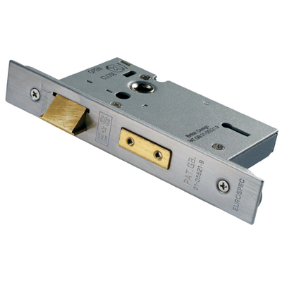

Those handles seem to be the correct type for fire doors and are certainly designed to be used with spindle/nut sets and the E*S (or Easi-T) mortise lock fitted should have either a drilling and a notch horizontally on either side of the spindle hole (as on this shallow lock body):
or there should be two drillings through the body (as seen on this full depth lock body):
The rose around the base of the handle will have two holes punched through horizontally either side of the handle - one of these will be circular, the other will often be hexagonal to secure the spindle/nut set. The handles can be a bit time consuming and fiddly to fit, especially the spindle/nut beneath the handle (towards the hinged edge of the door) which is difficult to get at, but failure to do this can render the handle useless in the event of an emergency as others have said. It is a common "pull" on bigger jobs where installers are trying to cut corners by using small screws instead of the supplied spindle/nut sets (and one that every QS and foreman knows about).
My feeling is that as the handle/rose sets would (should?) have been supplied with the appropriate spindle/nut sets the installer should be told to come back and rectify the incorrect installation
