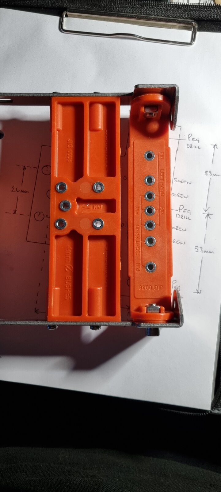

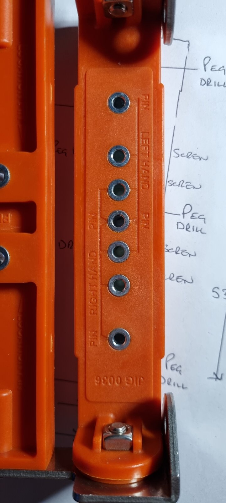

Here you go, the only holes you need to drill are for the pegs @4mm, don't drill the screw holes but use self drilling screws
My pleasure, for years I used to do them free hand and you were looking at an hour per hinge but with this you can do all 3 in an hour.

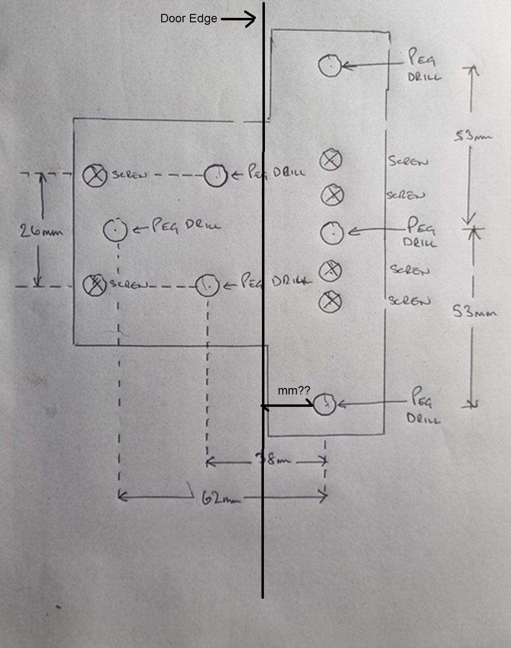

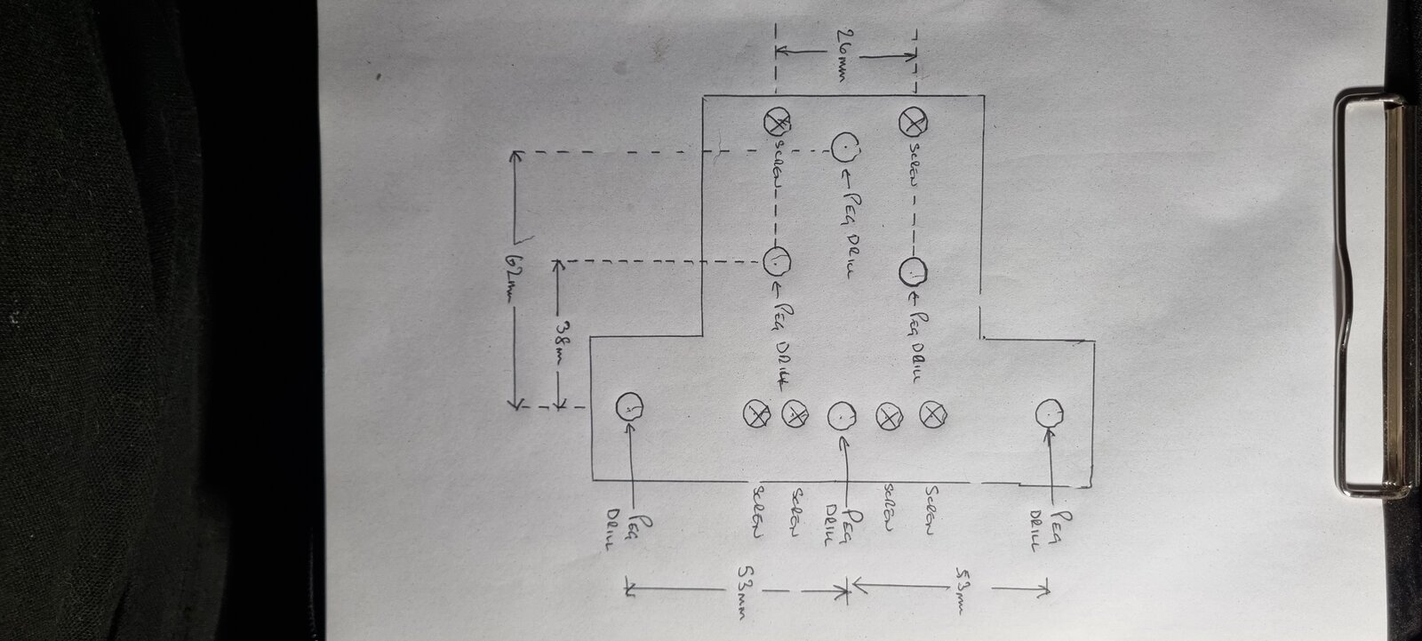

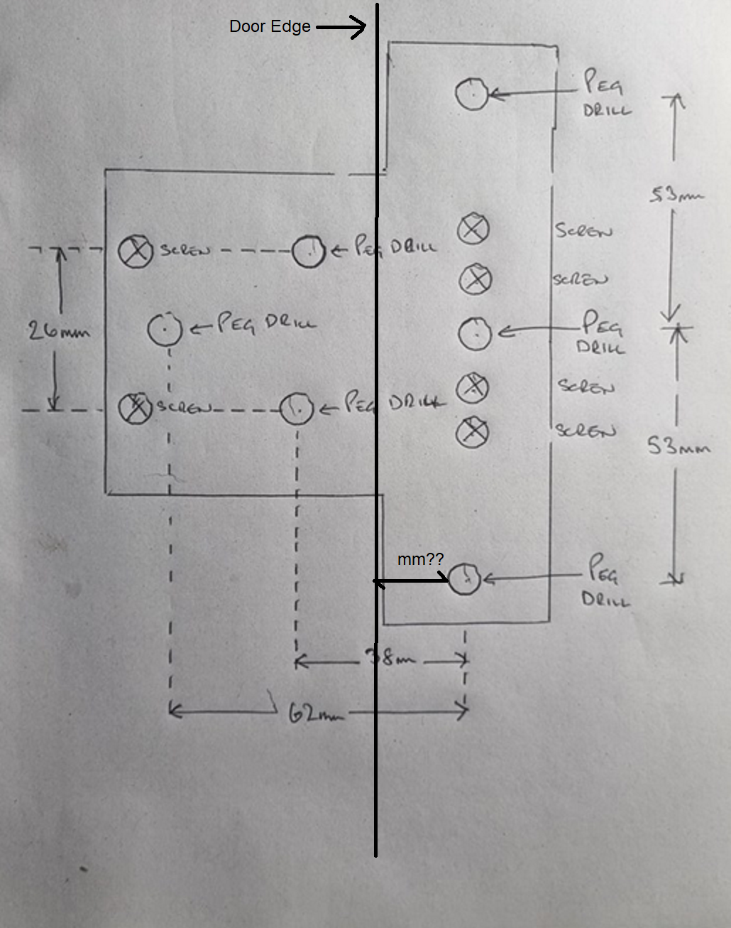

This is so helpful. I miss one measurement unfortunately.
What is the distance between the pin on the frame and the door edge as per the attached?
