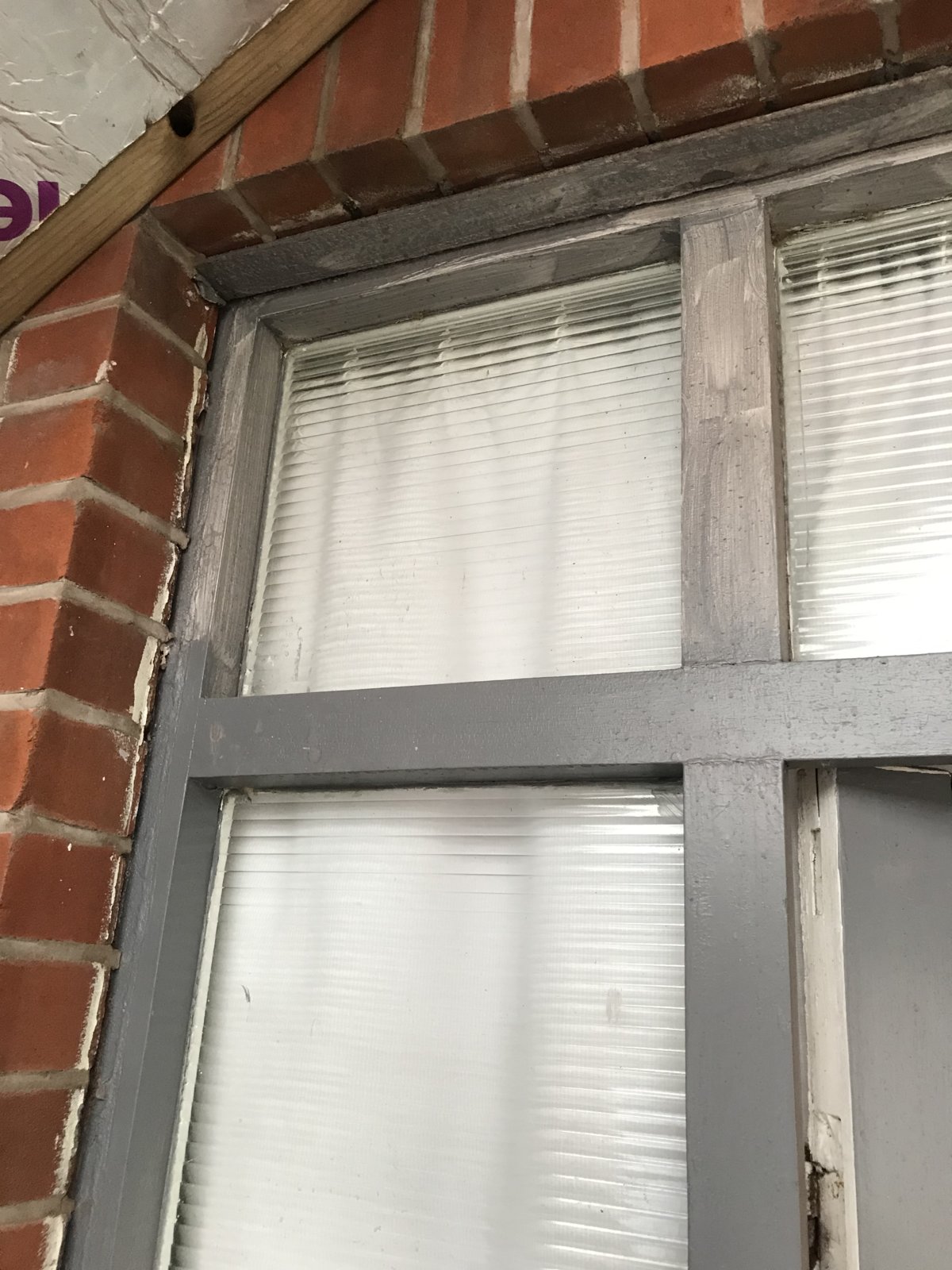

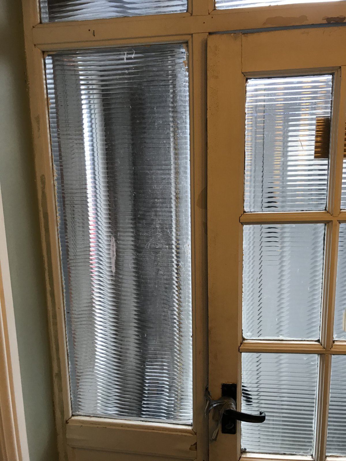

I’m looking to replace a rotten wooden door and side windows with a upvc unit.
It’s currently fitted into the cavity and is plastered on the inside. How would I go about measuring and fitting the new unit?
I assume that by cavity you what we would call a rebate. Well, on sash windows you would have to cut-back the plasterboard/plaster to enable you to get the old sash box out and/or measured-up and a new (or repaired old one) back in. Same applies here. Chop back a small area of plaster on one side until you can see the edge of the masonry rebate and measure from that to the glazing (not the plaster as that can vary). Normally you'll have the same depth of rebate on both sides and at the head so you should be able to work out the sizes needed.

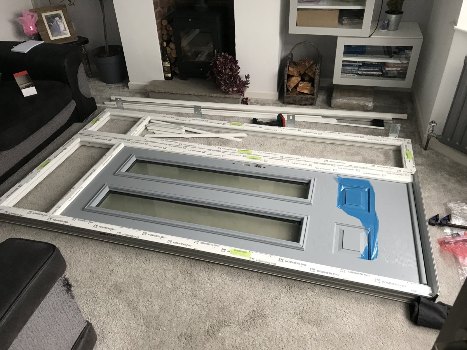

I’ve got the door now but struggling to find the straps. I’ve tried Windowplas and Eurocell.

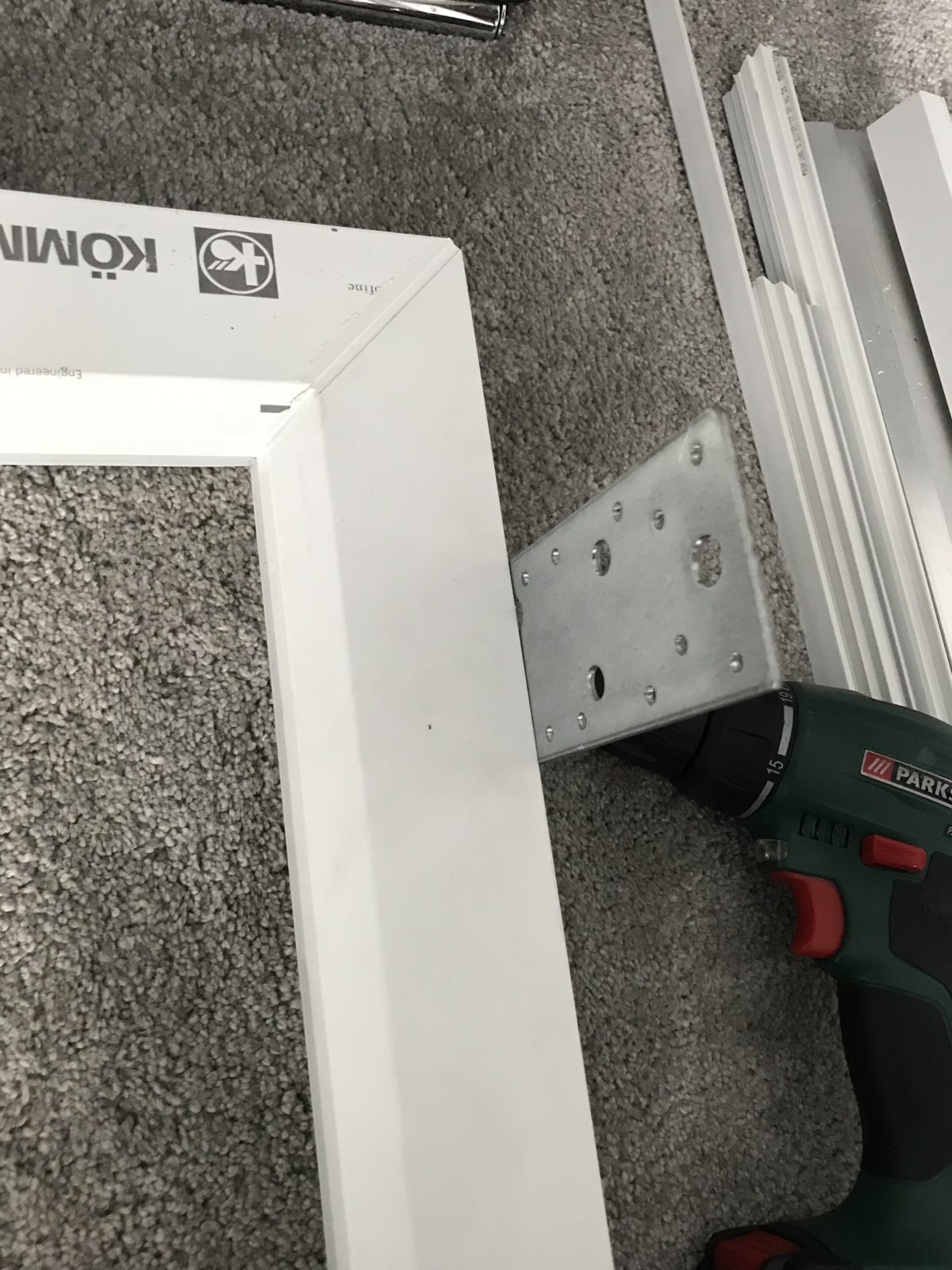

Other option is these from Toolstation:
Any good? And if they are is there a preferred screw type for fixing them to the frames?

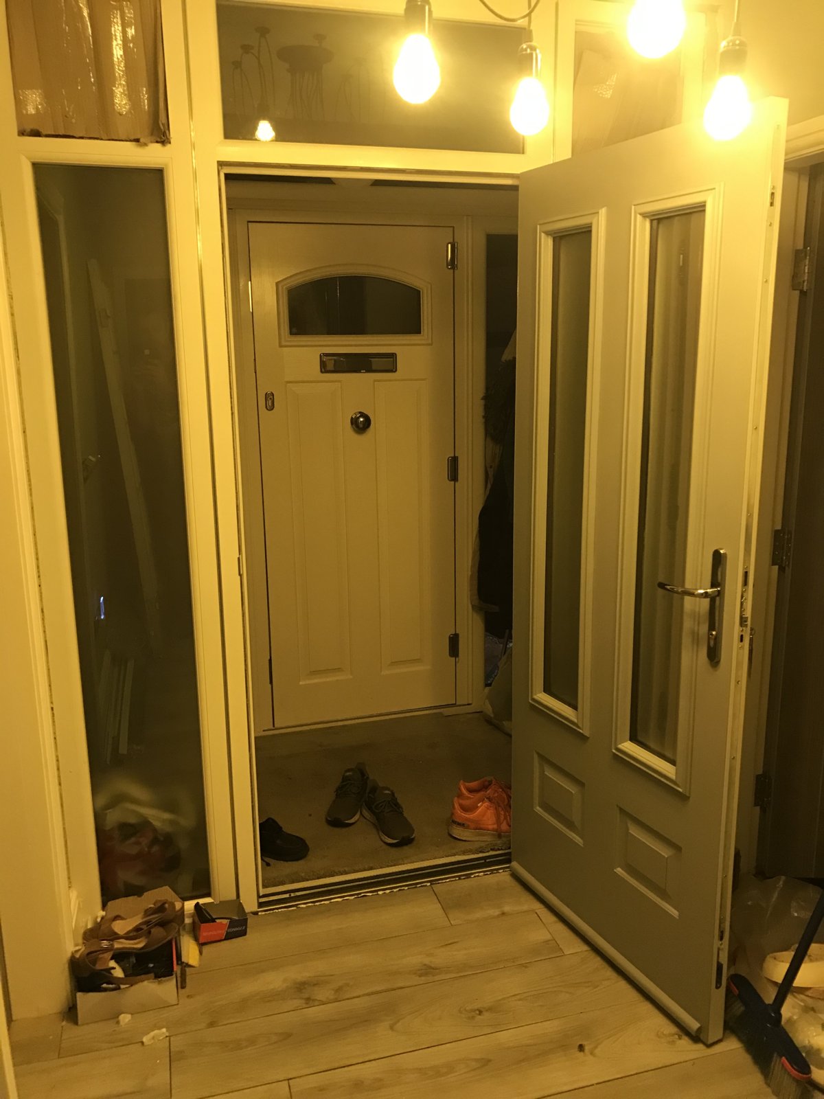

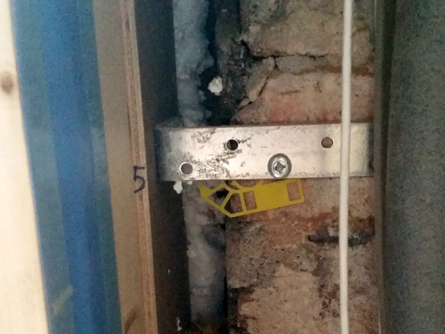

All done now and looks really good :)
I put 4 of them on each side, fixed to the brick then foamed the gaps.
The opening is 50mm wider on the inside. I didn’t notice that when I measured up!!
