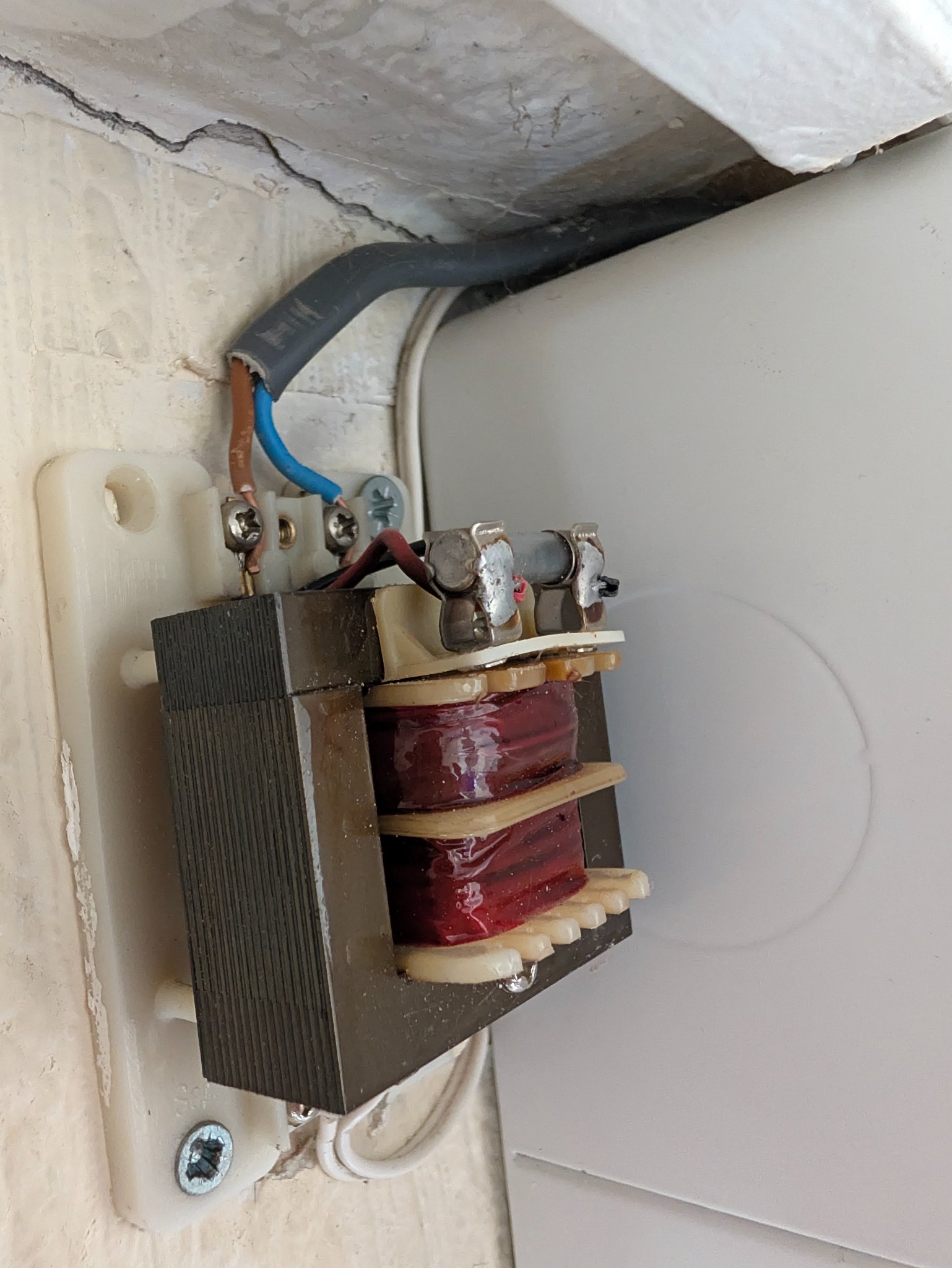

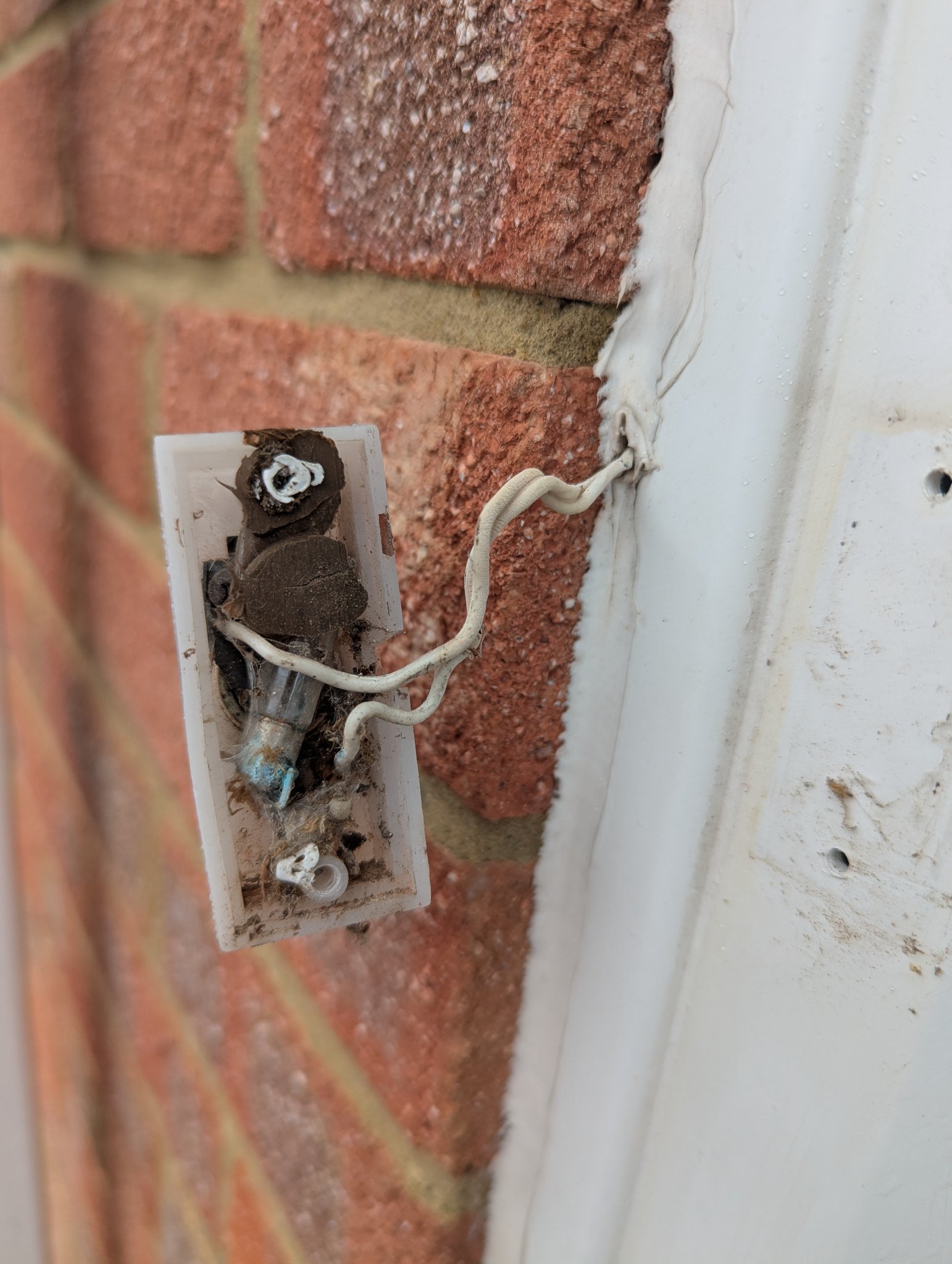

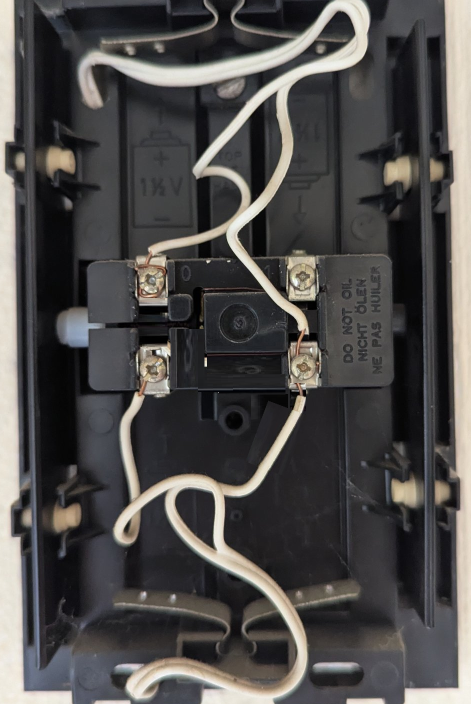

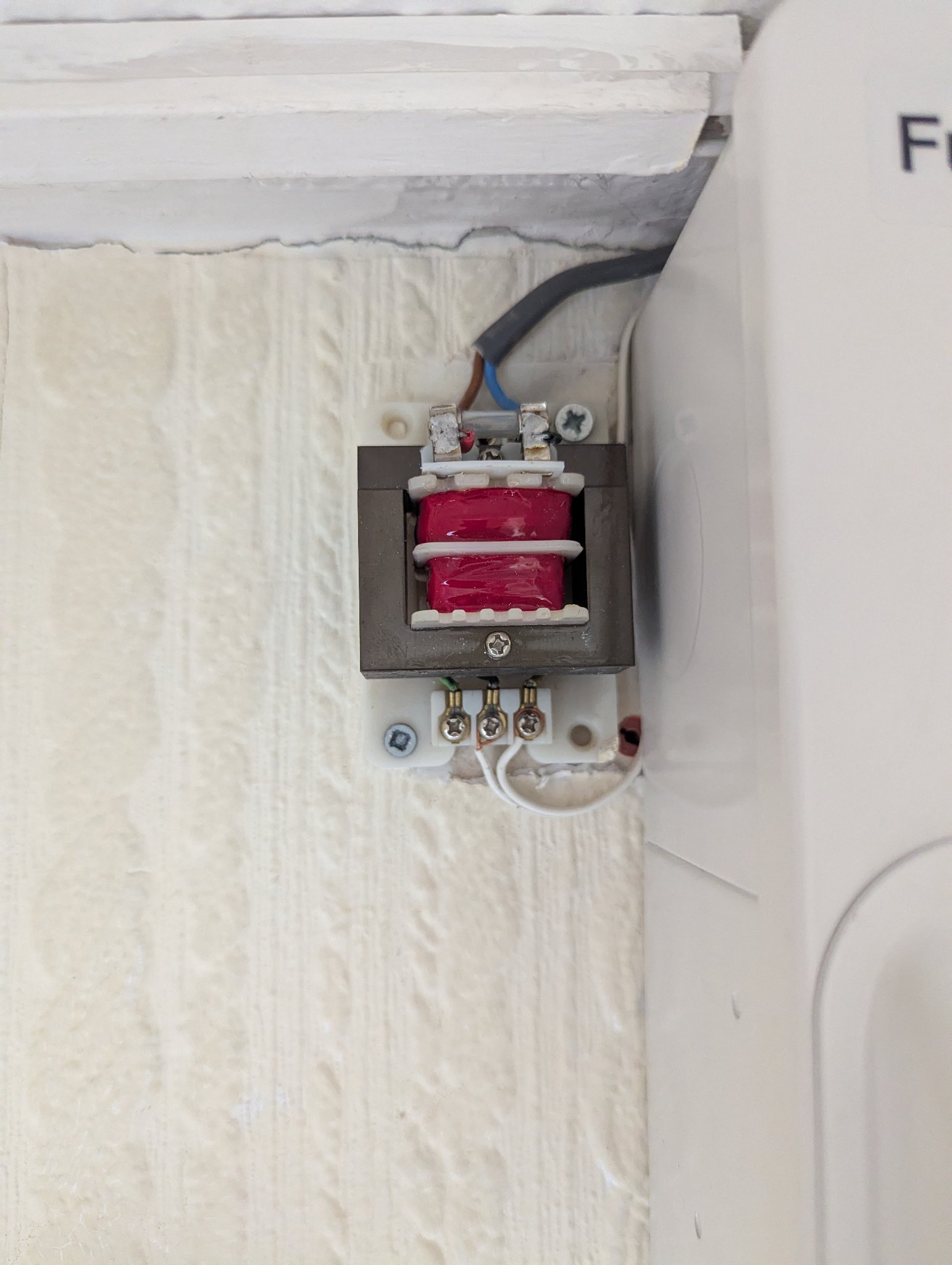

Hi all, recently tried to change my parents old manual doorbell to a reolink video one. As per instructions, I jumped the chime cables, switched the new doorbell and gave it a try. It didn't work so I reverted everything back. Only to find out the old doorbell now didn't work.
I then decided to purchase a multimeter to test the transformer. upon testing, there was no reading at the transformer (200v setting on the bottom terminals and 600v at the top/input).

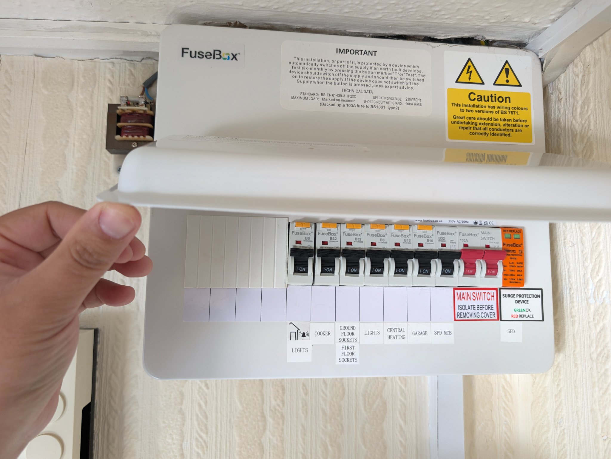

I've tried resetting the main fuse box (left one and entire board) but no improvement. Any ideas on what to do next please?

On a quick read you probably shorted the transformer and it needs replacing
I'm not too familiar but those video doorbell manuals i think do a "one size fits all " install method of shorting at the doorbell to bring a supply to front door which doesn't apply in all cases

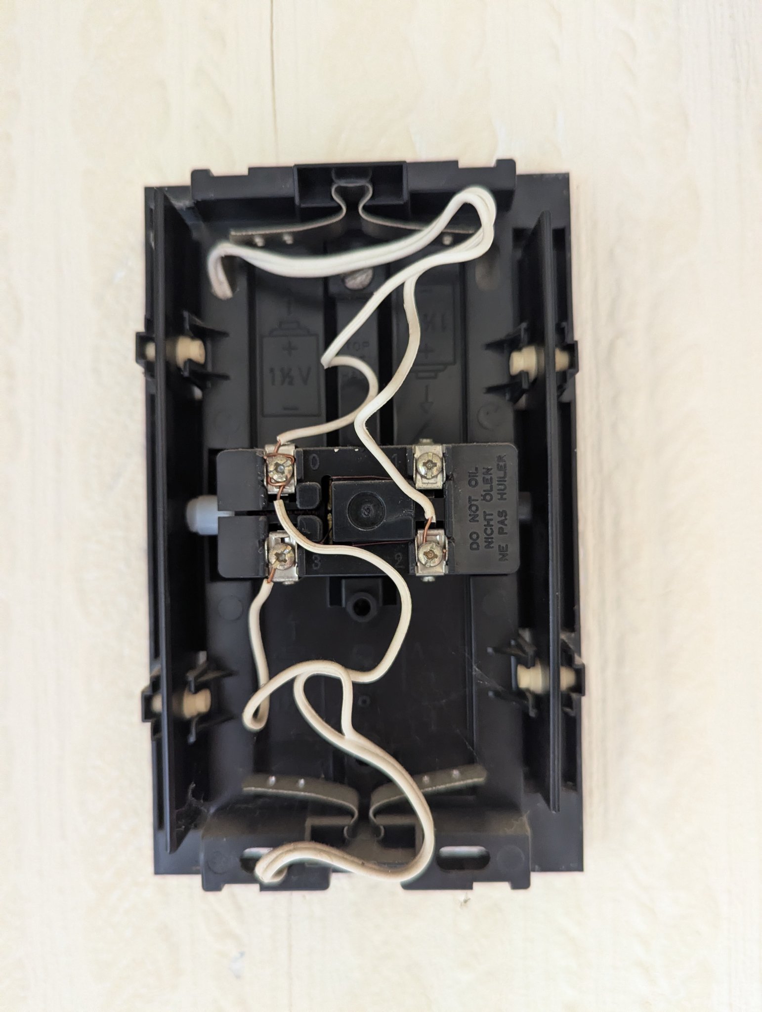

From memory 0 and 3 are the coil, and 1 and 2 are parking terminals if not using batteries and are to the door push when using batteries.
So one wire to 2 is wrong, with no batteries if 1 or 2 is used, it will have 2 wires.
So line 1 from transformer to 0 and line 2 to either 1 or 2 where it connects to one door push wire, and the other door push wire to 3.
The old doorbell worked on 6 volts DC and a higher voltage AC seem to remember 8 volts, been a while since used one. Most video doorbells seem to use DC and a higher voltage around 12 volts.

With the doorbell chime. I've just wired it to the original wiring when it was still working.

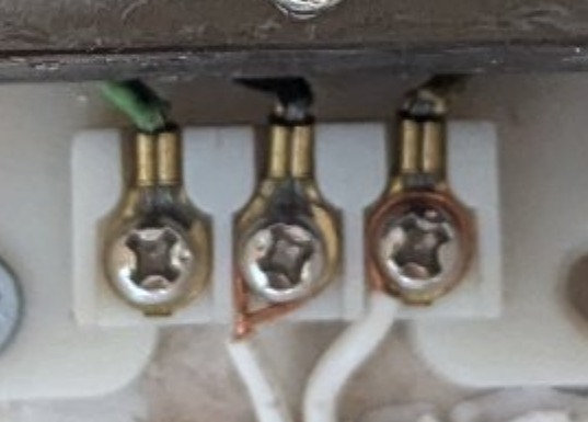

With the transformer, I will try and wire the middle white wire to the left terminal?
Will need to work out why multimeter is coming back with zero tho

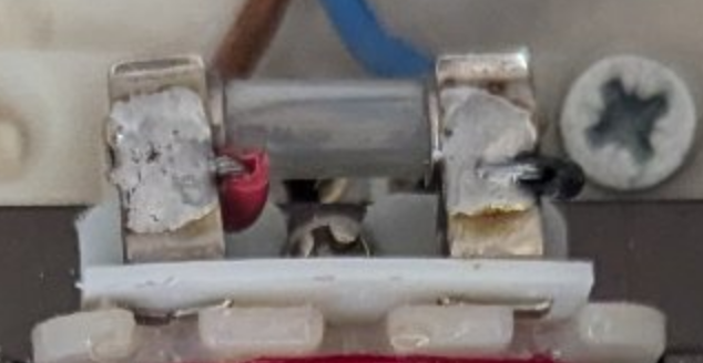

Well spotted View attachment 422188 looks like time to get soldering iron out.
No need for a soldering iron to replace a glass (20mm likely) fuse in a skeleton fuseholder... Ceramic sand-filled would be better for a mains fuse... if the same Amps and Time rating can be found.
Those may be stamped on the ends of the current fuse. ISOLATE the mains before touching that fuse though!!
Correct wiring:
However this will not correct it if the transformer has failed/fuse blown.

Was your meter set to AC volts?
Correct wiring:
Are you sure? I could have sworn the wrong in my photo was what's there originally (thought I had taken the photo before touching it).
P.s. mystery just solved. Realised multimeter AC was faulty - I did a DC check to see if wires were working but didn't actually check AC. Got it working now so will go back to site and test the transformer later.
But would be good to understand if the chimes wiring is correct

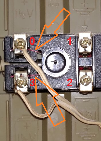

If you look at this pic - but ignore the moulded numbers (I've added your in red) and white wiring as it is used differently to yours - you can see the copper solenoid wires arrowed.
If you can see the copper wires in your chime and they are not going to the same locations arrowed then feel free to come back and ask again.

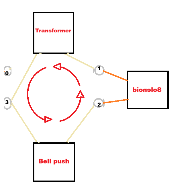

What you need to achieve is is a closed circuit which the current can flow round, like this:

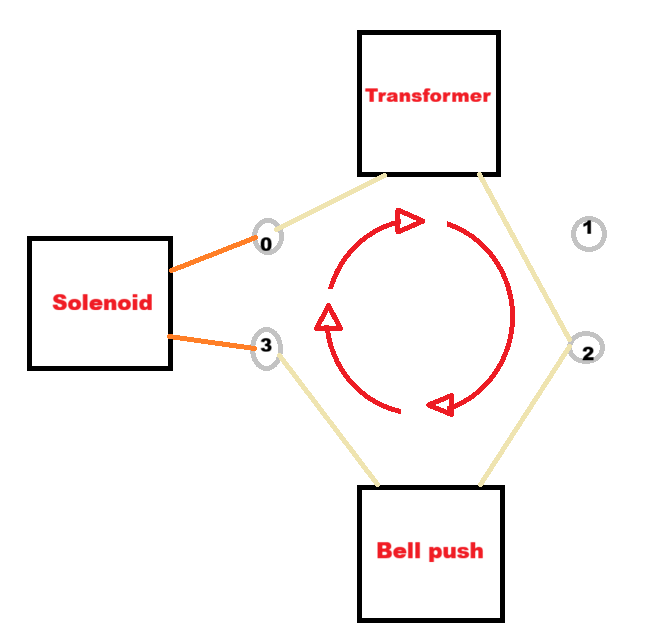

It doesn't matter if the transformer and bell push are transposed or where each of the 3 components are within the ring, for example if you find the solenoid is unusually on terminals 1&2 is will be something like this:
