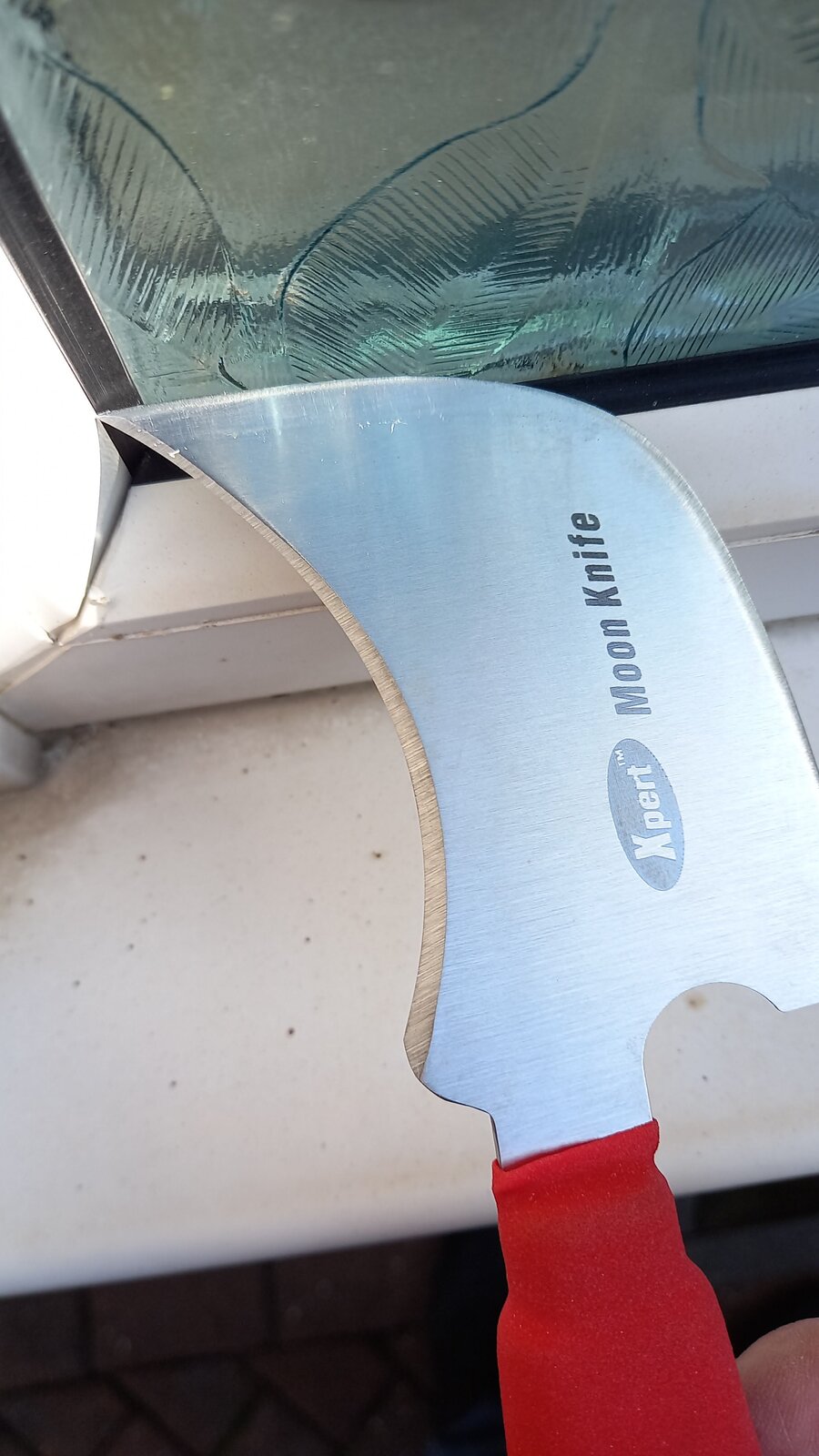

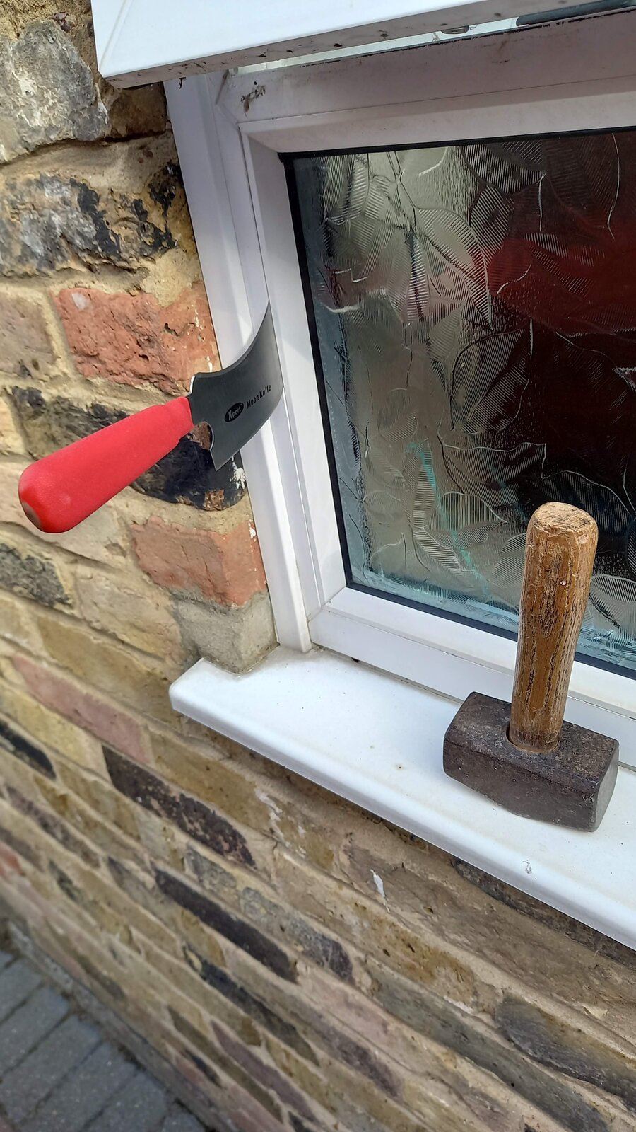

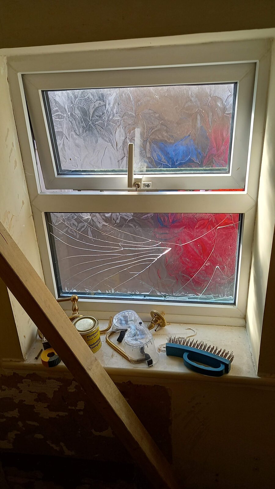

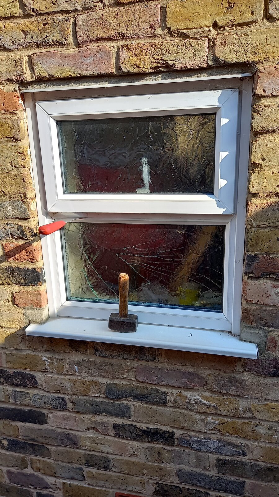

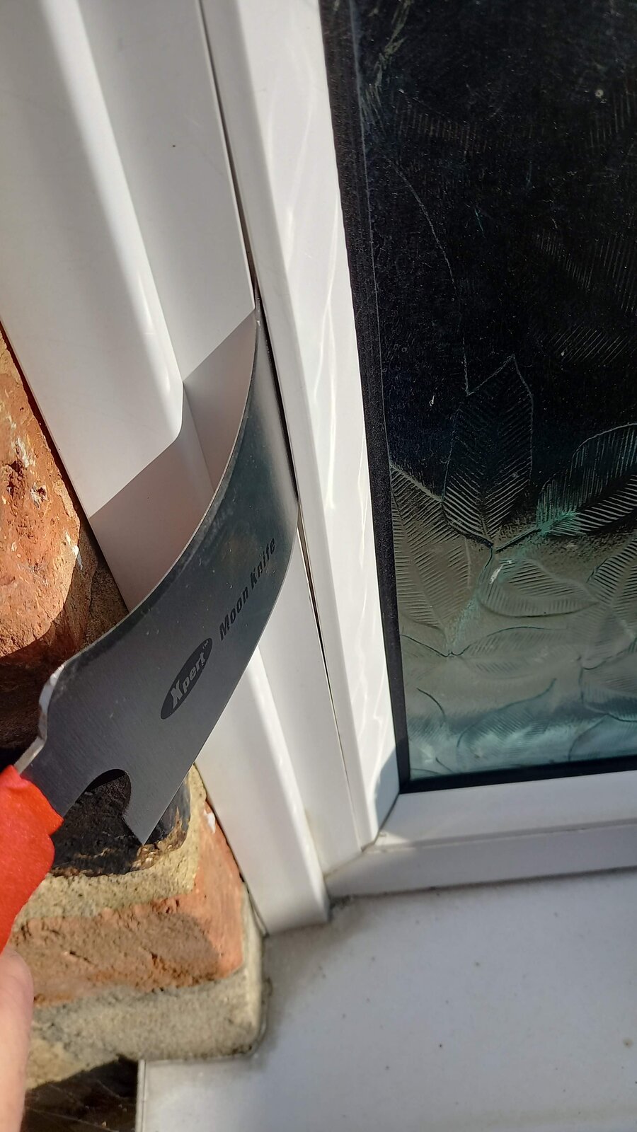

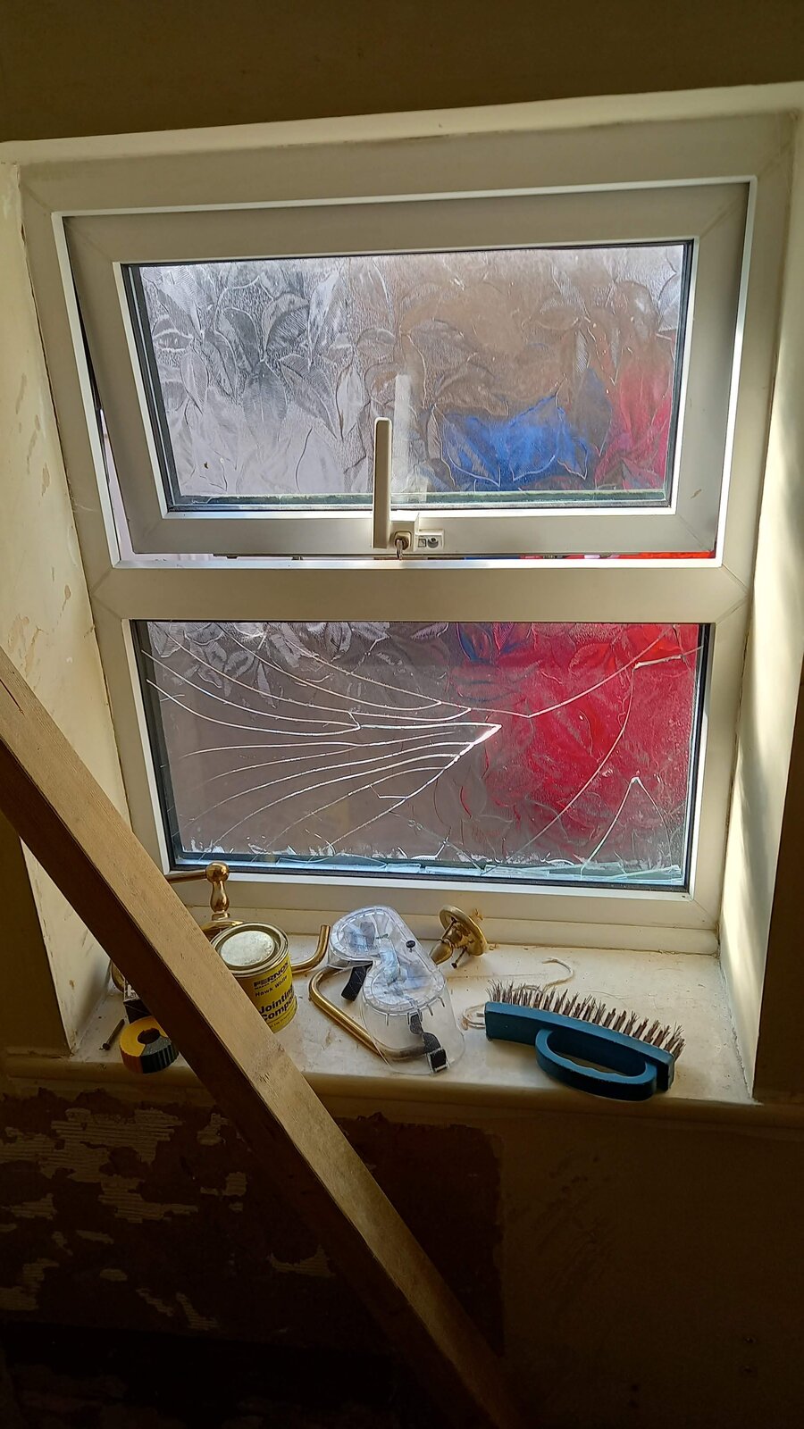

    I am failing to remove the bottom broken window unit from a double glazing window. The youtube videos make it look dead easy. :mrgreen: I bash my Moon Knife as hard as I can and it only goes in about 5mm. Flexing the knife at that point does not persuade the beading to pop. What am I doing wrong? :(
    20211009_144843.jpg 20211009_144101.jpg 20211009_143810.jpg 20211009_143554.jpg 20211009_143446.jpg
    Thanks in advance.

    Have you tried the middle of one of the longer sections? I would expect them to flex more.
    I have only ever done it once. I used two thin japanese cat's claws. I was able to apply pressure at two points near each other. Not sure if it makes any difference, but I think I used them in the opposite direction to you.

    Silly question..... have you removed the wedge gasket on the inside yet? That's an externally beaded frame and from what I can see you need to pull out the black gasket on the inside of the house , sealed unit should then push back.in and beads pop off really easily

    Sending you virtual kisses! :LOL: That was the vital bit of knowledge I didn't have. Once the inside gasket was removed the outside beading popped off like a dream. I was able to remove the window unit and measure it for a replacement. Presumably when I get the replacement I pop the outside things on first and then fit the inside gasket? That looks like it could be a fiddle.

    Yes , Replacement is reverse of removal, so glass in , beads in , go inside and push glass out and them liberally spray around the edges of the window with window cleaner , makes putting the gasket in much easier, if need you can use the handle on a hammer or something similar to push the gasket in
