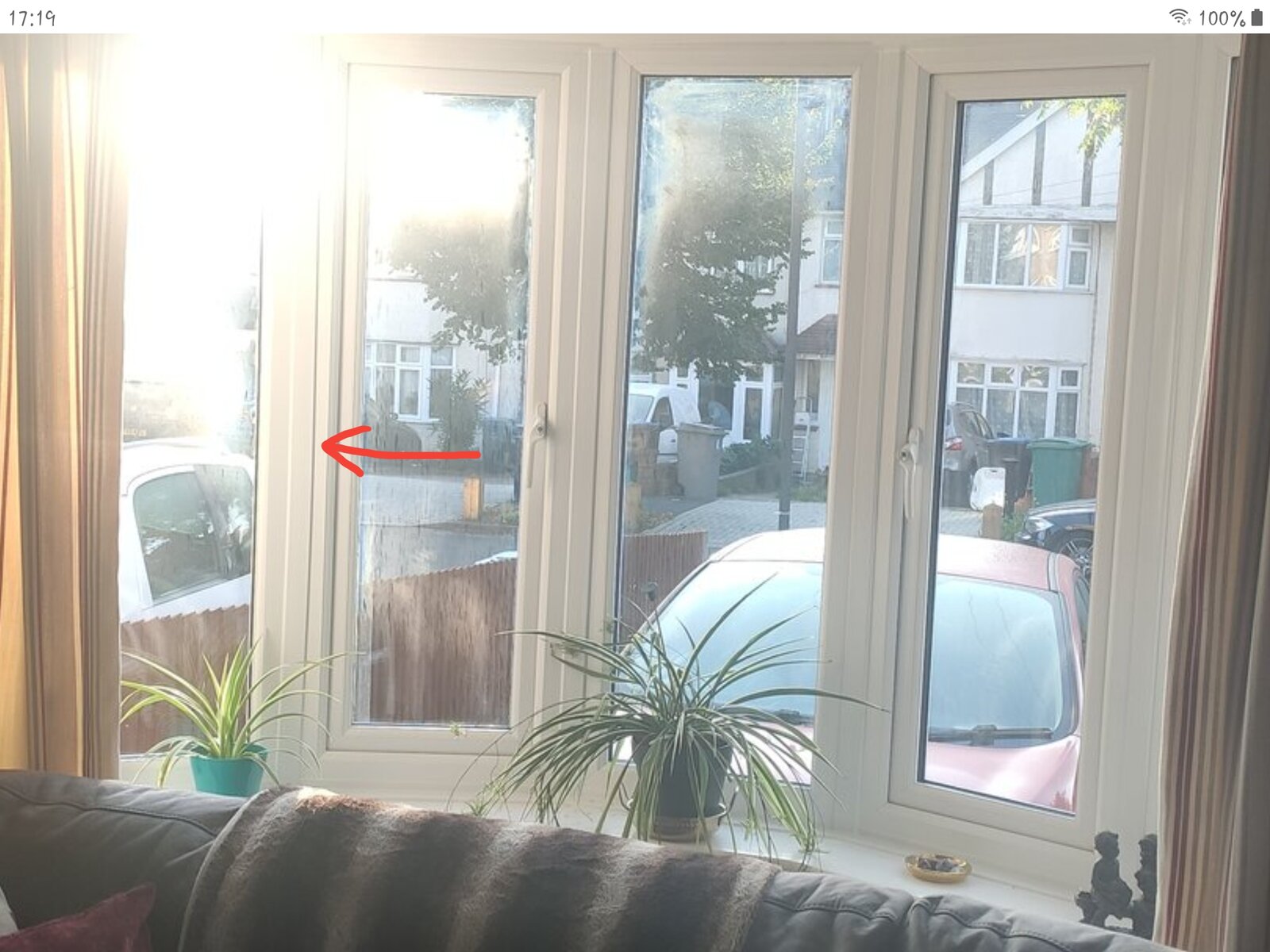

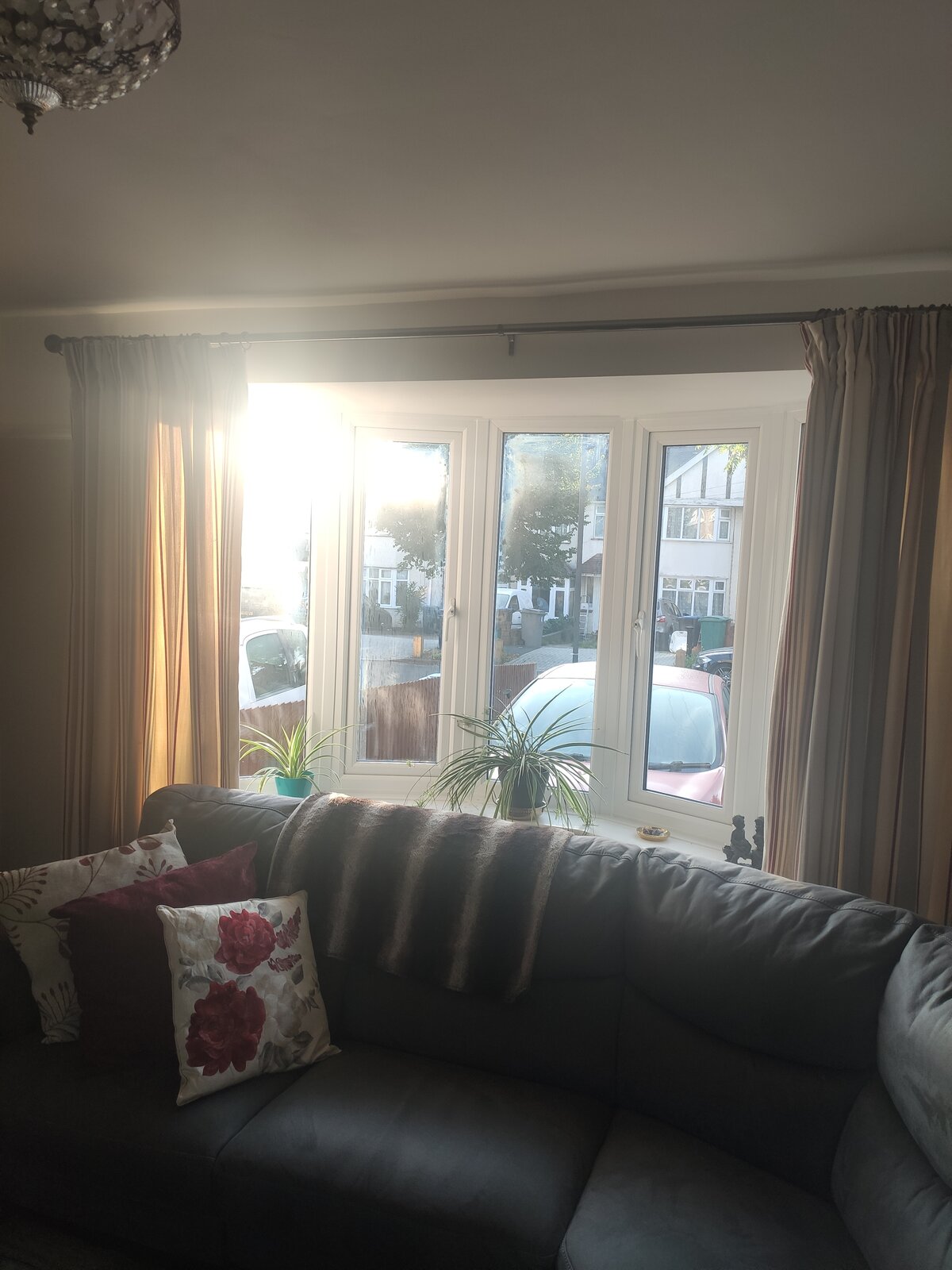

Hi,
I hope someone can help me. I recently had new double glazing installed but I have noticed 3 of the windows has a rainbow discoloration in the windows. It's mainly visible first thing in the morning. I have informed the window company and they said it is "normal as it’s just the gas adjusting to the temperature". Is this normal or am I being taken for a mug? I have attached a picture but its not that clear, sorry.

You're in the right place, it's difficult to see what your pointing to here, all I can see is the middle pane and the one to the left of it look very smeared like a contaminated rag has been used to clean them and also the sun beaming through, other than that we need better pictures or some arrows pointing to what and where you mean.
That said there's various phenomenon you can get with glass especially double glazing, there's an effect called 'Brewsters Fringes' that causes a rainbow effect when two pieces of glass are in close proximity, something to do with wavelengths.
I'd like to know what they're talking about when they say it's the gas adjusting itself to the temperature lol, I think they're clueless themselves and are fobbing you off, if the units are argon filled then the gas will have all escaped anyway within 3 years.

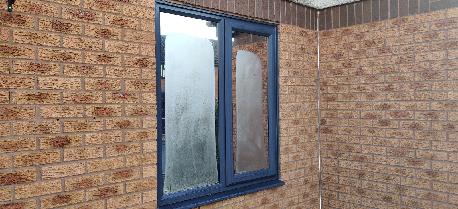

There's also a phenomenan only seen on A rated glazed units where the outer pane steams up in the morning, it shows the glass is working as it should not allowing the heat in the house escape through the glass and heat the outer pane, the outer pane has been isolated from the inner hence it's colder and condensation forms on it, here's my own A rated windows in morning dew
Ask yourself how many of your windows face that direction and why is only three windows out of x that show this rainbow if it is the gas (which I dont believe for a second).
As for the gas adjusting to the temperature ask them for some literature on that or supply links that you can read on the internet, ask them if its the gas why isn't affecting every pane and the best yet is will they all look normal in 3 years time when the argon has all leaked out
