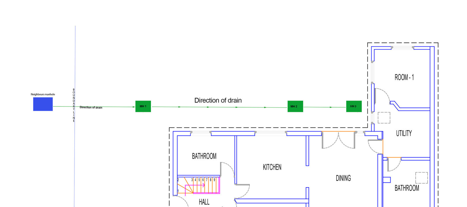

Thanks @frutbunn I did a quick pic of existing, (Im no expert so I hope it makes sense). The new extension would come from back of house, so MH1 will stay in situ outside, MH2 will move and MH3 would be inside with a doubleseal (MH serves the rightside bathroom and utility). As it's shared with the neighbour I gather that means it's public.
The previous owner concreted everything in, so I would need to dig up my daughters room, utility and bathroom to move MH3.
All of my projects come under TW and based on the information you have provided, they would not accept any internal manholes. Where does the drainage go once it has left MH3, in a straight line to another neighbour?
Thanks. M3 then goes under the house, out to the front garden drain and then the main public sewer. Its only shared with one house.

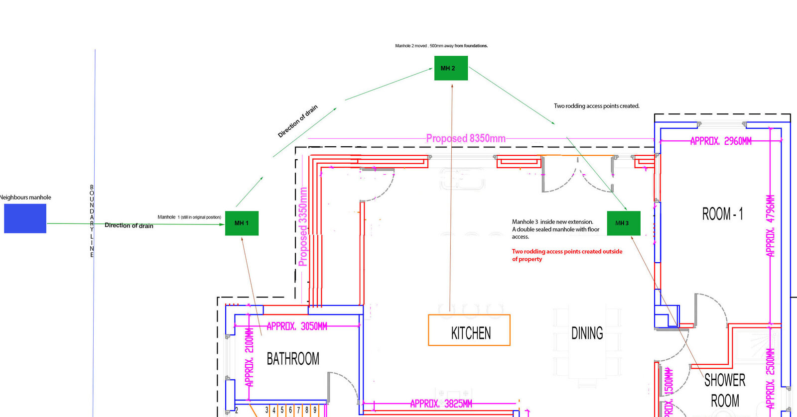

This is the proposed, sorry again if it's not great.
Im not sure what my options are. Wouldit make a difference if the right side bathroom was gone, so nothing was using MH3?
That is some diversion!!! I don’t think TW would even entertain that. Do you have a block or site plan so we can assess it in a better context?

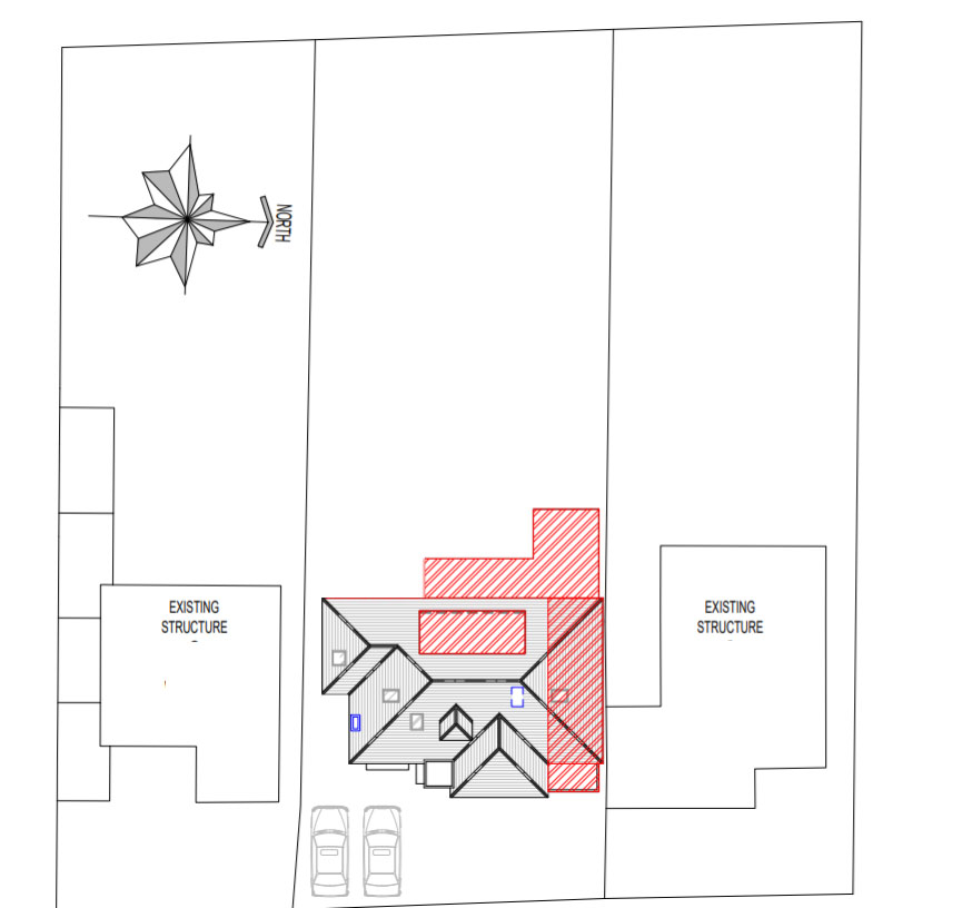

Does this help?

How would it work then if it has to sit outside the extension? Maybe I have done the disagram incorrectly, but that is where MH2 would be relocated, so it goes around the outside.
What is the distance between the existing side wall of Room-1 and the boundary? Does the neighbour on the right hand side have a manhole just inside their boundary?
