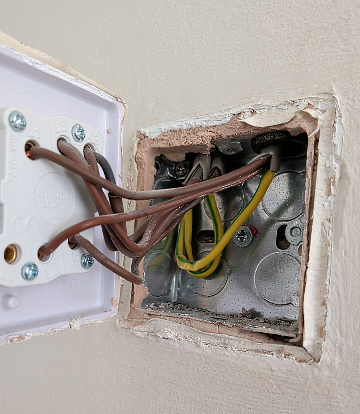

Hi again guys, you've been great getting me through my switch issue that I put here
I've wired the switches in and have a downstairs and landing switch working, plus a bathroom switch that feed a dimmer....all working
One issue i can't seem to fathom, if I turn the downstairs switch for the landing light on I can't use the upstairs switch to turn it off and vice versa....the upstairs one can't be turned off by the downstairs.....I havent touched anything in the downstairs switch at all, the landing switch I have just swapped to a new 1 gang 2 way...any ideas what this might be?
The old switch is this
And I've connected it to the new switch like this
L3 old switch to COM on new,
L2 old switch L2 new
L1 old to L1 new
The L1, L2 on the furthest left are to the bathroom light and all working fine so I'm guessing the issue is the 3 above somehow
Im at my whits end and I wonder if anyone can shine some light on this for me before I fully admit defeat.
Here's what I've Got at the moment
1 x upstairs 2 gang, 2 way switch which controls the landing light (controlled at the bottom of the stairs with another switch) and bathroom light.
I'm wanting to swap this for a switch (for the landing light) and a dimmer for the bathroom spots (don't ask why the misses was moaning it was too bright and didn't take my suggestion to wear sunglasses very well)
Having taken the switch off I have the following on the old switch:
2 x twin and earth...
