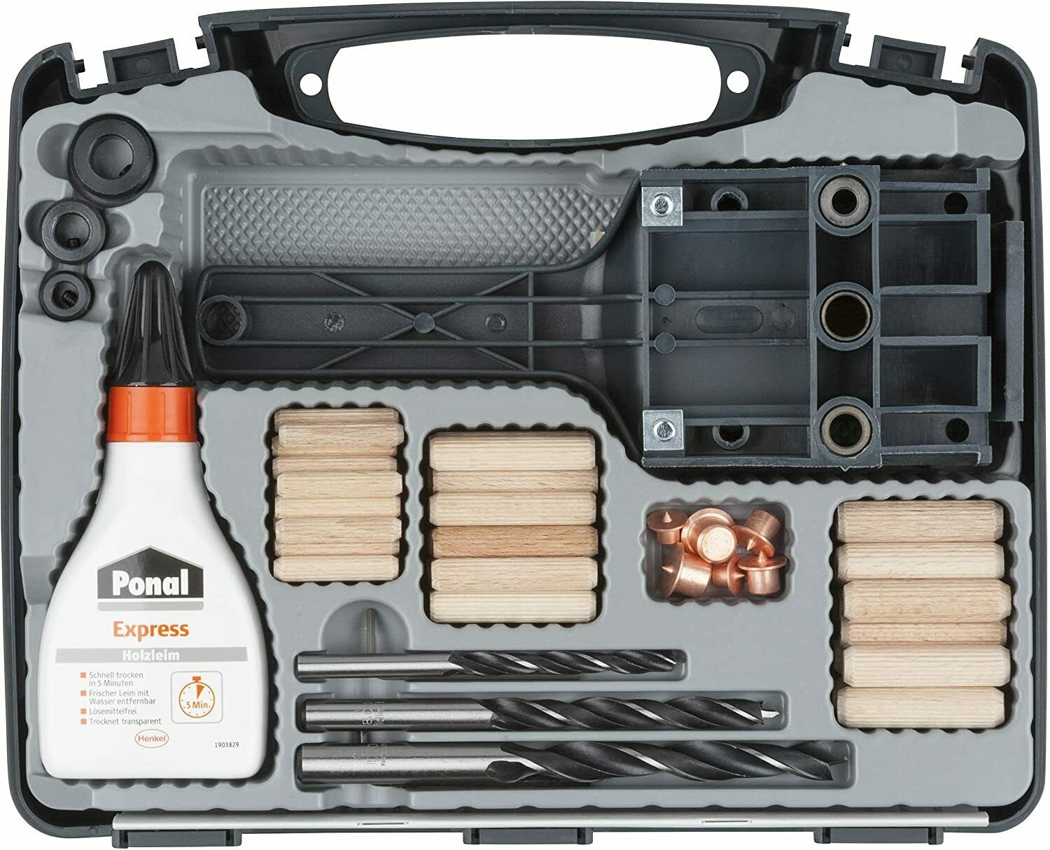

Hi I am PLanning to build a small shelf unit; a bit like a small open backed bookcase - so shelves with a frame. Was going to use dowels instead of screws, which I would glue. But should I also add glue to the whole edges of the shelves, rather than just the dowels, and then clamp? Presume there is no point in using screws as well as dowells. Thank you
glued edges are pretty useless
A dowel jig is tremendously useful for centring and aligning dowels. use plenty, you are not a factory trying to save fractions of a penny. Drill the holes slightly longer than the dowels to accomodate any excess glue.
mine is a Wolfcraft kit, rather like this
you can buy extra dowels and glue cheaply.
