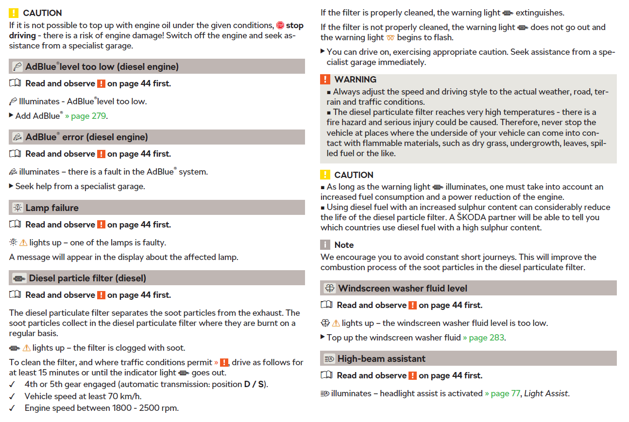

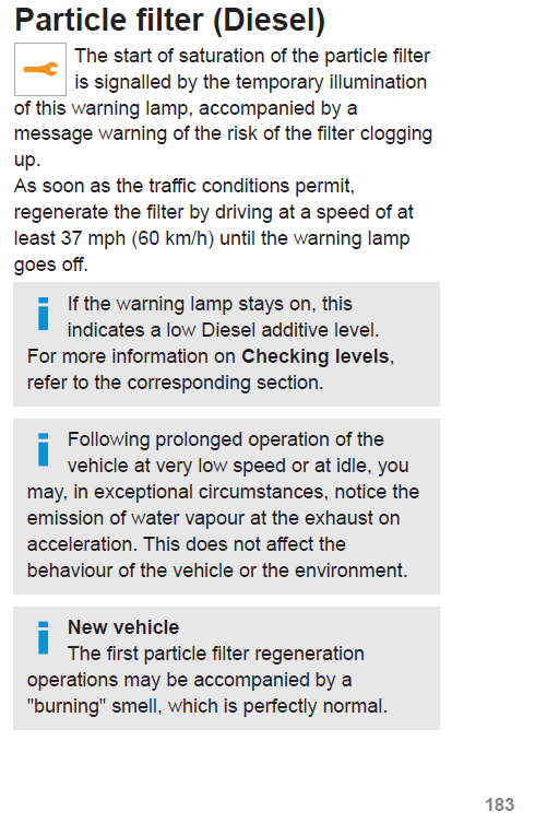

I think they'll start if the run out of Eolys. They just soot-up the DPF. They won't start without AdBlue, because that's a legal requirement.
