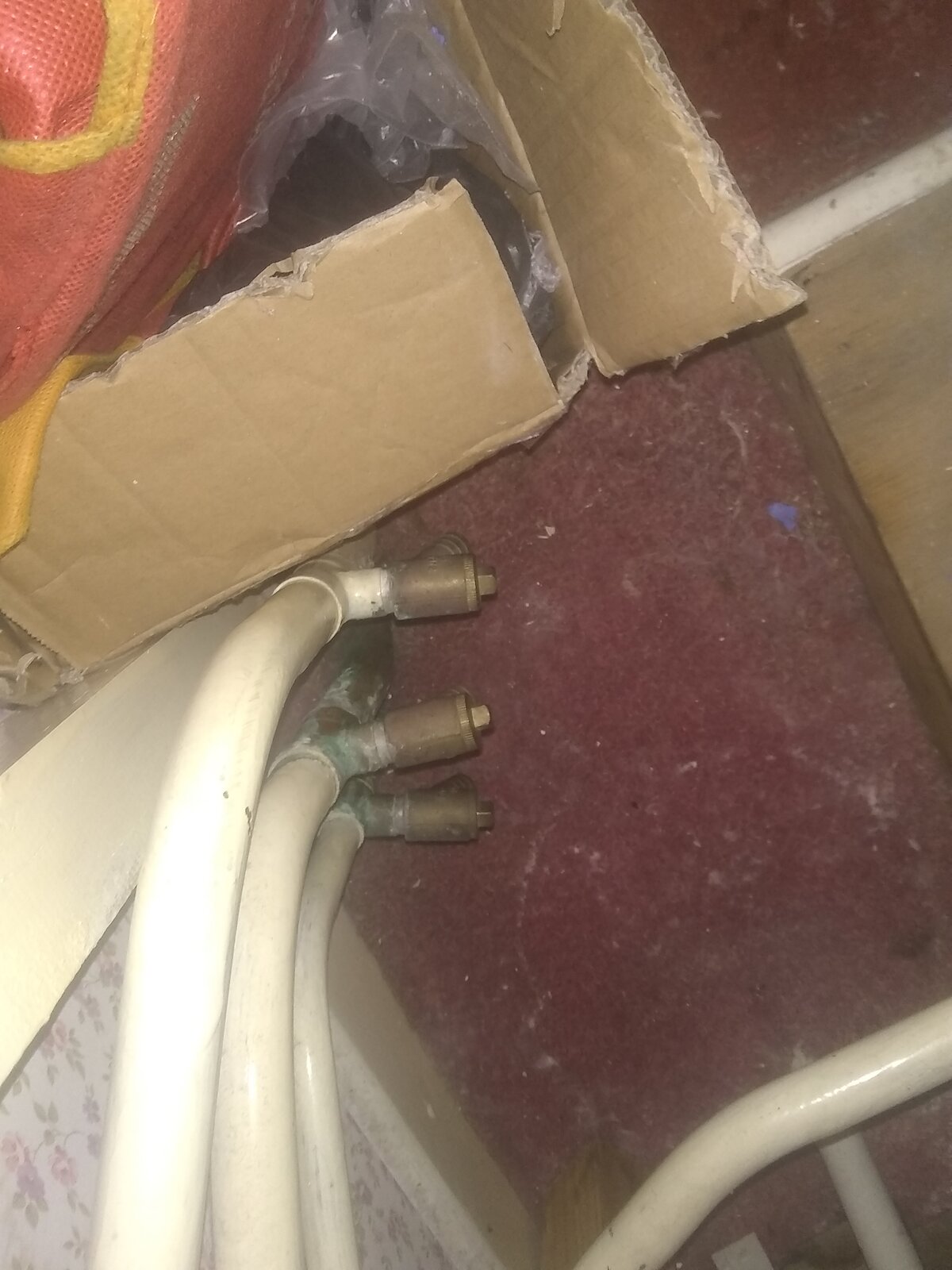

Hello I need to empty an immersion heating system and require a tool to open the draicock, pic attached.
What tool do I need?
No special or specific tool. Adjustable spanner, open ended spanner of correct size, or utility key.
Yes, everyday garden hose, or there are better ones.
Don't expect water to come out when you open the cock, don't expect it to stop weeping once you're done.
Watch some youtubes.
