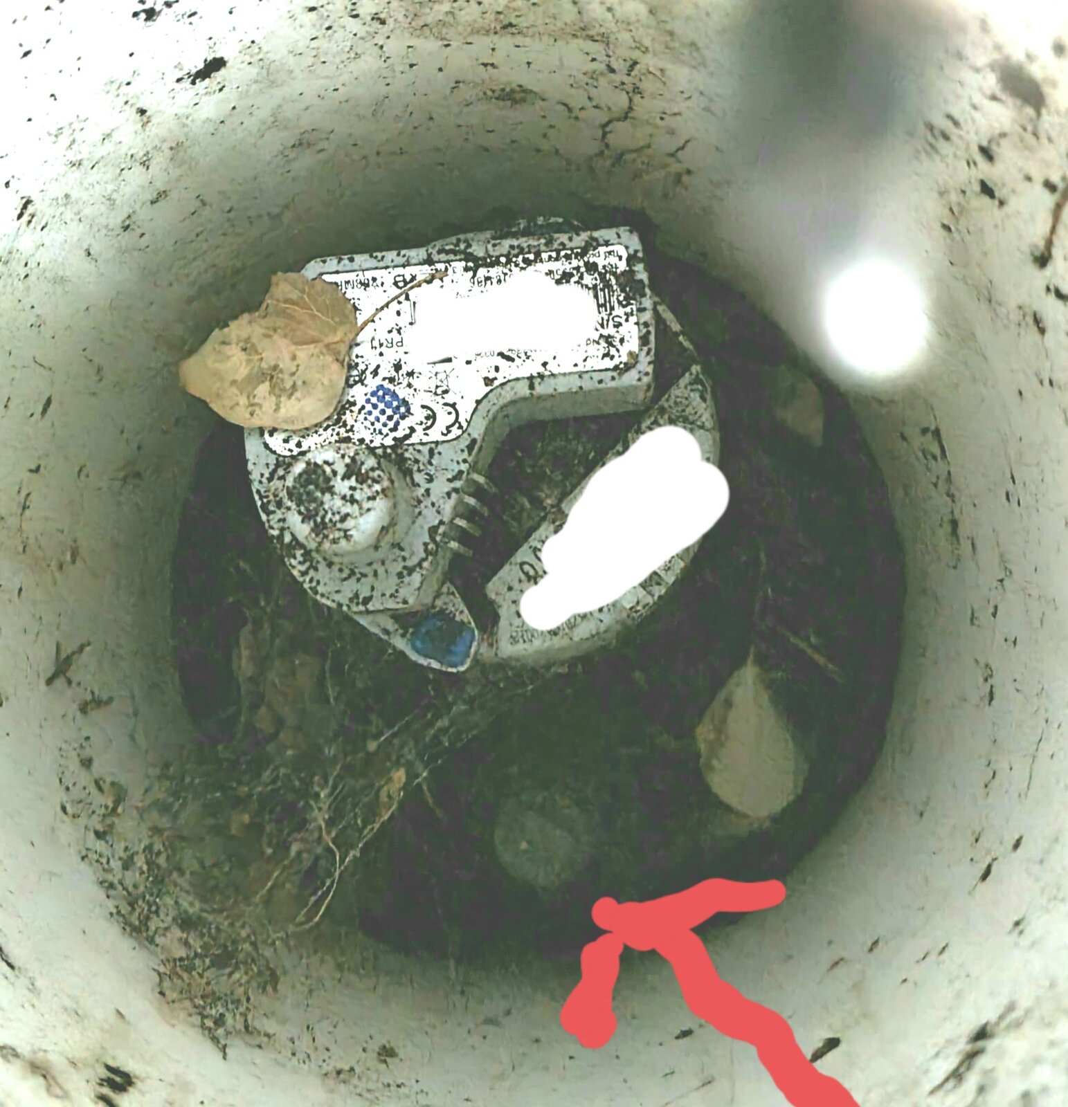

Looking for a tool to turn off my water at the street.
The meter and stop tap are helpfully buried ~1m deep in a tube in a hedge.
I've taken a photo (sorry for the quality).
Can anyone identify and suggest a tool? There seems to be a variety of tools available for different stop taps.
When lying on the pavement, elbow deep, I can brush the top of the meter and can't get a feel for what size I need.
If it makes a difference- it's South East water.
Many thanks
If it were me I'd bodge a tool from a couple of steel strips/angle-iron.
It looks like the valve incorporated in the meter.
When I had one, it was installed with a blue plastic handle
Which is removable, so you can take it off to prevent interference
Or, I suppose, a neighbour or other person could pull it off and steal it
The water co might sell you a replacement.
I currently have one of these
https://www.screwfix.com/p/rothenberger-stopcock-key-920mm/71652
The steel head has two square sockets of different sizes, and a "crutch" to fit a T-handle. The large T on the top gives plenty of leverage.
