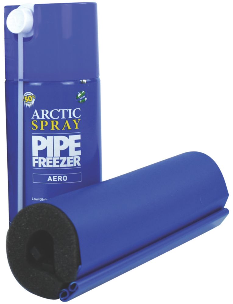

One of these and a new lever valve:

No huge hassle for us we have both electric and co2 freezing kit.
Just for reference most hire firms have electric freezing kit probably better option than gas if your a diyer.
Cost normally around £40 a day

1. Use an electric freezer. If you can, use two freeze heads at least 12 inches apart.
2. Let the freezer run until it says -30 on the heads or display. And there is frosting on the pipe half an inch or more either side of the freeze head(s)
3. Turn on the kitchen cold tap. If no water comes out (after the run off from higher pipework) the freeze is good.
4. Provided there is no power failure, you are good for as long as it takes.
5. If there is a power failure, you are good for about 15 minutes. Plenty of time to cap it or put on an isolation valve.
6. Have a decent isolation valve ready to go on. Full bore lever operated one.
7. Don't put the freeze head too near where you are going to cut the pipe, or if you have to, get rid of any residual water between the cut and the head. Otherwise that water will freeze and make it difficult to get a fitting on.
