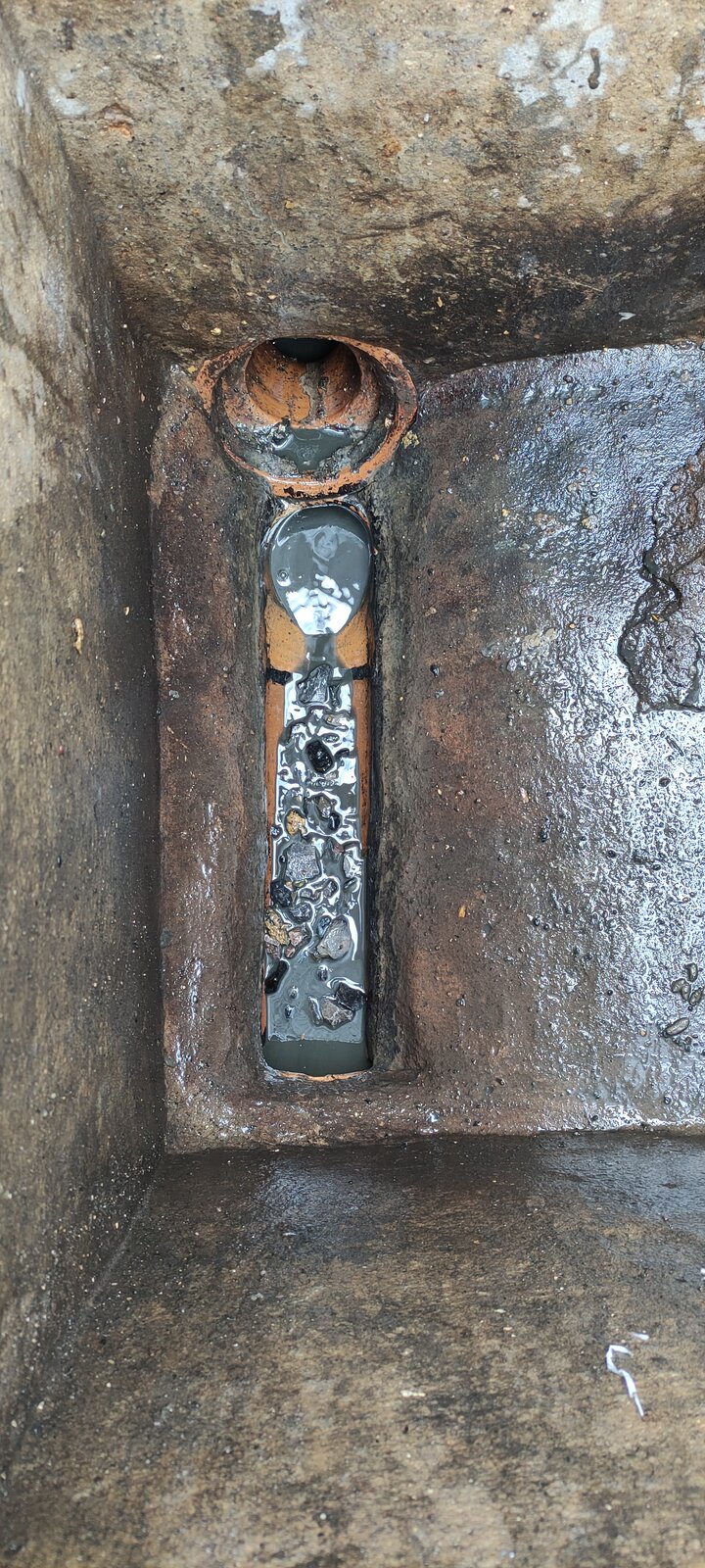

I have a reacuring sewer blockage, always happens in the same place. I've had a camera down and there seems to be no breaks in the line. I have (Hopefully) attached an image of what I belive is a problem.
The pipe hole at the top is the main drain, there is also a hole just infront of it. When water goes down the sewer on my property it has to fill up the 'gutter' part before it goes over the lip to the main drain, this causes my line to back up which in turn slows down and compacts 'solids'. This eventually blocks my sewer pipe. The top of the main sewer lip is above the top of my sewer pipe.
The hole in front of the main sewer hole feels like its a dead end but is full of stones (And the odd screwdriver!) some of which I pulled out and you can see in the gutter part. Does anyone know if this is some kind of debri catcher? Or maybe a proper connection to the sewer? If it was the later then all the water would flow correctly and not cause a blockage. I feel like cutting away the lip on the main sewer line to lower it and let water flow correctly.
Any advise would greatly be appreciated.

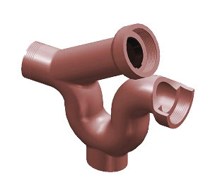

This is how the pipes are arranged the top pipe is not intended to be used in normal service and should have a bung in it ( often lost during drain cleaning) You need to clear the lower u bend to avoid constant blockages .

Laurieo : Thanks for the insite. The three houses that are connected have all had extensive renovation (Two are pre ww1 built). Over my time here I found all kinds of builders waste blocking it up, I persume thats where the hardcore comes from. I've put a camera through my part of the drain and didnt fine any breaks, but that doesnt mean there are breaks back up the line.
foxhole : Perfect, exactly the diagram I needed! Thanks very much. Now to work out if I have to clean it or I can get the council to do it, I'm sure they have some suckers that would do the job in a fraction of the time I could do it in. But looking at it I would guess its my responsibility, the main sewer would start at the end of that U bend.
Thanks again to you both.

I jumped on the phone to Southern Water shortly after getting the info in the first two posts above. He didnt seem to think that it was their responsibility, but since seeing the above link, from freddiestwin, I checked Southern Waters website and it does seem to suggest that the whole of the straight line going through my property is their responsibility, the only thing that is mine are the lengths of sewer pipe that go from my house into the through line. We are a semi, but the first house in the line is a detached house, although I have suspicions that connection was done on the dodgey. Regardless someone is coming to fix it regardless of responsibility. I'm sure I'll have a chat with the person and they will agree with the info on the SW website.
I did tell SW guy on the phone that is likely been like that for 20 odd years and that it was not an emergency.
All in all a great result. Will save me a lot of time sticking my hand down that u bend to clear it.
