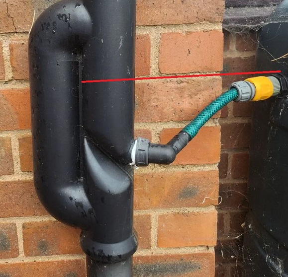

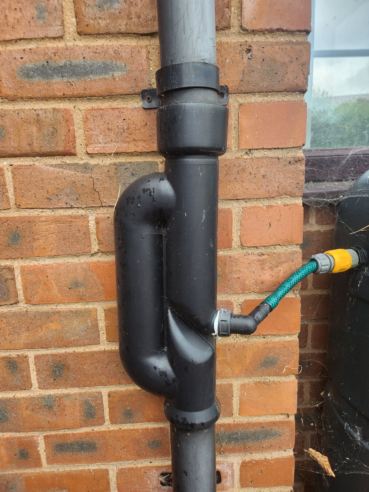

Can any one help identify this type of drain pipe that connects to our water butts? It's in a house we bought so didn't install ourselves.
Butts are filing really slowly so just want to check the installation instructions to check they are not at the wrong height or anything.
Thanks!
Not sure what make it is but because of the design, they tend to collect moss, leaves etc that wash down from the roof and it become trapped in this area and the hose connected to it....
....which slows or stops the water flowing into the barrel, and so it goes this way instead.
Removing it and cleaning it out will restore functionality. It probably needs to be done annually, or maybe more frequently, depending upon what the roof and guttering collect and deposit in it.
I normally remove the hose to the barrel and put a hose connected to a tap on it and blow it back into the device to wash it out. Also flush the connecting pipe between the diverter and barrel.

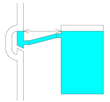

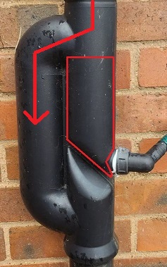

Once the water in the 'catchment part' of the diverter gets to this level water will enter the barrel.

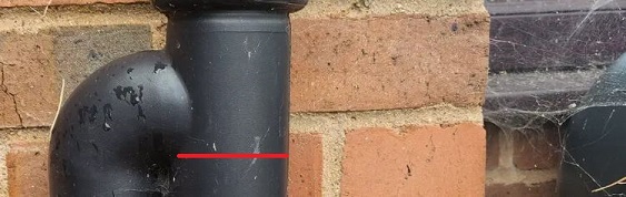

The top of the barrel is positioned above the point indicated below which is the point where the water by-passes the 'catchment part' of the diverter and runs down the by-pass on the left. This stops the barrel overflowing.
This design also means that you have some latitude on the height of the barrel.
Correct, it doesn't go uphill, just finds its own level.
It might fill the barrel a bit faster if the pipe wasn't quite so inclined, but it will still work, provided the diverter and hose are clear of internal debris. The final filling level would be determined as above.
Thanks for all the responses. I've cleaned out the drain pipe part, and the hose. There was a bit of gunk in there, so hopefully that has improved things.
I don't like taking them apart, because as you can see by the plumbers tape, the seals are terrible and they tend to leak in heavy rain.
One good thing about the drain pipe diverter is even though it gets gunk stuck in it, it stops the gunk actually going further down onto the drainage system and causing problems later.
replace the hosepipe with something bigger, Std hosepipe is 15mm outside diameter, 10/11mm inside, even that short length will present significant resistance to water flow as its not presurised-resulting in long fill periods, ive got 5 water butts feeding two IBC's all connected, had to change to 22mm(3/4") hose for the water butts & 25mm MDPE for the IBC's and i'm using a pump!
