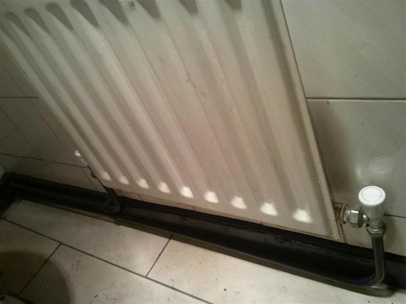

This is the lowest rad I have to drain the system down. I can't turn the heating on to check which is flow and which is return. The rad was added after the initial install in the last 10 years.
Is it anyones guess which is which? I need to block off the flow add my washing machine pipe and drain her down.......
Turn both Rad Valves off, drain rad & remove. Then attach hose to Wheelhead Valve on the right of your piccie & drain as previously described.
Once drained, replace the rad valve with drainoff incorporated.
Replace rad, pump valves & pump, refill & vent / test.

I'm afraid its a dreadful picture as I took with camera phone in poor light and no flash.
Sorry It's all I have.
Its low down with limited access, dark and grim,
Well, it does have valves - which have no chance of working by the looks of the piccie.
Mr. W.
