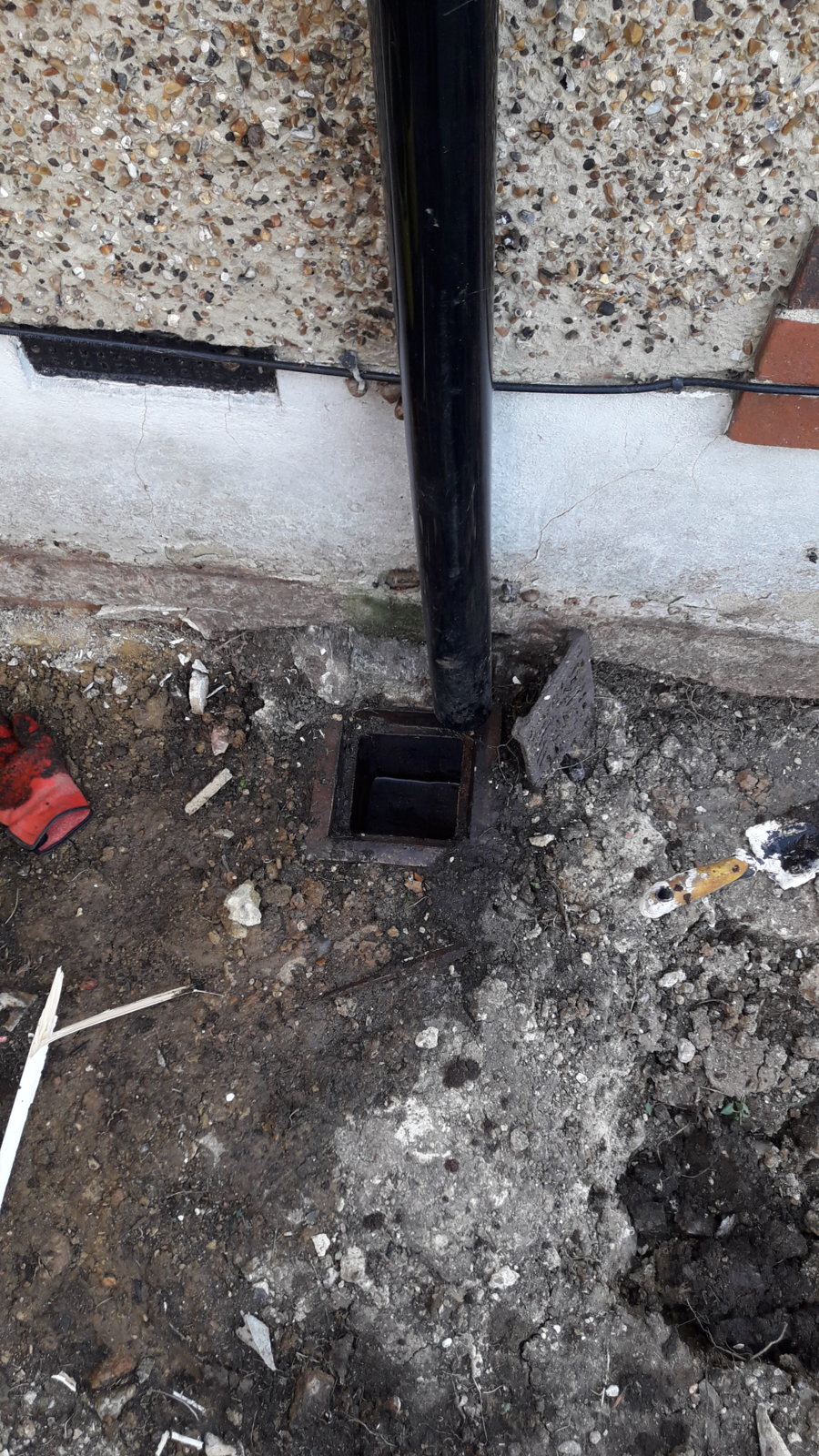

I have dug my drive up and am trying to work out where the rain water runs? The foul waste all runs to my man hole but I cannot find where the rain water runs as the gully traps are blocked and have wet areas. It's a 1930s house. All the drain pipes are clay. Near the man hole I found a length of 1 meter clay pipe that didnt lead anywhere? Someone mentioned it could have been a vent pipe? I take it they didnt use soakaways in 1930?

is that clay gulley somewhat below the level of the paving, or does the concrete around it appear to be patched or repaired? What about your other gullies?

Hi the gullet is below as I have dug down for a drive to be fitted. There is concrete around it as I guess that was to protect the clay pipe and gullet.

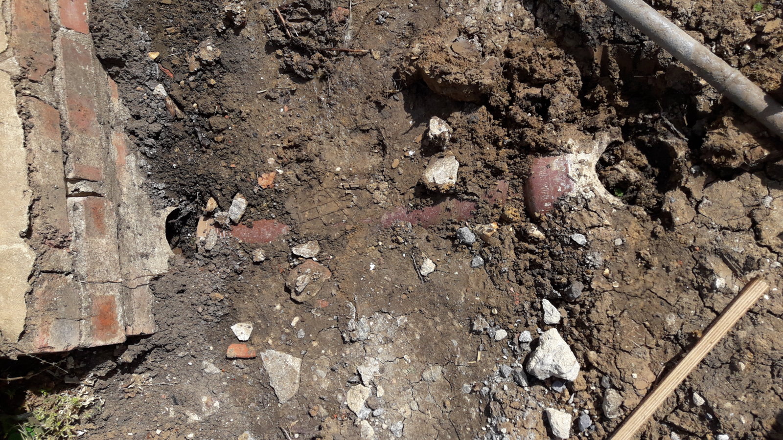

My house is detached J Allround, its interesting what you put as whilst digging to fit fence posts i found a clay drain pipe that went from my drive to his. I found this odd. I asked my neighbour but he has his drive done years back and could see all his drain pipes run over to the oppersit side from my drive.
I have run the hose down the gulley and the water is not running to the man hole?

But my point about the clay gulley is that they are (almost) invariably cracked, broken and leaking. When this happens, over time the ground around the gulley is washed away and it sinks, so the top of the gulley is lower than the original ground level, and any concrete or paving is cracked and sunken and/or repaired and/or patched.
When this happens the only solution is to dig it out and renew in modern plastic. While you are digging you can follow the old clay pipes (they are probably also broken and leaking, mostly at the joints) so you will find out where they go.

After further digging .... the 2 gulleys lead into my neighbours drive. He has now told me that they join with his and run into his man hole or a soakaway( he is v old so didnt remember when inasked him before) Like you have noted mine are damaged and cracked. (What worrys me now though is my foul waste pipes that are much lower could have collapsed ‍♂️.
I take it the best thing for me to do is run new plastic pipe and gulleys to my man hole?
You only need a gully and short length of pipe. You can join to the clay with an AC4000
