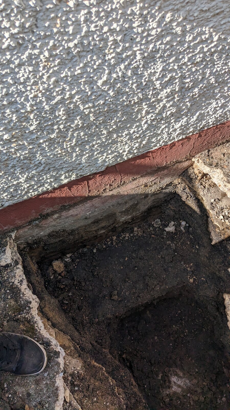

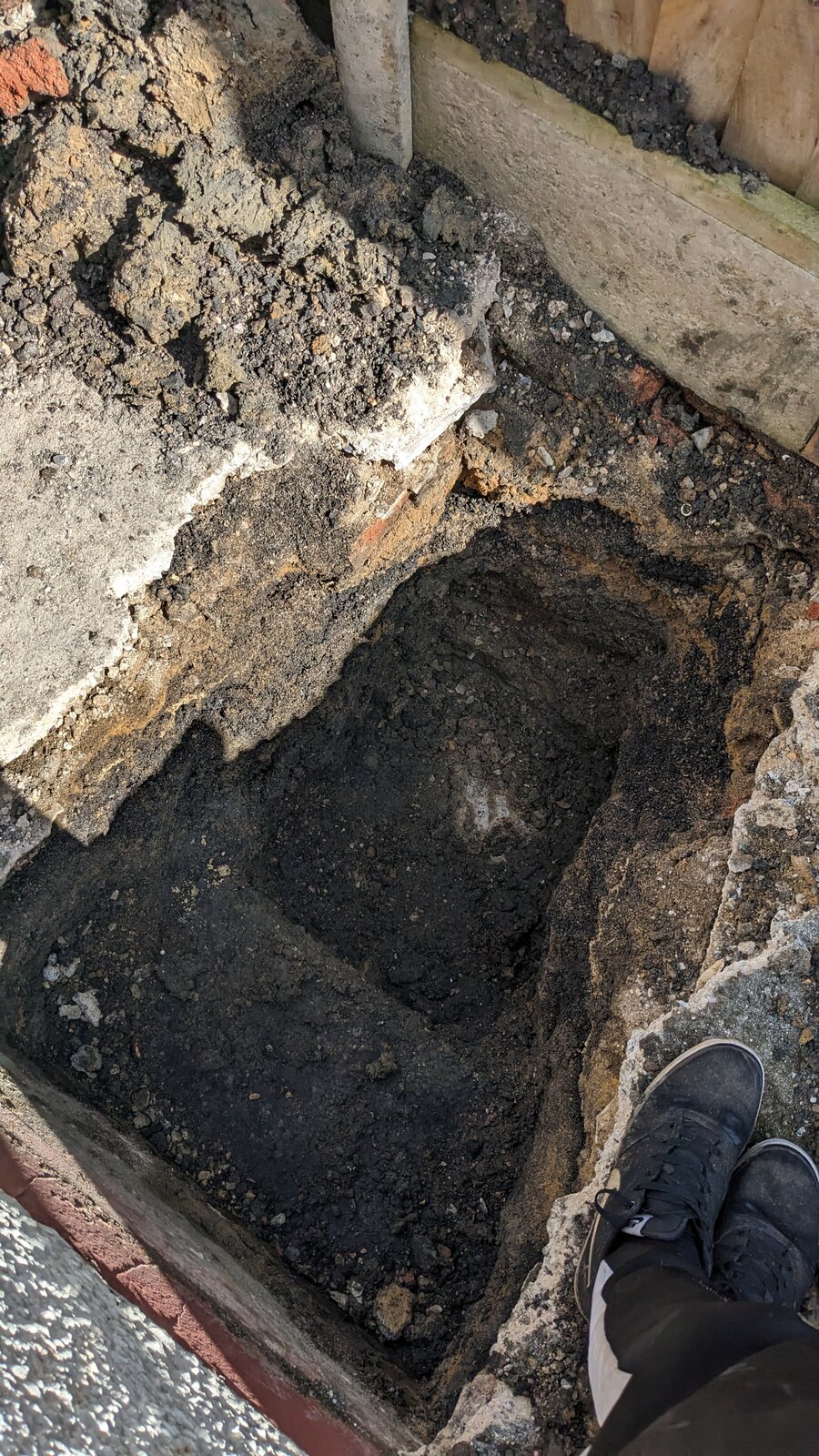

He asked me to get builder to check the depth of the foundation of the existing structure to see if it needs underpinning. When the builders dug it seems like there's some sort of step concrete foundation that stretches to my fence.

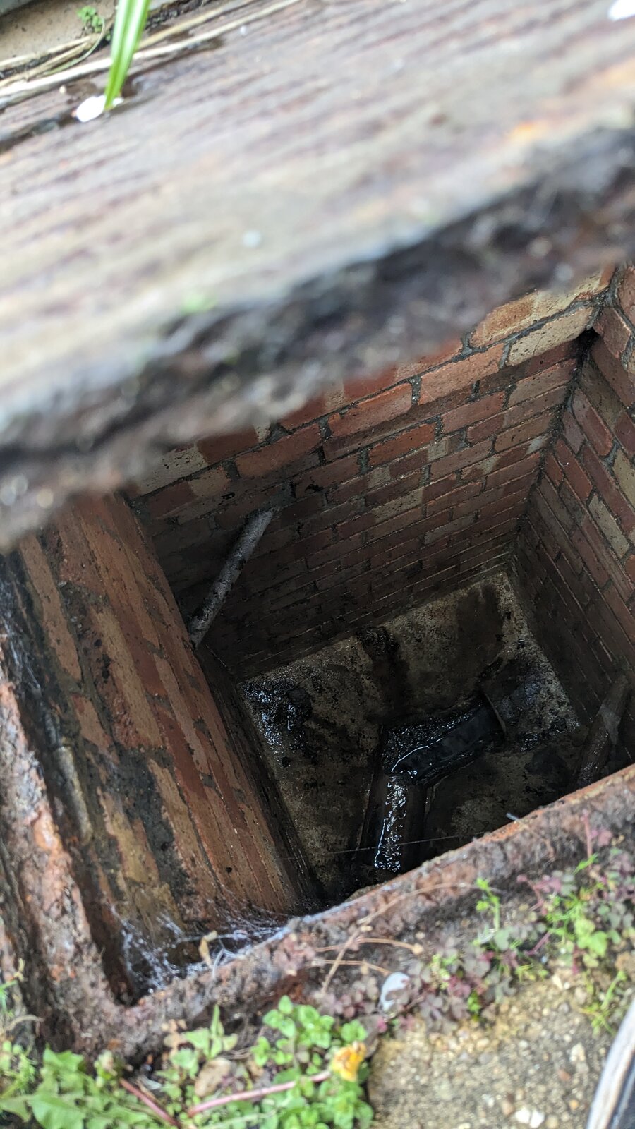

I'm now reconsidering whether I should even do the extension since moving the sewer pipe will set me back by £8000 apparently. What would be the ideal next step here (would a CCTV drain survey help in figuring out if it's running straight?)

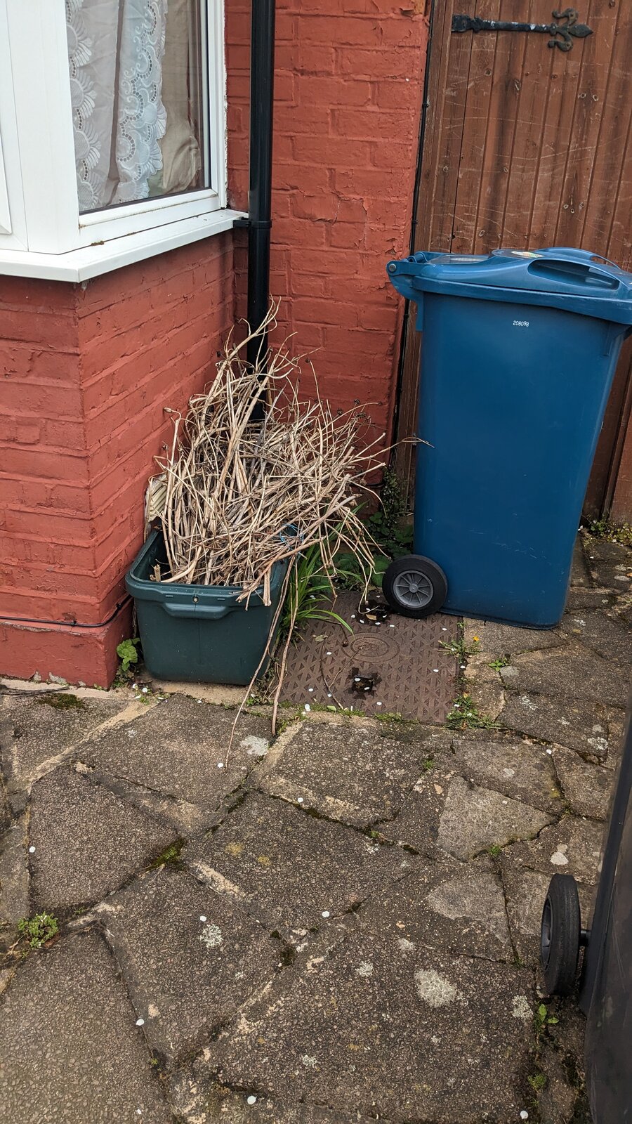

I've attached pictures of the stepped concrete foundation, the front inspection chamber which shows the location and the drain running parallel and directly underneath the edge of the existing side. Is it possible that the direction of the pipe changes and back to divert around the pipe and if so what could the lower foundation step be for?

The foundation looks like a strip foundation.

Thank you so there is an inspection chamber 3m behind the house and it seems directly in line with the inspection chamber at the front.
I guess then my follow up question is given the sewer pipe is 2.5m below ground what would the easiest way be to determine if the existing foundation that runs lateral to the pipe (and likely directly above it) is not putting excessive force on the pipe. Would the strip foundation have helped remove the pressure on the sewer pipe or given that the pipe is 2.5m down is it safe to think that it wouldn't be affected.
If the pipe was going to fail, it is most likely to be at the point it passes under the foundation. If the local geology is stable it should be OK, but running directly under a foundation rather than passing directly under does add risk. A good test is, how long has it been under the foundations and has there been movement. Normally most movement occurs soon after construction, settlement.
