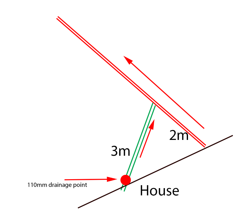

We had a team adding some drainage work to the front of our house and have basically added a new drainage section from another room meet the current sewage drain away from house.
Where the two pipes join (green pipe is new addition) they have dug up and just added rubber connectors and a 't piece' here and filled it all back in. Should these area have a hatch ? I see they have added some sort of external drainage point as the new green section leaves the house.

An inspection chamber would have been better but would have cost more. Are there any existing manholes on the red line?
The junction they have fitted will be fine and it sounds like they have left access at the upstream end in case there ever is a blockage.
Thanks Ian there is one that is near the house on the red line facing downstream inline on red pipe near black line (delineating the wall to house).

Should be a chamber if its foul water, did building control pass this?
Whats a chamber and where? The red pipe is foul the new green will be just used for grey does it still need building control?
In that case most authorities accept a roddable type gully with the drain junctioned onto the existing foul drain, though my adjacent authority were insisting on a chamber a few years back. Yes it requires B regs. for the installation of the drain, it will also be required if you have fitted a new sanitary fitting, sink, shower etc.
