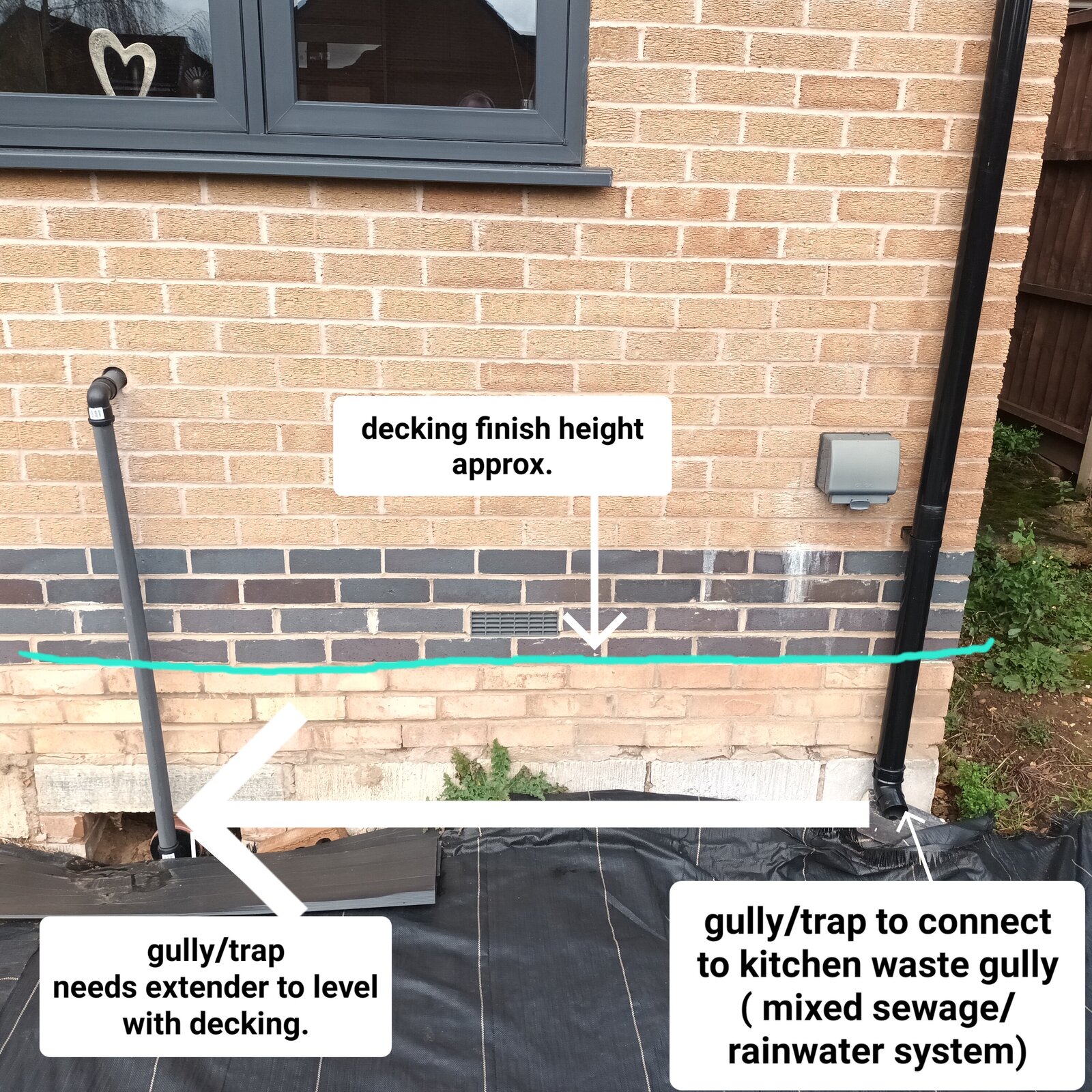

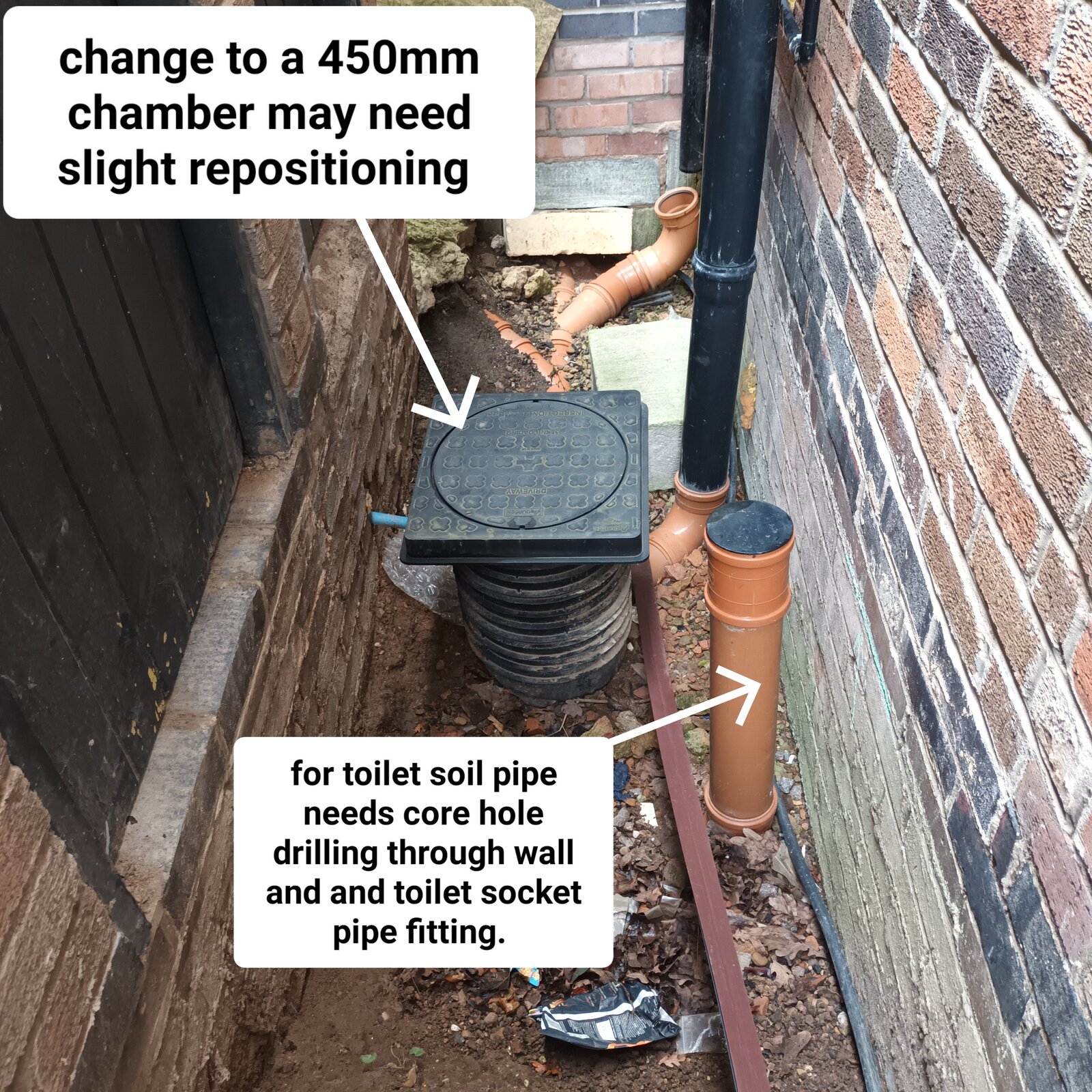

I have had a quote for £1900 to make good the drainage system...does it sound fair it's for 1.5 days work that's how long they said it would take them. I have attached images to give a better understanding of what needs to be done.

Seems a little on the high side, why the combi drain? And there should be room to fit with chamber.
Not sure why he said a bigger chamber needs fitting as there are no extra inlets needed..this chamber runs to the older chamber.

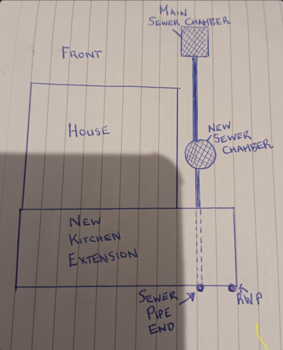

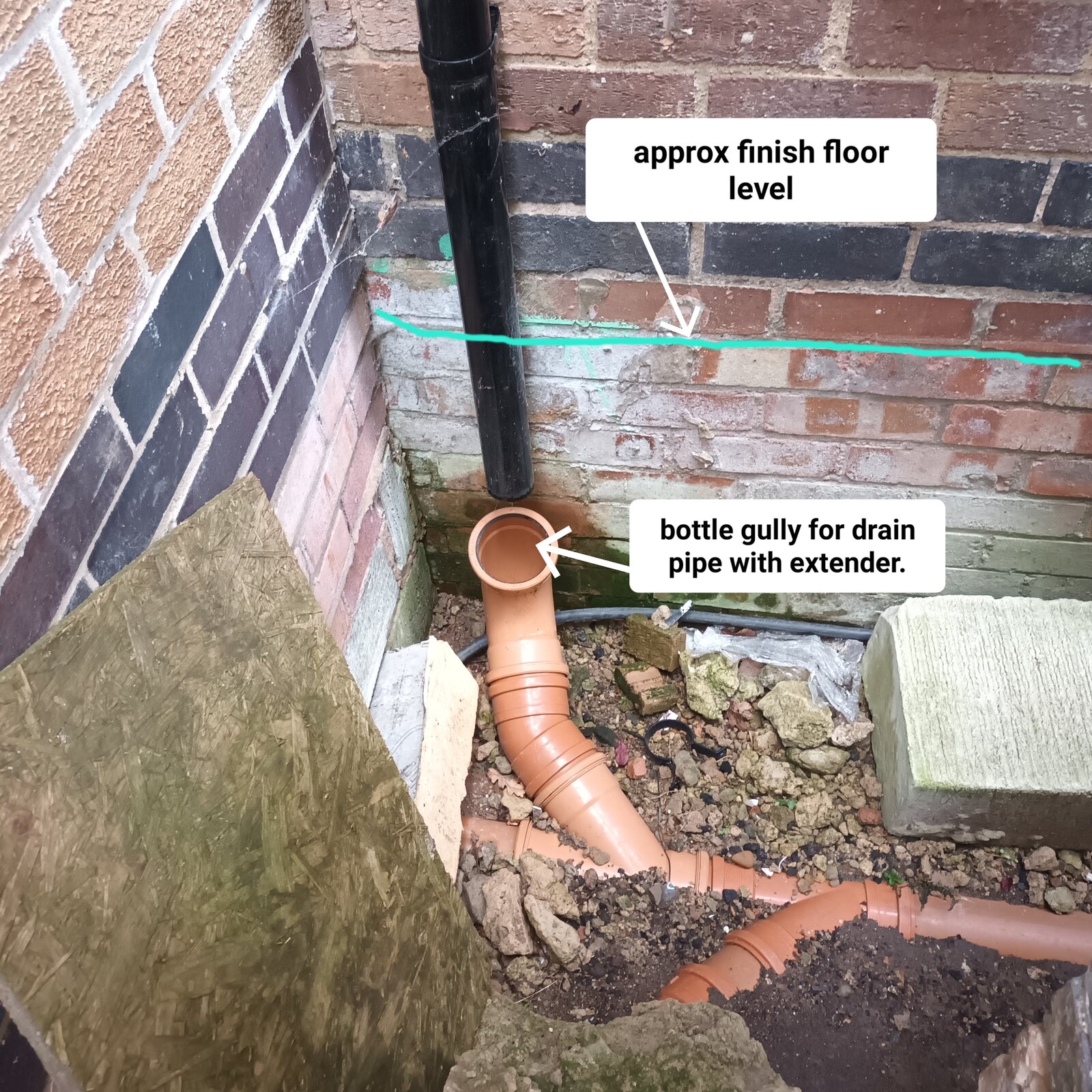

Depends entirely on the specification they've given for what they propose to do. There is a fair bit of work I can see needed, so if material cost is significant, £1900 may not be so bad. Existing workmanship looks poor, no sign of any peagravel to bed/protect the pipes for starters. Then what is the finished surface to be, and will the pipework be adequately protected?
Also, needs a longer radius bend at the foot of that stack really, otherwise could get messy in the chamber. Swapping to a bigger chamber may actually increase the problem there as there is more room on the opposite side for crud to build up, and in all honestly, I don't see any need to put a bigger chamber in there. Bottle Gully for rainwater I think you're aware of, Access bend will be needed where the pipe goes through the wall for the WC, (well, I'd fit one otherwise the WC will be connecting on a bling junction, not ideal if it ever blocks.)
Openings under lintel where drains pass through walls need to be sealed I would think.
Thanks for your indepth reply I was just thinking it seems very steep when I was told it would take at most 1.5 days to finish, I have done some rough pricing and can't see materials going past the £300 mark and probably cheaper if there was no need to change the chamber...so that leaves £1600 for labour for 1.5 days work! Your definitely right about the long radius bend on the stack because the sides of the chamber does get crud build up, the finished surface will just be gravel.
