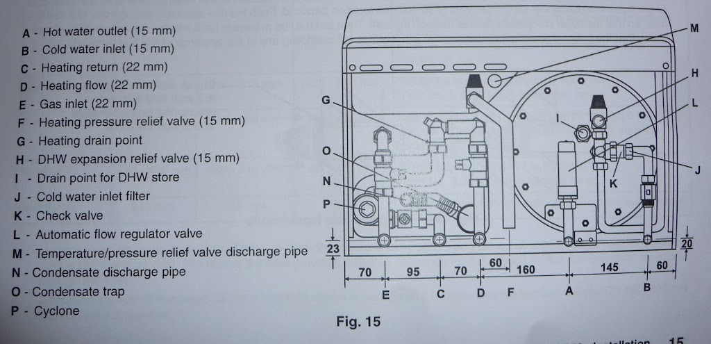

OK - Thanks. Hopefully, I'm staring to get close. Below is the plan from the manual. I can find "I", the hot water tank drain point. "G", the CH drain, is still illusive. I can't see anything like "I" where the CH water can be drained from. Can you point me in the right direction?
Plan:
My system is below. Is it the part with the two black arrows pointing at it (not on the plan!)? If it is, I guess I'm draining the system to buckets as there is nothing to fit a hose to.
Thanks again!
Yes it is that, I used box spanner think it was 1/2 inch 13mm but not sure.
We put a short length of rubber gas hose onto those types of drain off and sit it in a bucket. The boiler has little in it. You can trust the alpha iso valves.
It looks like your installer has put an install pipe in such a way as to make your cyclone filter inaccessible. However I wouldn't be all that worried as they aren't much cop anyway.

This is great news. One last question - to drain the whole system, I guess I just leave the values as they are?
Scott
We wouldn't drain the whole system from the boiler these valves are quite slow.
What I do is shut both valves to the lowest rad, using a low level tray like a gardening tray or a paint roller tray empty the rad. Remove one of the valves and make up a fitting to fit the stub in the rad, connect a hose to that, open the other rad valve and whole system drains quick speed with no leaks.
The traditional drain offs which look innocent leak water from every orifice, which runs down your hose and also drips from the body of it. So you waste a l;ot of time plumping up the joint and running the hose carefully and all sorts of titivating you have to do. No above method is best.
