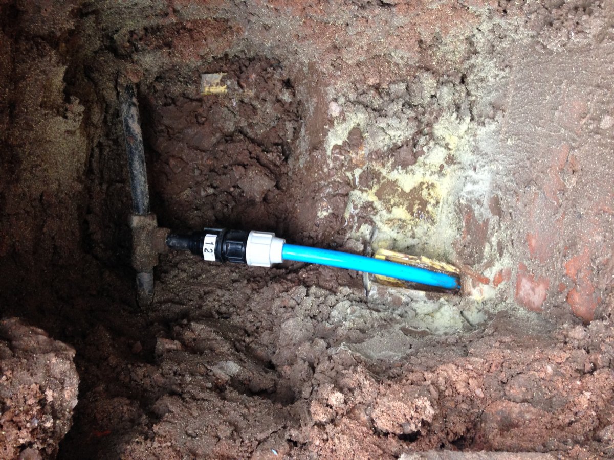

Stuff like this which was the day I refused the other job.
It ****ed me off because first I was in Stafford, 80 miles from home. They asked me to unblock the drain before I even got to the water job. On the water job I had to locate the leak, exco in the driveway where I could hear it. It turned out to be under the house so I dug inside too, posted a new section through, piped up with new stoptap. Then backfill and reinstate both before another 80mile trip home. That's on my own and I have to write a report on the laptop for every job too.
On the drains I felt I was a professional. On the water I feel like a bodger.
