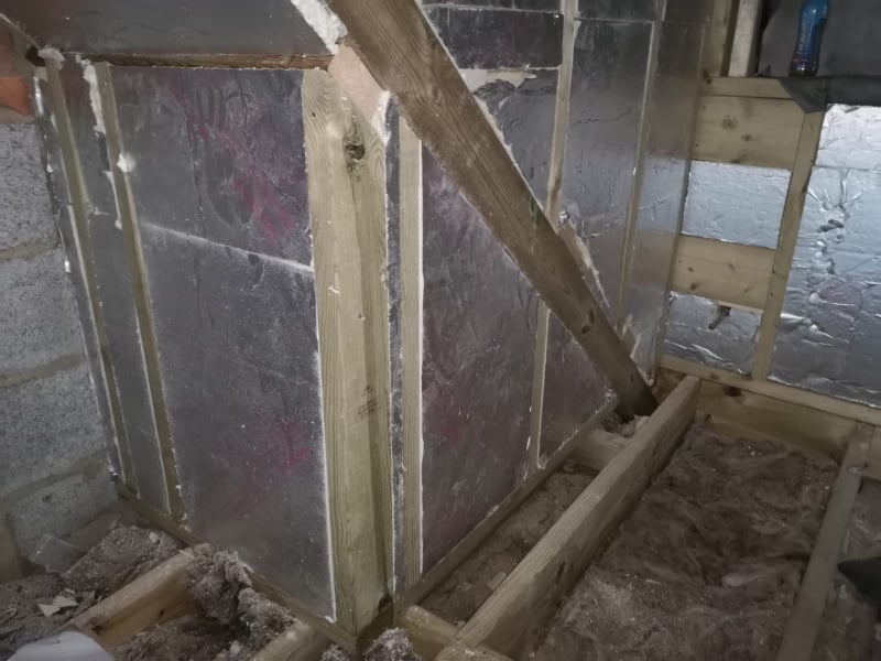

Do you know how the dormer walls have been closed under the floor?
Might not be explaining this well but assuming they have left the existing ceiling joists in place and ran new floor joists alongside which sit on the existing wall plate then the joists will run in to the roof space. This needs to be closed up or you will have cold air from the roof space blowing under your floors and creating draughts.

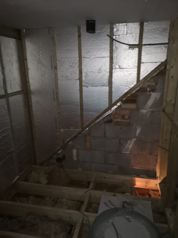

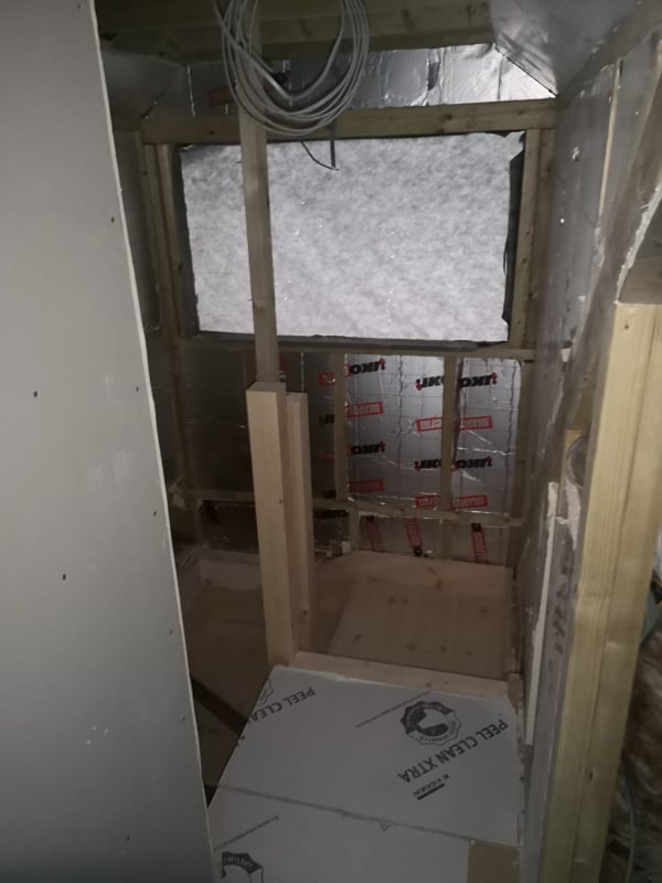

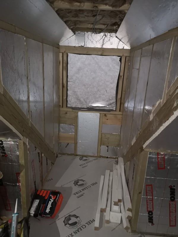

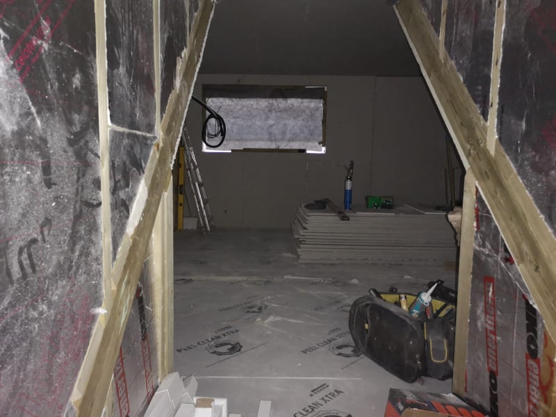

I don't know how they have been closed but yes they left exciting joists and ran new ones alongside. The builder isn't great and I doubt I'd get an honest answer to your question. He didn't put the rockwool under the new floor that we requested which I assume would have helped reduce draughts too. It's been plaster boarded and skimmed now so I guess there is no way to tell ourselves either?
I'll add some photos we took during construction as they might shed some light.
Your builder could also have done with cutting the PUR insulation a bit tighter to the joists (it is gappy in places - so maybe foam the gaps?) and also taping across where cut pieces butt up to each other with silver insulation tape. Someone on here recently suggested using the smoke from a joss stick to ascertain where any draughts were - seems like an excellent idea to me to help pinpoint the issue(s)

Only issue is these photos are not current and he has since put plasterboard over (which was messily taped) and skimmed that. Can draughts still come through this? The builder keeps going on and on about how warm it is but while I agree it isn't cold (yet) the draughts are annoying. It's taken 6 months to get this far and it's been such an ordeal we really just want him gone. We do have another builder coming to look because there are unfinished items that we are struggling to get the current builder to do (like exposed water main and missing kitchen ceiling) so I will also see what he can suggest. Thank you for all your continued input in this.
