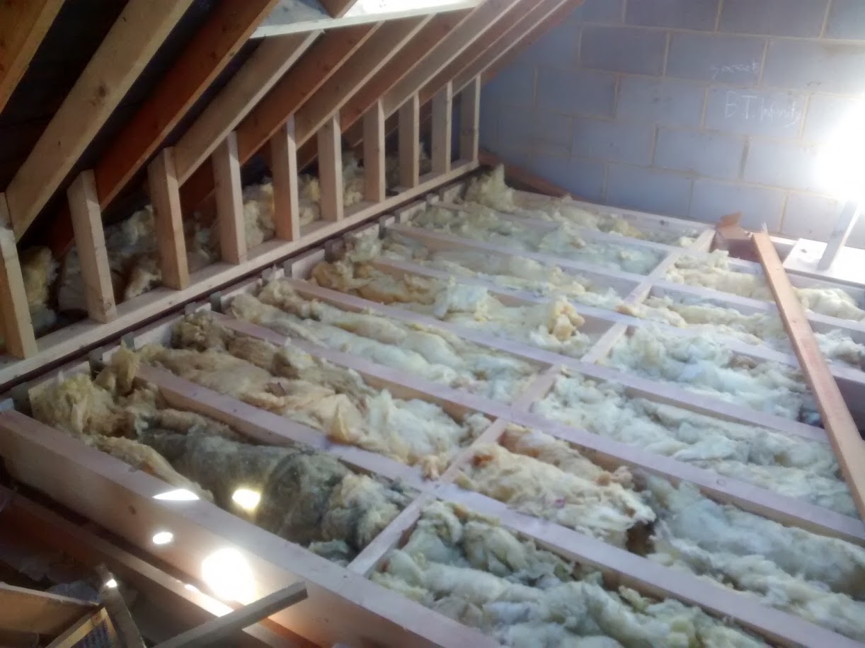

IMO, not an expert, it should all be sealed up somehow. There should not be cold air flowing below your floors. Yes, if it was still a loft you'd have ventilation, but it's now a habitable space.
What did they do with all the insulation that was in the loft? When I had my loft conversion done, all the insulation was used under the new floors for both sound and thermal insulation. That would also stop any excessive drafts if air was getting in through soffits etc.
Pics, all piled up while they worked, then put back after.
No, there shouldn't be draughts, in the room or under the floor. The loft room(s) and the floor between them and the storey below are part of the warm, insulated envelope of the house. Ventilation to the rafters should be the other side of the vapour barrier.
