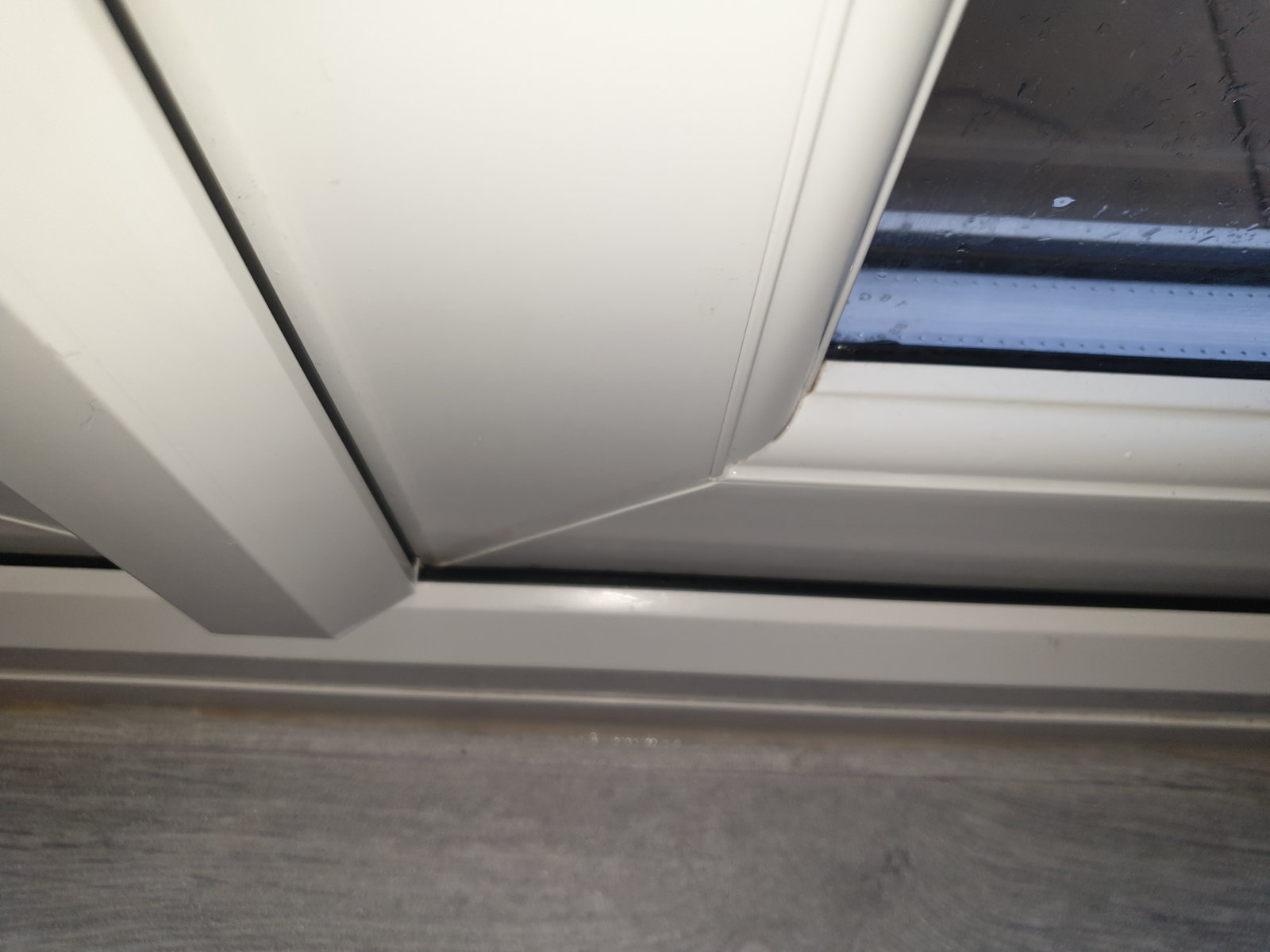

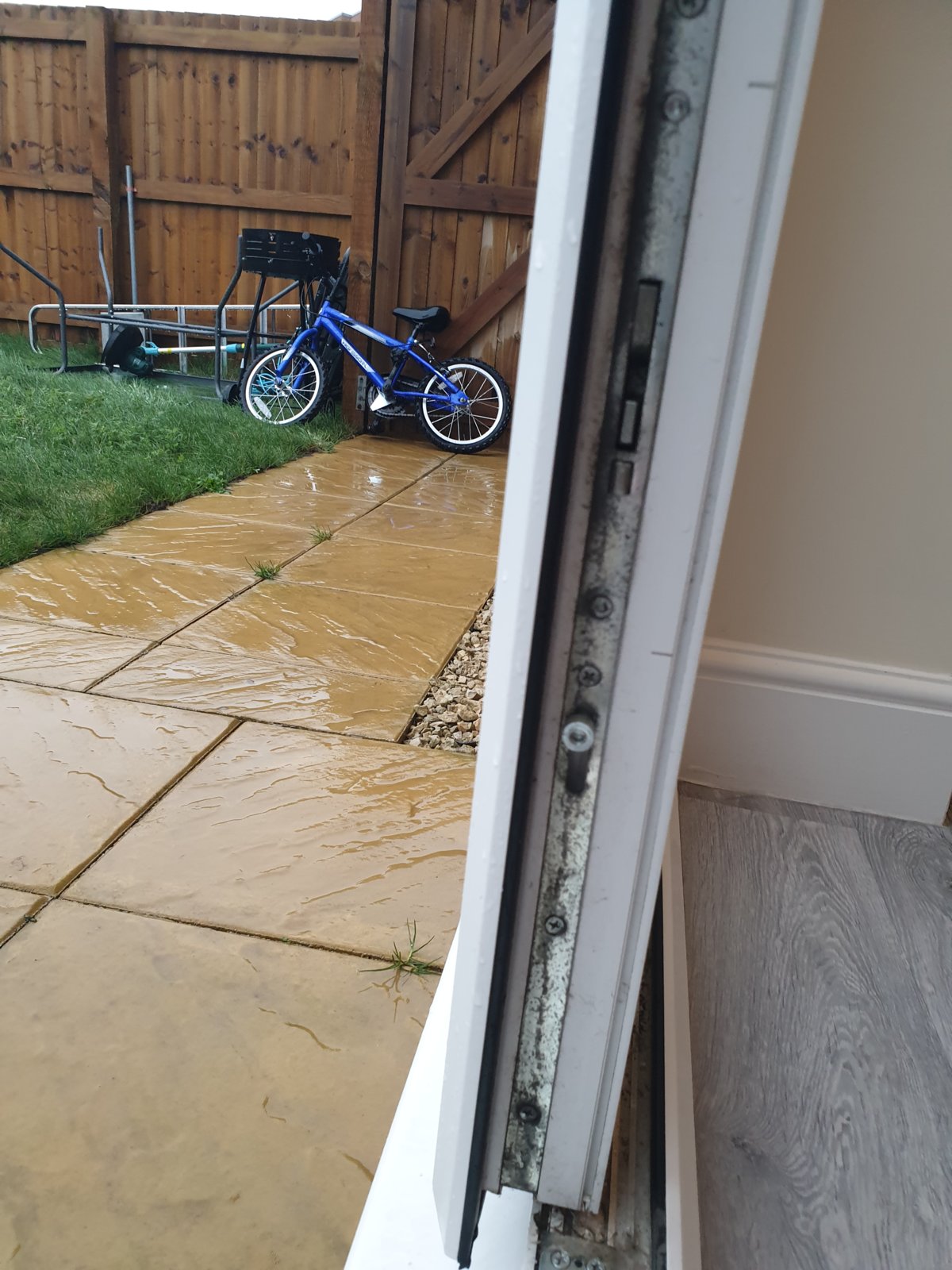

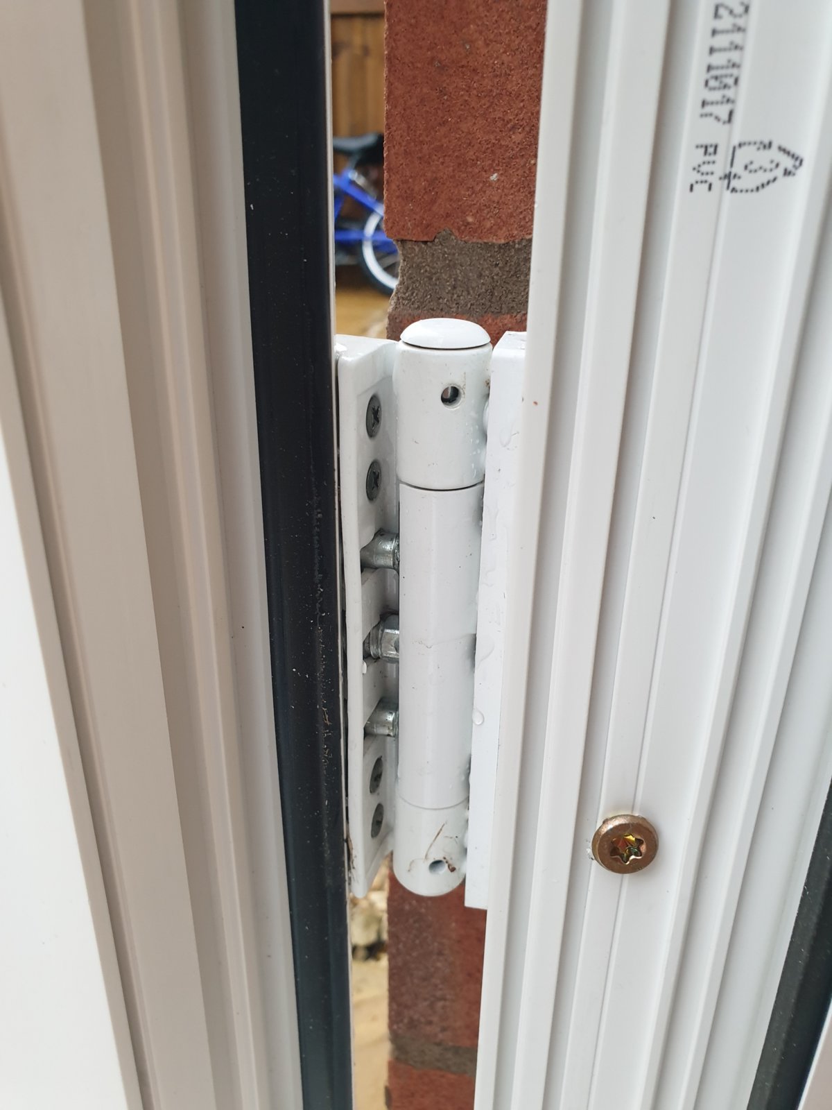

Hi guys. Bought a new house and the kitchen doors a bit draughty below the handle especially in the corner (1st pic) and at the bottom. I can see a small gap where the hinge is. Thanks

Does the Door pull inwards when pushing the handle upwards? This will tell you if the roller cams are engaging the keep.
I would adjust the latch keep slightly first by loosening the screws and moving the keep towards the kitchen. Re-tighten once you are happy. This should hold the door closer to the frame.
Then check the handle again to ensure everything engages.
Only adjust one thing at a time check and then move forwards or backwards
