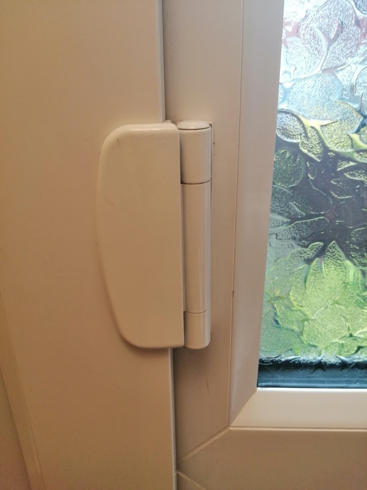

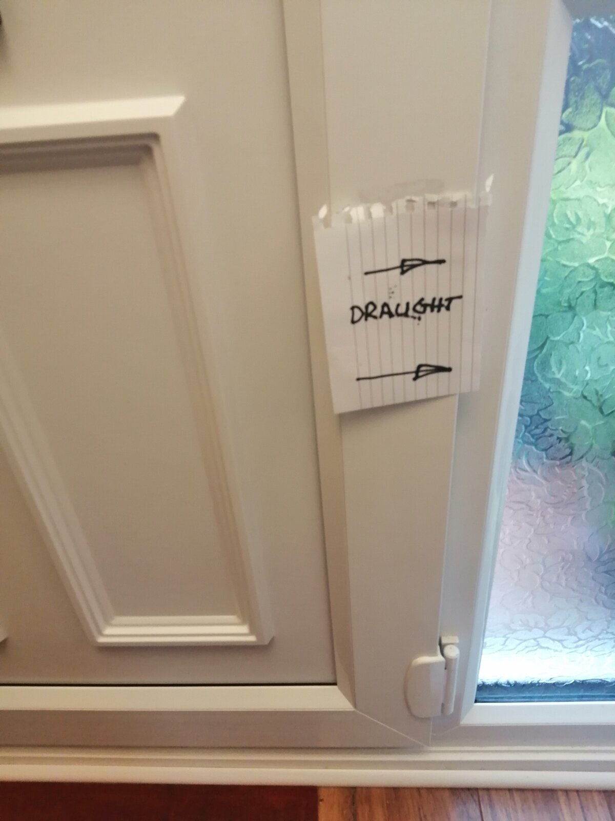

Draught on UPVC DOOR hinge side bottom
15 Dec 2007
186
Yorkshire
Could you tell me were i need to adjust not having much luck I have rechecked door and frame and it is square It is just draughty at bottom half of hinge side see pics thanks IMG_20241025_120754_resized_20241025_125320743.jpgIMG_20241025_115028_resized_20241025_125411042.jpg
Thats an SFS Dynamic hinge and unfortunately only a 2D hinge, up/down and left/right, no in/out adjustment
