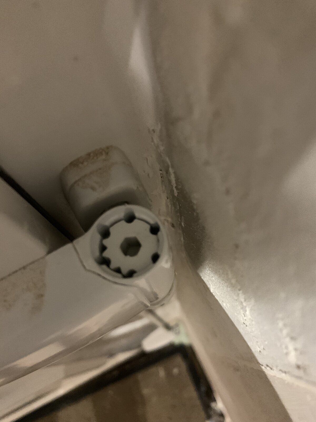

Compression adjustment not working on flag hinge upvc door
3 Dec 2021
5
Hi,
As in post #2 of the other thread, if the adjusters are stuck when loaded, take the door off.
Tap the adjusters up a little to release them and rotate appropriately.
It's helpful to mark the starting positions, so you can get them back, if your adjustments go awry! :)
