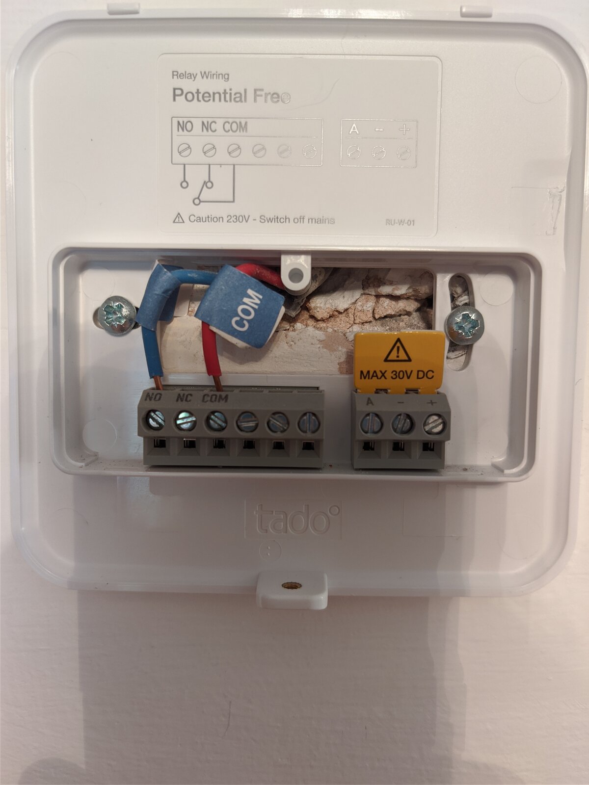

Im doing something a bit back-to-front and just had a quick question. I currently have a Tado smart thermostat fitted and am moving house, so taking it with me. I have a Drayton Digistat +2 which is going in its place. I currently have the Tado wired up as below (Red to COM and Blue to NO)
Would I be correct in thinking I go Red - C and blue to Load/On ?
