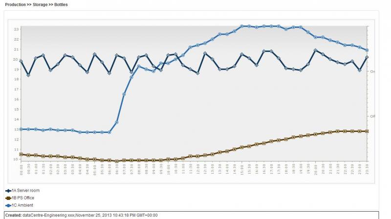

I think the algorithm is very strange. Must admit I am using the thermostat in an unusual way - to control an industrial hot air heater - but the previous model worked fine. This one is very odd. Comes on at 6:30 am and rockets up to 19.5 deg in a couple of hours but then slows right down. For the rest of the first half of the day the room is too cold but the temperature gradually builds up to 1 deg over the set point (22.5) which it gets to by 3 pm. It then maintains this temperature until the shut off time at 6 pm.
I have uploaded the graph into an album. The relevant graph is 1C
I have worked out for myself now what must be happening. When the first on time of the day is hit the unit goes in to bang-bang mode for a maximum of 2 hours. Then it goes into PID mode. This is gives the quickest warm up to the set point and for a normal house will result in no oddities due to building up an integral term. The problem for me is the air space is large and the building very poorly insulated. The heating system needs more like 3 - 4 hours to get to the set point. Because the unit is well below the set point when switched into PID mode (after 2 hours) a very large integral term then builds up as it heads for the set point. This results in a substantial overshoot which lasts for hours - indeed until the end of day at 6 pm. I don't think it can ever self correct because of the 2 hour limitation.
The conclusion is that this controller is unsuitable for large poorly insulated buildings. I have corresponded with Drayton and they have not confirmed the above but they say that the algorithm can be disabled in Option 5 of the Installer menu in later models. For earlier models like mine this option only disables the optimum start feature.
