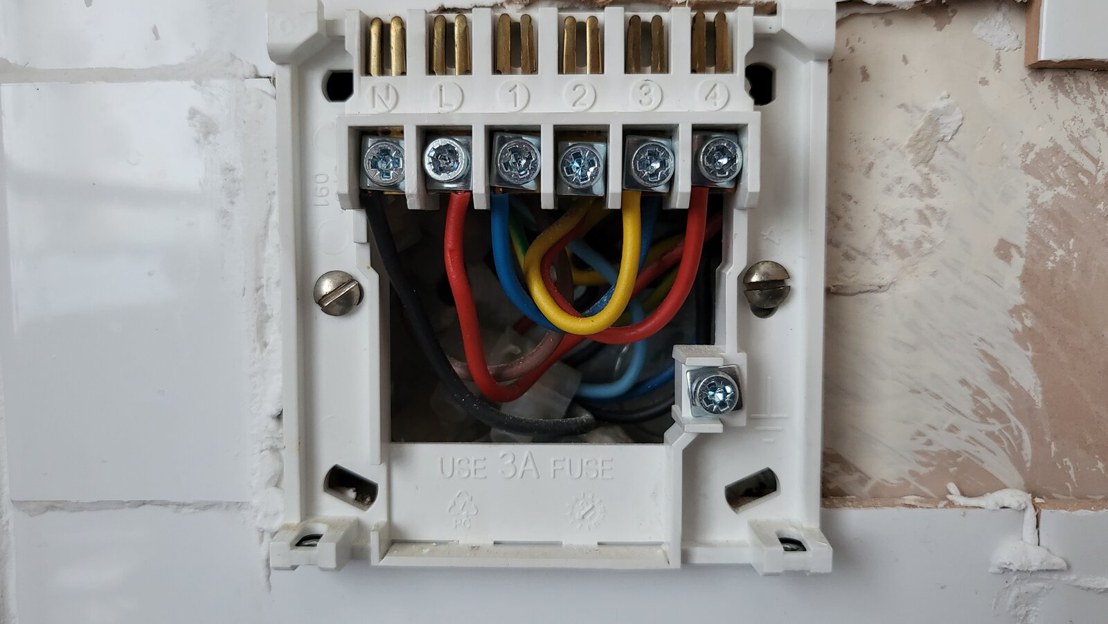

Hi there,
so I've found a few posts regarding what I'm trying to achieve, but the issue is that all those posts had the diagram for the "wiring center" which mine does not have. I'd appreciate any help getting this setup as I have absolutely 0 experience with these systems.
I also just moved to the UK this month and using a system like this is also a first for me. Back home there was always warm water available without turning it off/on/etc and heating was controlled directly on the "radiators" in each room with a 1-5 dial attached.

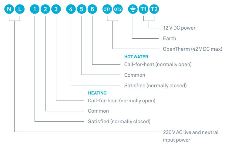

I believe the programmer part to heat link is pretty straight forward (please correct if below is wrong):
N to heat link N
L to heat link L
HW OFF (1) to heat link 'Hot Water Satisfied' (4)
HW ON (3) to heat link 'Hot Water Call For Heat' (6)
CH ON (4) to heat link 'Heating Call For Heat' (3)

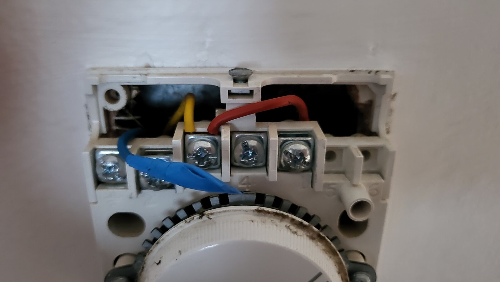

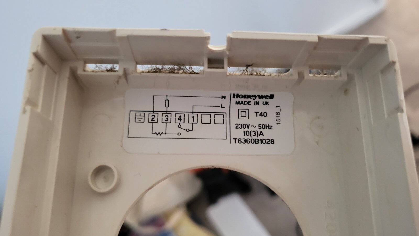

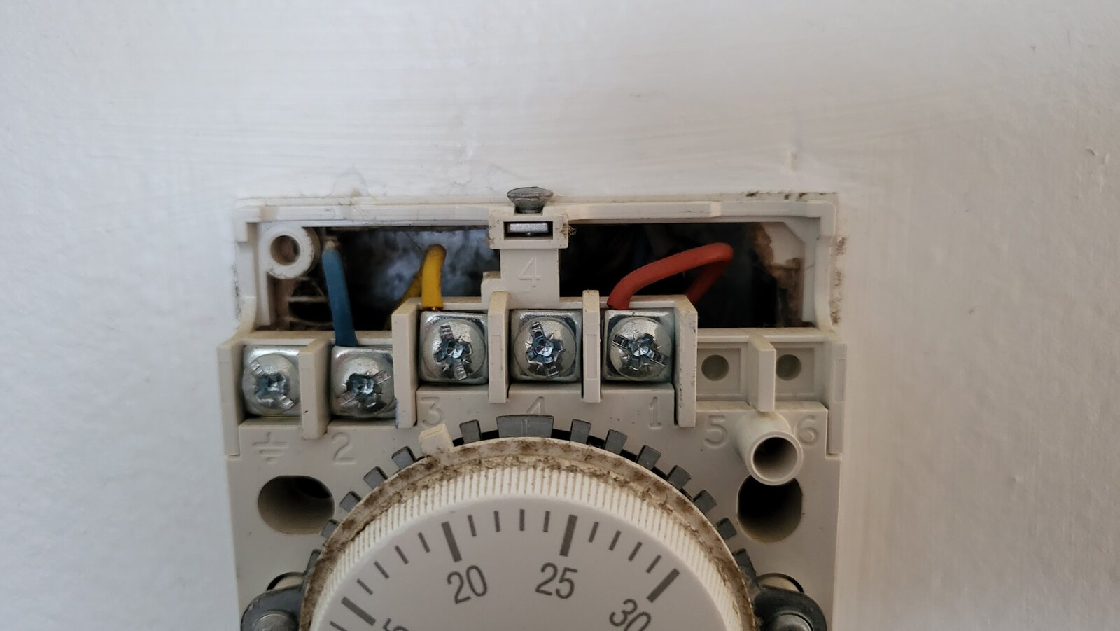

Now on the thermostat I read that you have to decommission the old one and also add a link to the heat link. That's the part where I'm very unsure, especially as the wiring centre doesn't have any diagram on the lid or anywhere near it.

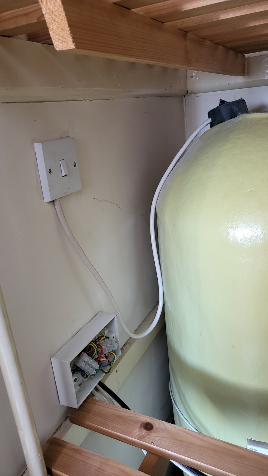

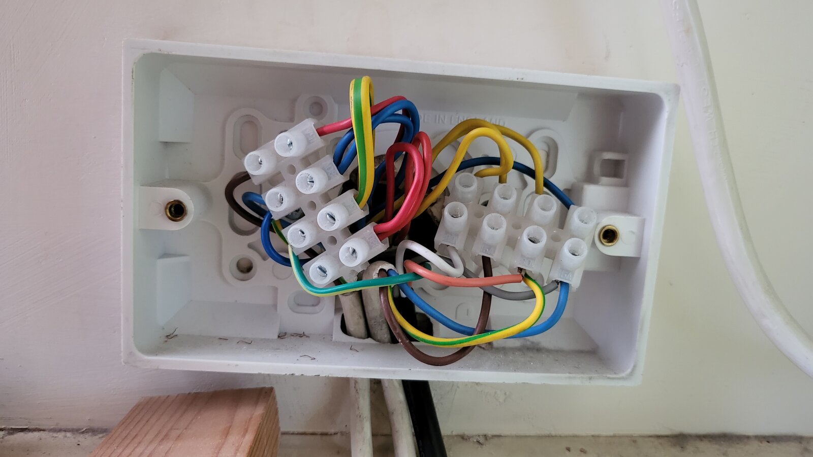

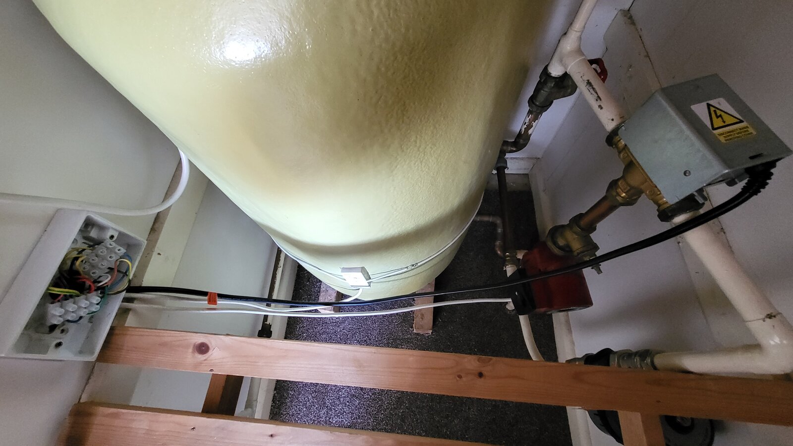

What I assume is the wiring centre would be this one next to the boiler upstairs. Probably unrelated to the Nest, but I also have no clue what the white switch above does and if it should be on rather than off?
Thanks a lot in advance for any help!
You are nearly there, your wiring is correct, but you need to make a link between L &2&5 on the heatlink, on the old room thermostat you need to join the two wires in 1&3 and safely isolate the Neutral wire, the swich you mention is the isolator for the electric immersion heater, only really used as a back up if your boiler fails
So just plug a cable from heat link L to heat link 2 and shove in a 2nd cable from 2 that goes to 5?
Just connect 1 and 3 wire together? Feels a bit strange to an amateur like me, but I guess I can crimp one of those wire connectors on?
yep thats it, you dont have to crimp it, but you can, a simple terminall block will do, if the thermostat is staying where it is just put both wires into the same terminal doesnt matter which one

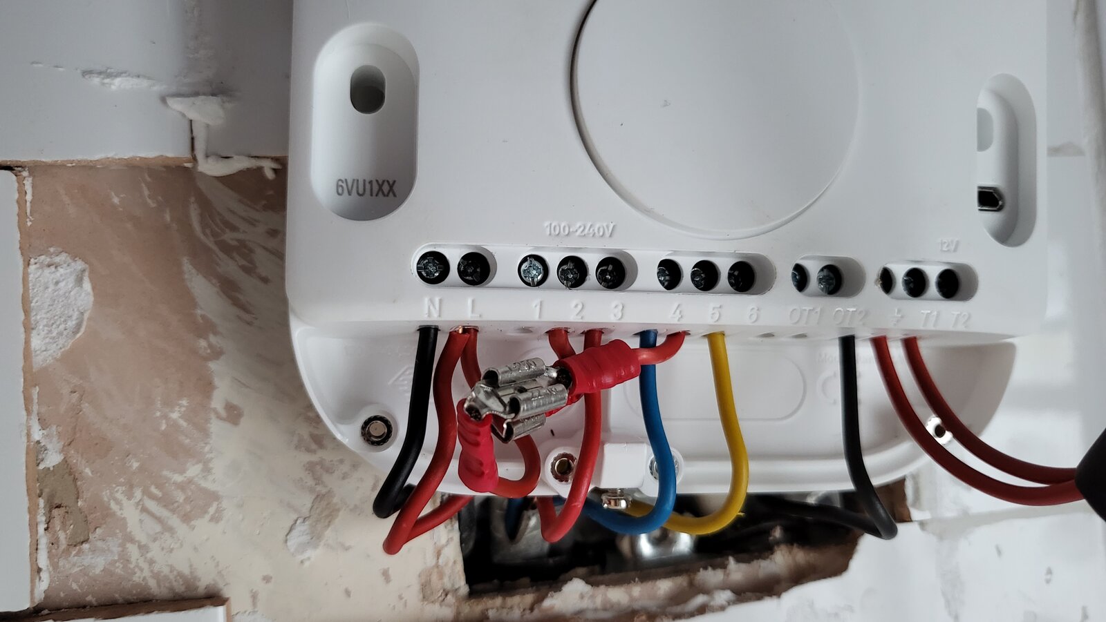

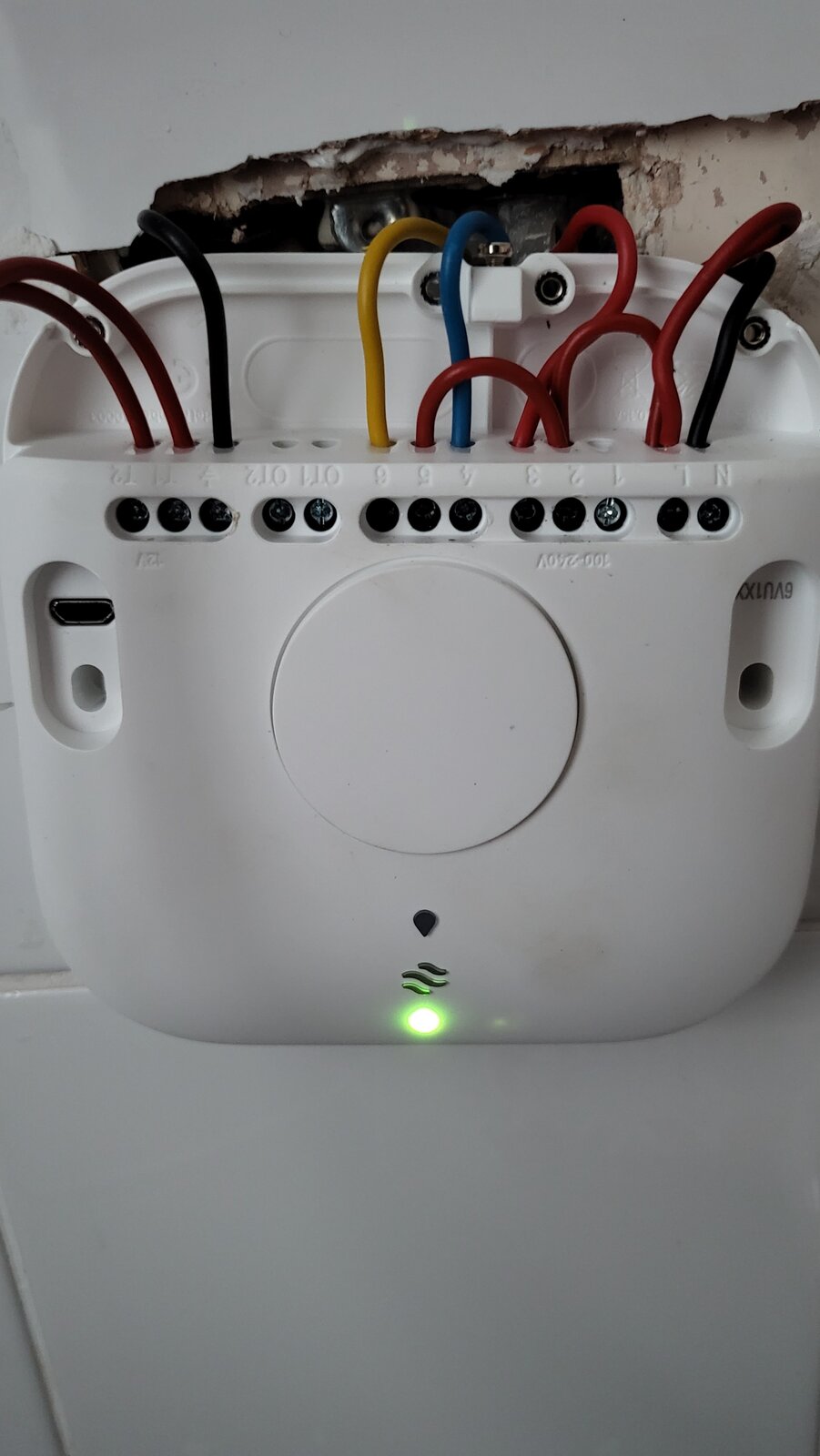

post a pic of the wiring that you have done at the nest
Pictures attached.
So the boiler in the kitchen is definitely doing something, making noises. However I just went around checking the radiators and they're not warm.
Checked warm water and I got some, so I guess that's what the boiler noise is coming from even though the thermostat has water set to off as well?

that couldnt be more wrong, no wonder it isnt working, wire it the way you origionally posted, why do you have nothing in 6 and a wire in OT ?? and you cant use those crimps unless you want to kill yourself, you would be better getting a pro in, its obvious you havent a clue what you are doing
Thanks for the compliment I guess lol. It is wired as before it's just the perspective. If you compare the holes and numbers above it matches. Yellow is in 6, nothing is in OT, that's in ground for the nest thermostat. I'll attached another pic.
The crimps are to make this L&2&5 link. Once confirmed working I'll put a heatshrink and electrical tape over it. And the whole heat link cover obviously over the whole thing.
The boiler did shut up now btw

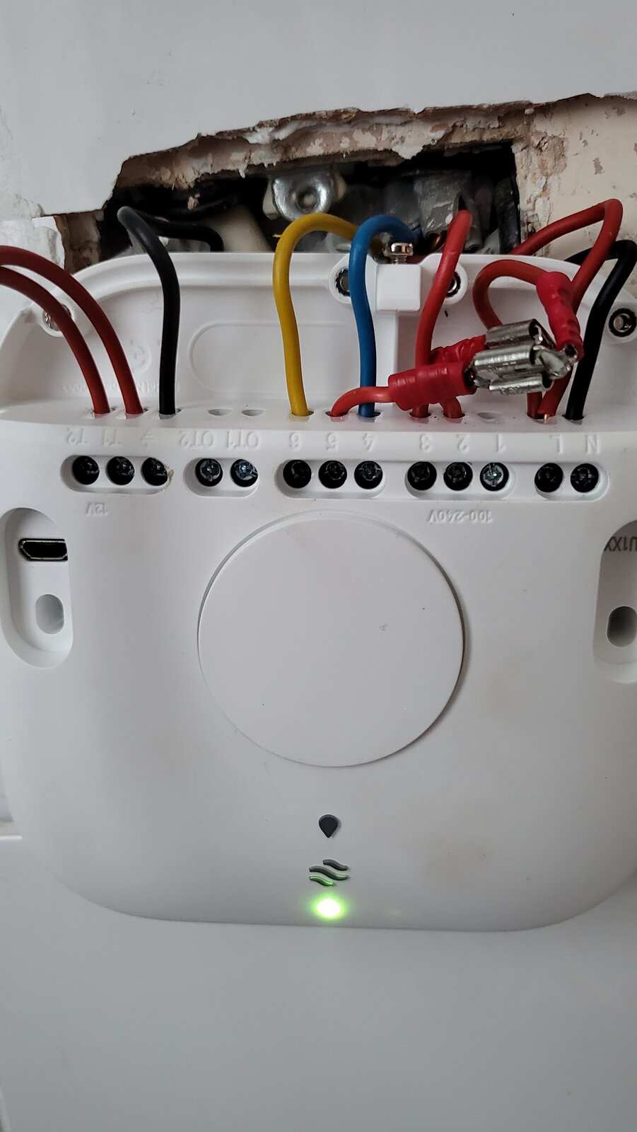

Why all the crimps? Might just be a bad connection. Also why is there a black wire in earth? Is it being used as an earth? If so, sleeve in green/yellow.
Reseated all the cables now and removed the crimps.
The only thing I didn't have is a sleeve for the black ground wire. I only had red and black wires that's why black for the nest thermostat ground
Does it work now? You still have the black wire in earth terminal.
Boiler still quiet for now with everything turned off, I'll keep it like this for an hour or so and if the boiler stays quiet I'll start testing heat/water
In regards to the black wire earth terminal, I read this is to earth the nest thermostat that's connected on T1/T2. Is is not needed to earth it?
Yes the earth is needed, unusual for it to be a black wire though. If it is an earth sleeve it to prove to anyone who may work on it.
