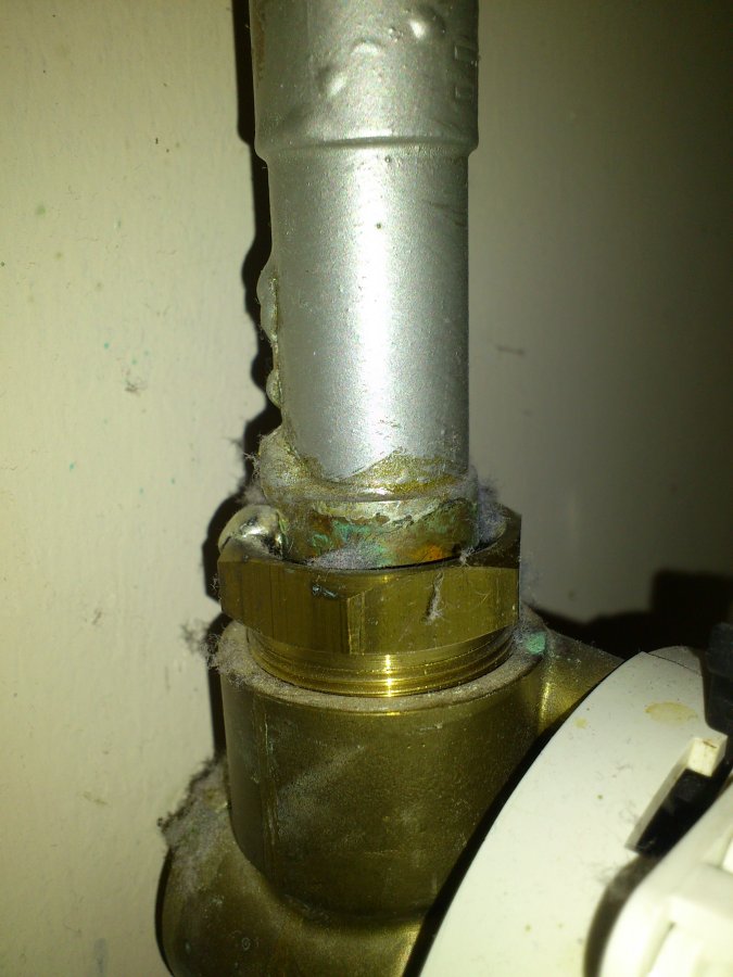

The actuator on my old ACL Drayton Lifestyle 28mm motorised valve 779H335-30L10 has finally failed.
This valve is now obsolete, so I'm looking to buy a complete replacement.
After doing a bit of research, the direct replacement is a ZA6/779-2 - also 28mm.
I've also found a ZA5/679-2 - 22mm.

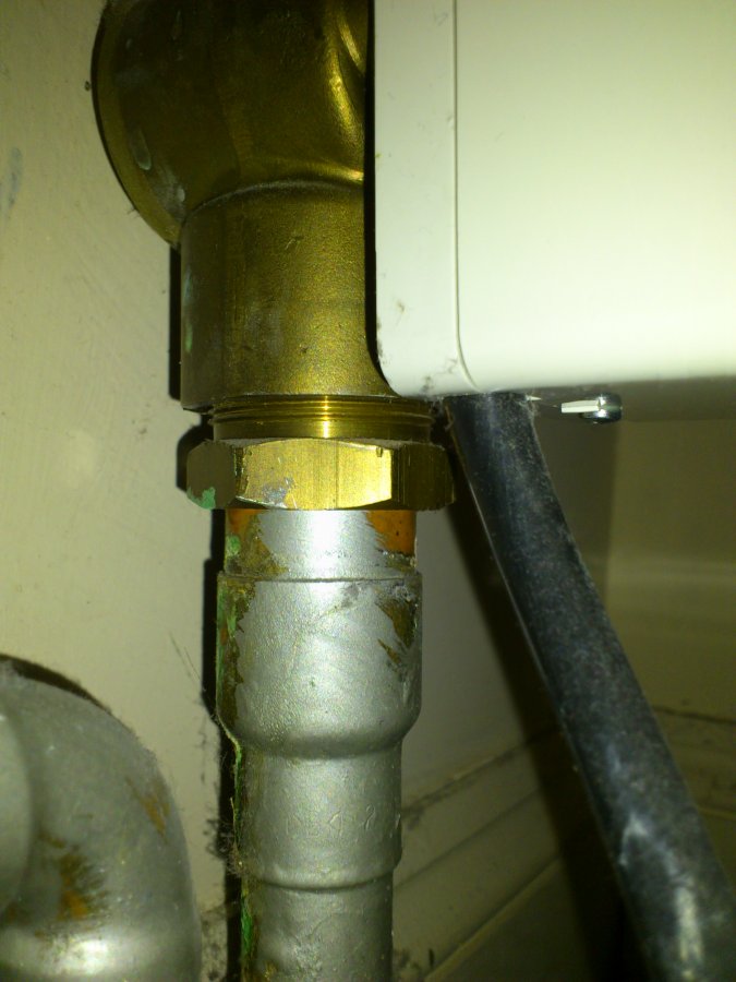

After looking at the fitting of the existing valve, I noted the following...
- The 22mm pipework in the airing cupboard has been adjusted to fit the 28mm motorised valve

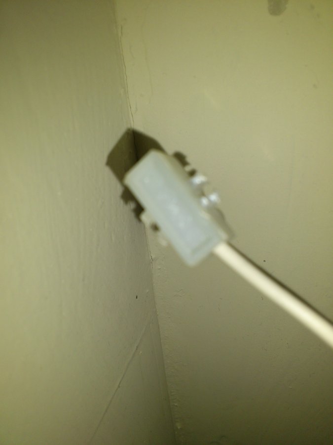

- There is a spare white wire that is not connected to anything!
It appears that the ZA5 has 5 wires, while the ZA6 has 6 wires. Would I be able to replace the existing valve with a ZA5?

Someone has probably fitted the 28mm valve to get a better flow, as the water passage on a 22mm valve are a good deal narrower.
If you're going to be fitting a completely new valve, you might like to consider using a Honeywell, but you'll need to remove the olives and old nuts from the pipes and use the Honeywell ones. The Drayton ZA6 is a straight swap and you could use the old nuts, although changing the olives anyway would be sensible.

yes but as already advised you will have to cut off the olives and swap the nuts to swap them
You say failed , in what way has it failed
The edge of the black plastic actuator that triggers the microswitch within the main actuator (hope that makes sense!) actually off broke years ago and I fixed it by drilling and glueing in some cut off panel pins to create a new edge.
This repair is still good, but another piece of plastic holding the actuator in place has now broken and it's now slightly wobbly. I don't believe it's worth repairing again as it is 19 years old and the plastic is degrading badly due to the heat in the airing cupboard, especially as the valve is now obsolete anyway.
